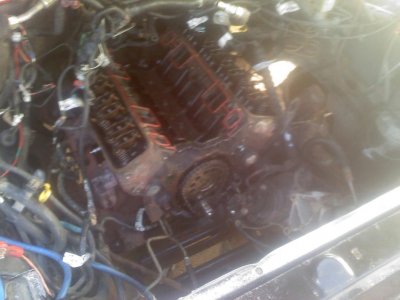

O i see. well heres a few pics of the old motor out and Ive got some prep work to do b4 the new motor gets here. [/ATTACH]

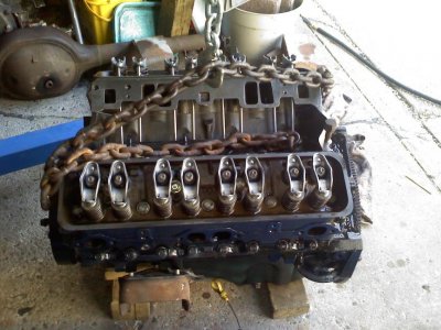

Just about got it done.....Heres a few pics. Gonna wrap it up tomorrow...
[/ATTACH]

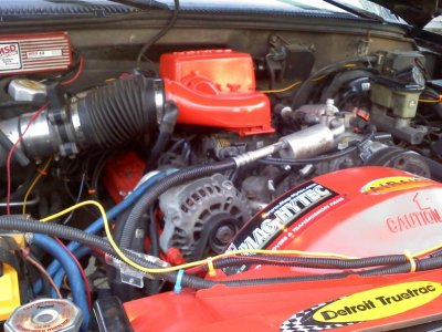

hey i see the msd box in the pic. did it help with mileage? i've got an old 6al sitting around but not sure if its really worth putting in the truck as no real performance need..just mileage.
also the mustang looks pretty comfy hanging out in the garage. 66? 289 or a 200?
congrats on the new engine. its like watching your loved one get an organ transplant and extended life.
Biggwaukegan
Biggwaukegan
Banned
Oct 21, 2009
225
Land of Abe
O the stang...Thats a 66 straight that has a 302 bored out 30 over. Now then, the MSD IS AWESOME. I wouldnt run the hoe without it. Helped with gas mileage and lower end torque/hp. Love the new motor.

Yea I would suggest going with the MSD. Its awesome. Heres a few pics of the finished deal. DAM NICE TO FINALLY HAVE THE BEAST BACK ON THE ROAD!!:pics-stfu:
