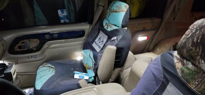

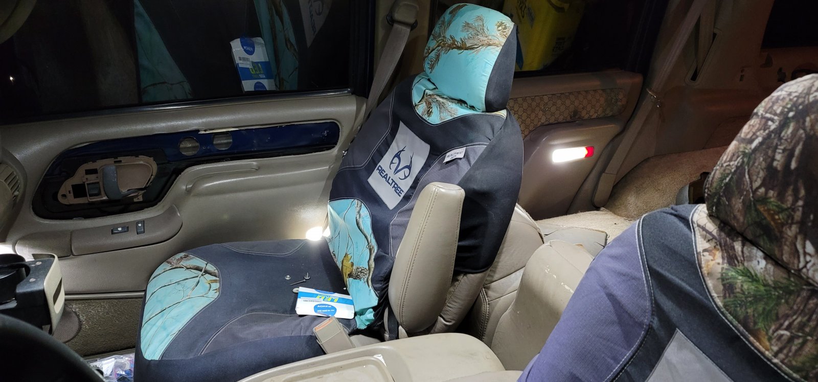

Not sure if this has been covered before. I know everyone tends to use 194 LED bulbs to replace their interior courtesy lights, but I replaced all of mine, including the doors, with 921 LED bulbs. Definitely larger, and much brighter. Had to trim some housings a little, but it worked! I will try to get a picture of them at night, but definitely much brighter than 194.

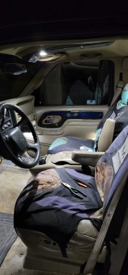

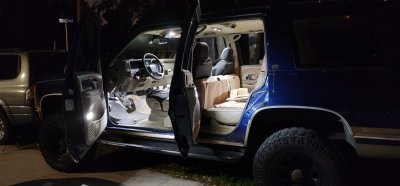

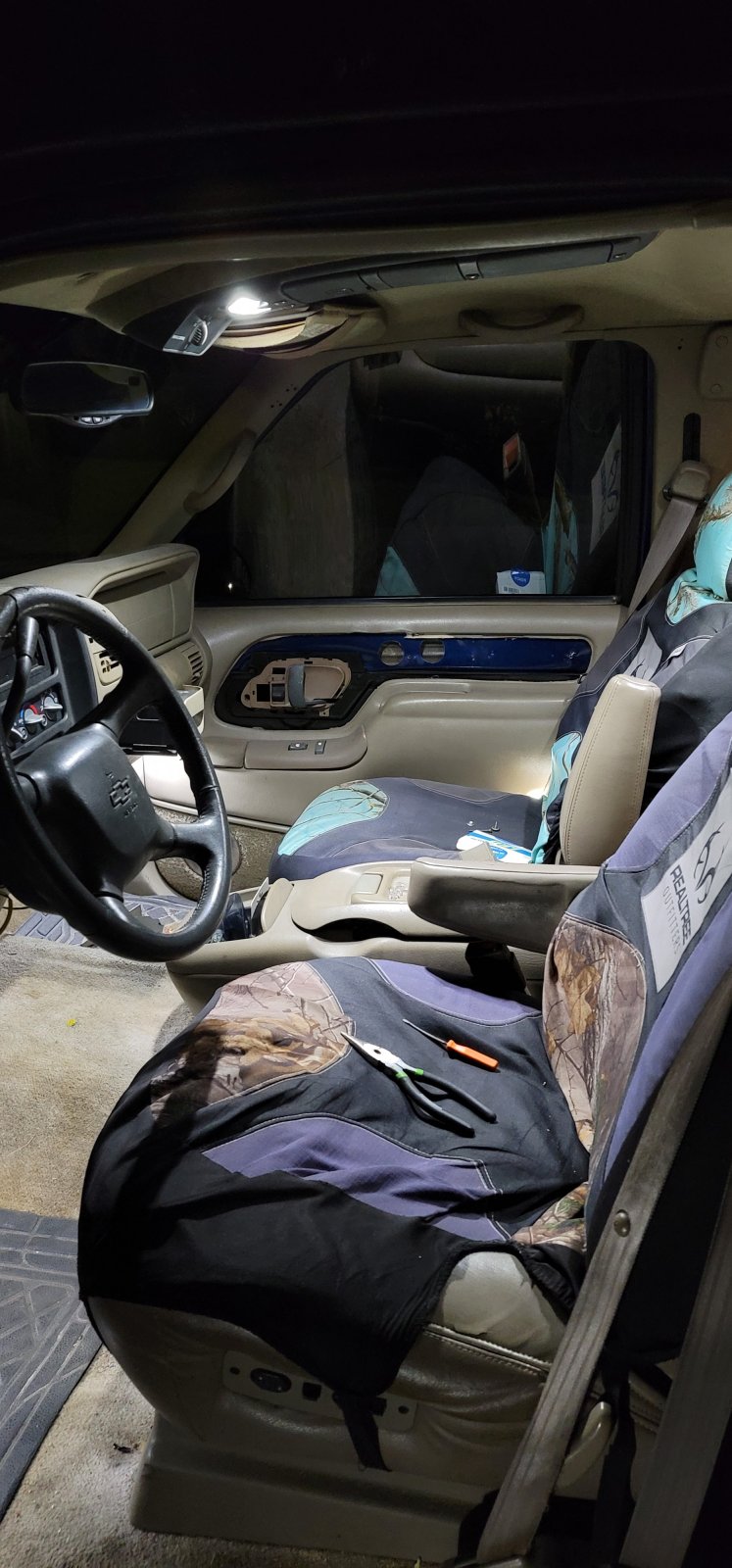

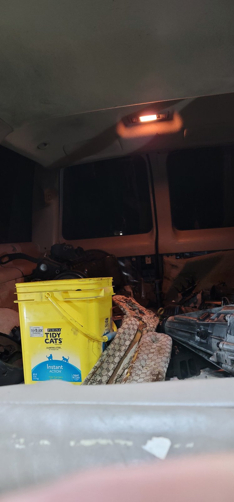

And I don't have the 578 lights in yet. You can see how it compares to the old incandescent in the back
20210424_211543.jpg 20210424_211555.jpg 20210424_211619.jpg 20210424_211636.jpg
