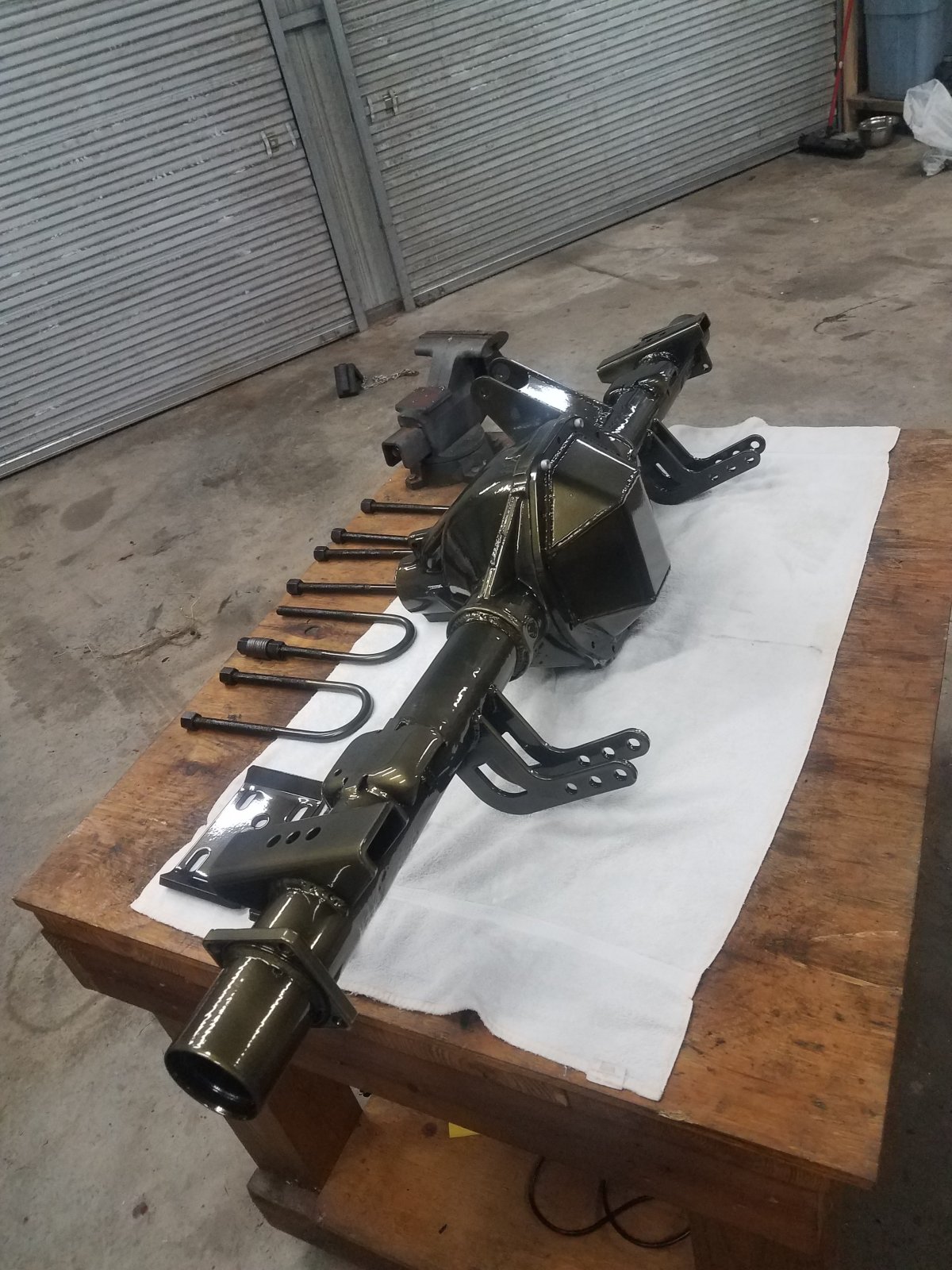

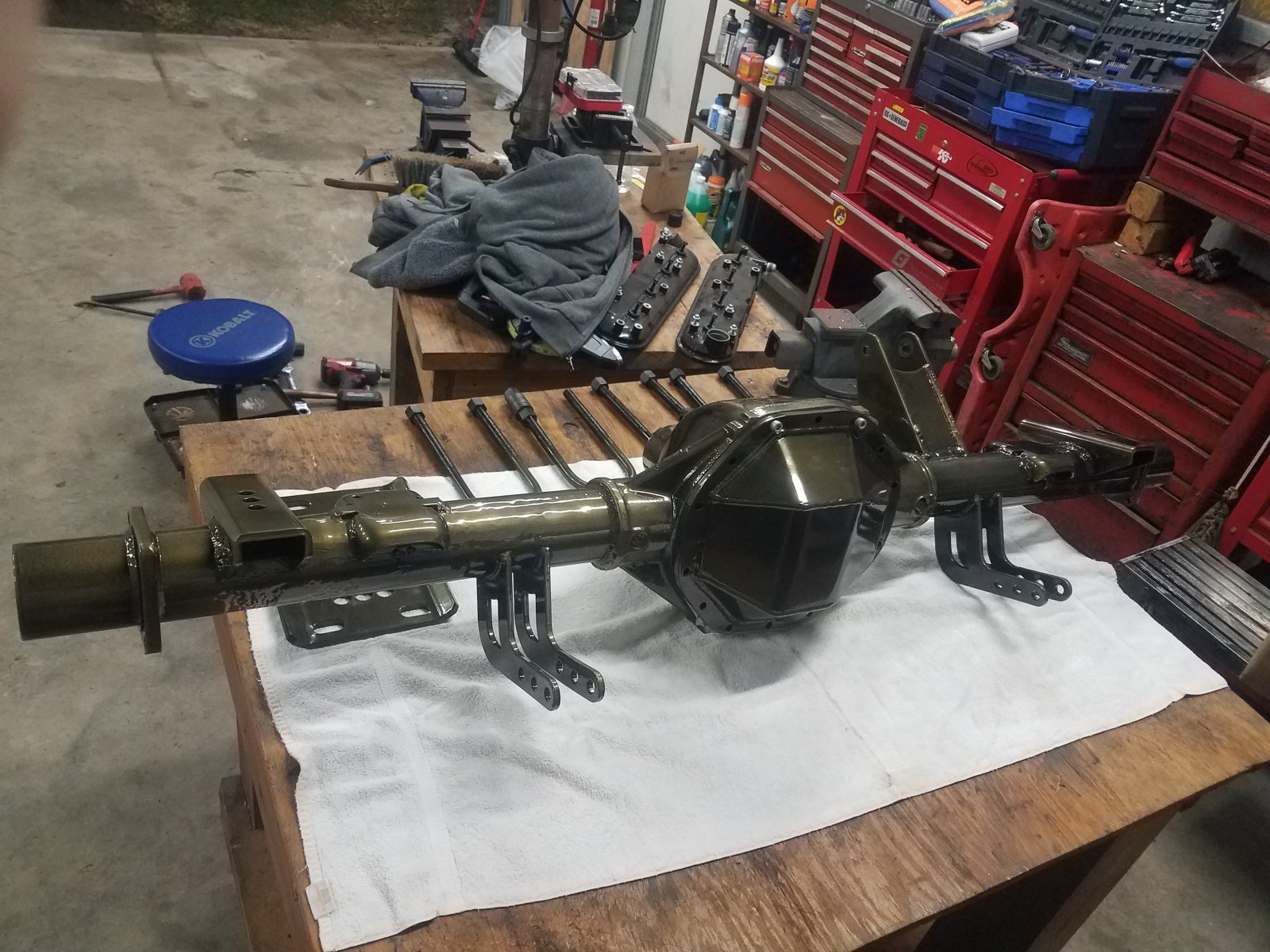

Yeah, that's $1,200 for just the housing not the axle shafts, ring and pinion, posi unit, 3rd member, brakes, parking brake, or all of the shock and spring mounts. Shit gets expensive quick! I'm about $700in on my 14b for my Silverado and it needs another $2kish.
View attachment 277038 View attachment 277039
It may be just the lighting but what color is that? It looks like an antique bronze?
And what's that under the sweatjacket? Maybe some secret nitrous plumbed high ram?
I don't remember what he calls that color, its goldish if you put light directly on it, Looks nearly black with no light and some weird antique bronze/gold the rest of the time, something different. IDK whats under the jacket that's an old pic, I can kinda make out a long tape measure and thats the handle sticking up but idk could be something secret ;)

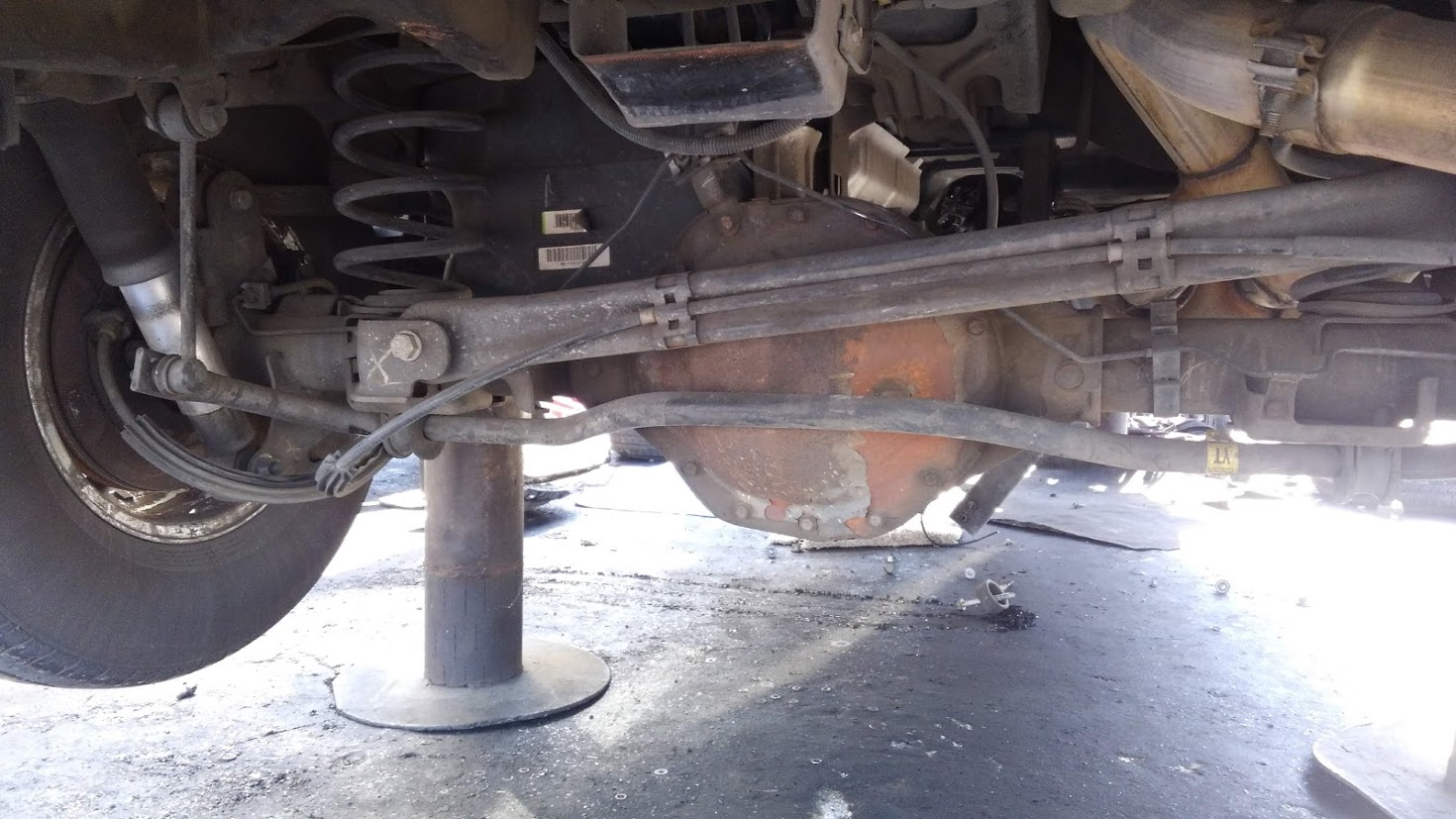

So I have now seen another GMT800 14 bolt rear axle. It's in another 2wd 6.0 Escalade that recently showed up in my local LKQ yard. This one is still complete as of yesterday. Tempting to grab it for future use when my 330k miles 10 bolt dies, maybe after the 6.0 swap. I did confirm it's the right 3.73 ratio that my Tahoe has (GT4), but no G80 in it. It would run me about $350 to get it out the gate there, don't need it now, but may in the future if/when the factory 10 bolt rear gives up the ghost. What's anyone have to say, keep the 10 bolt, or swap in the 14 bolt? Any downside to changing to a 14 bolt?
So I've now seen a 14 bolt rear axle in a 2005 and 2006 Escalade 2wd w/ 6.0. I wonder if GM used it in 2004-earlier 2wd Esky's as well...time will tell.

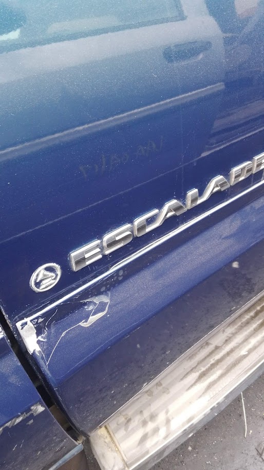

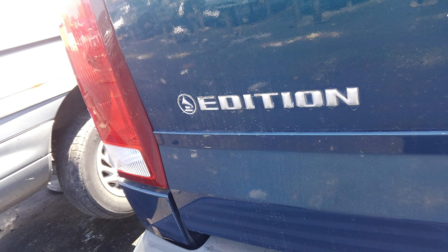

Anyone seen this special edition on a 2005 Escalade before? I searched and came up with nothing. The lettering is on the driver's side of the rear hatch and appears to be factory. I can't find anthing on it though. "RCA" Hi-Fi Edition???? LOL!
View attachment 276984 View attachment 276985 View attachment 276986
So kind of off topic in this thread, but this is the only place I posted this so here goes. I just stumbled onto what this special edition Escalade is. Apparently in 05-06 GM made a very limited run of a "Grammy edition" Escalade for self-important-celebrity use at the Grammys. One site I read, there was ~120 units produced that had a mesh grille, this badging, 20" wheels, and a few other doo dads. Anyway, I stumbled onto this tonight in a Craigslist ad for a "Grammy edition" Escalade. Searched that and sure enough came up with what it was. The one I saw is long gone now so there is at most only 119 "Grammy Edition" Escalades floating around out there. Figured I'd update in case anyone ever find this info and wonders about the badging.

So kind of off topic in this thread, but this is the only place I posted this so here goes. I just stumbled onto what this special edition Escalade is. Apparently in 05-06 GM made a very limited run of a "Grammy edition" Escalade for self-important-celebrity use at the Grammys. One site I read, there was ~120 units produced that had a mesh grille, this badging, 20" wheels, and a few other doo dads. Anyway, I stumbled onto this tonight in a Craigslist ad for a "Grammy edition" Escalade. Searched that and sure enough came up with what it was. The one I saw is long gone now so there is at most only 119 "Grammy Edition" Escalades floating around out there. Figured I'd update in case anyone ever find this info and wonders about the badging.View attachment 354981
Find it in a junkyard? Anymore pics? Find it in Ca? Never heard of it.
Yes that is where it turned up. Crazy that 1 of 120 would end up there but it's now 1 less as that thing is long gone, crushed already. I only have the 2 pictures of the emblems that I posted in this thread. Yes in an Anaheim, CA pick your part. I hadn't heard about this either, until I saw this C/L ad(not my ad) on Sunday where it mentioned Grammy edition. I searched from there and found more info on the web about it. https://orangecounty.craigslist.org/cto/d/whittier-2006-cadillac-escalade-esv/7404951050.html
