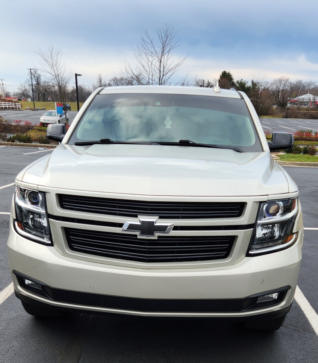

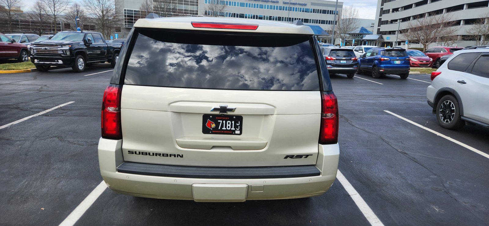

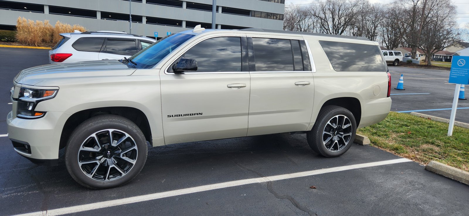

Man this thing has been a BLAST! I've honestly only floored it from a dead stop 5 times or so since I've had it back, and it makes me grin ear to ear each time. The torque that this 6.6 makes down low is just nuts!
The only real thing I'm looking to do differently is with the exhaust. During the swap, we decided to gut the stock 5.3 cats, as they didn't seem to be handling the new engine very well. Got the patented "rotten eggs" smell during the first drive after swap, so we gutted them which cleared that issue, but the raw fuel smell from the tailpipe is really becoming an aggravation to me.
I do have the cats/downpipes from the 6.6 that I believe I will have welded in this Spring. Likely just going to use the two upstream cats, and then maybe get 3 inch pipe custom ran after the cats to the back. Still unsure on a muffler, but possibly a flowmaster or magnaflow.
In the meantime, I have been doing an "RST conversion". At least that's what I'm calling it. Complete with color matched LTZ grill, black mirror caps, black badges, black D pillars, and RST rims. Also trimmed the lower valance to 3 inches. I will include pics below of the cosmetic mods. Be sure to like, comment, and subscribe to my YouTube channel. It's been VERY cold here, so I've been slow about posting new content lately but I'm looking to get back to it soon! Planning to get some full throttle runs for the next videos I'll be posting!
