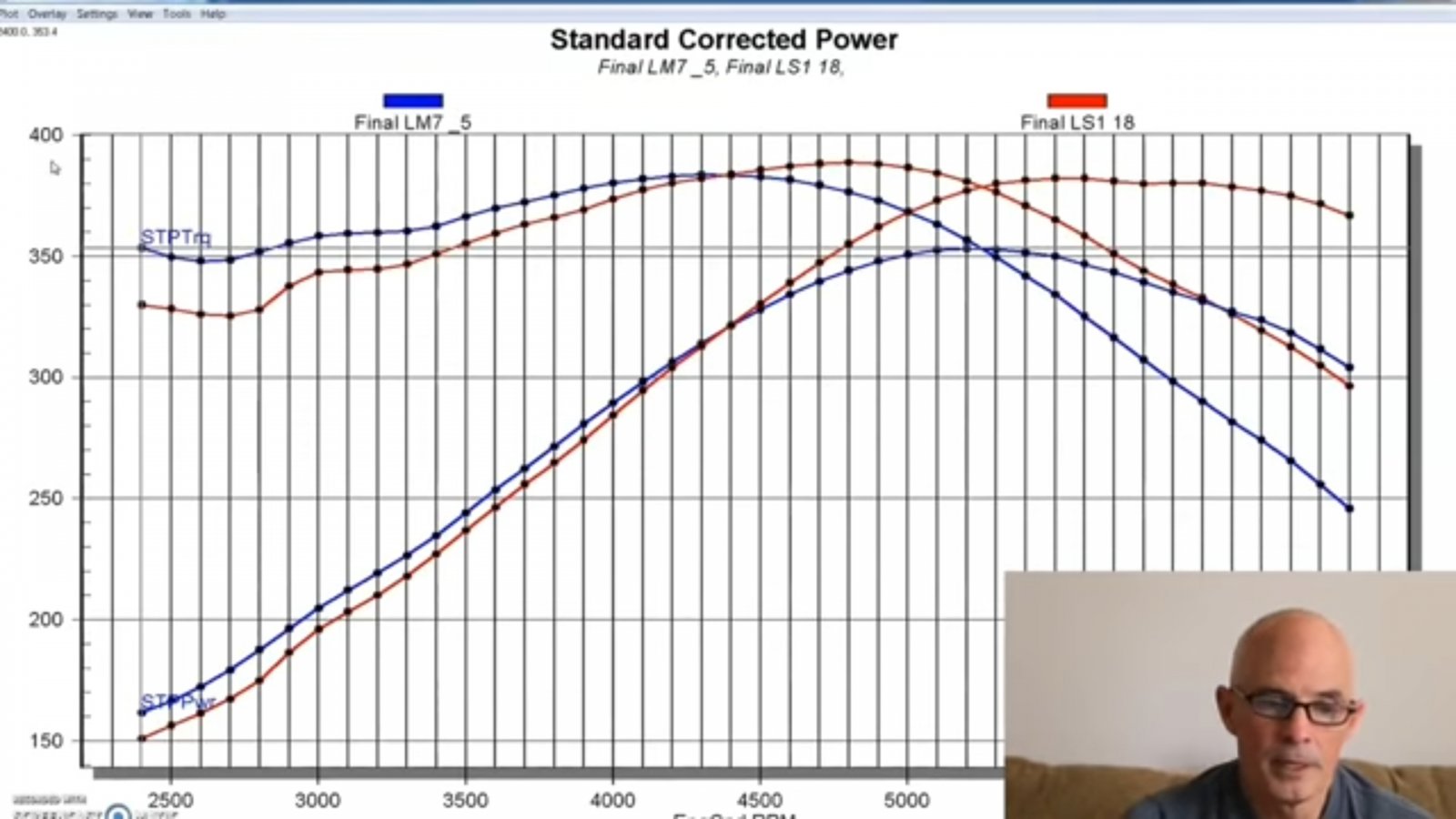

I will never understand why GM crippled the 01 and later LQ4 with the LS1 cam. It was designed for a light sports car.
I cant find back to back dyno charts of a 6.0 with the early and later cams, but i found tests of a 5.3 with both cams and the early cam in the 5.3 wiped the later cam all over the floor in the low end. Now it did give up about 20 hp up top, but it gained 20 to 25 at 2500 and stayed above the lq4 cam until 4400. Now a cam is going to do what a cam does, so a 6.0 should do the same but produce more tq. It will peter out a bit sooner in a 6.0 so maybe fall off about 4000, but still tq would be way up over the LS1/LQ4 cam. Im sure gms thought was let it rev to pull the hills at the expense of cruising mpg empty.
So, any better design cam would help in my opinion i think there is even a YouTube guy that did a Truck Norris mpg video and it did a bit better. In a 2500 i (personally) would do the BTR Torque cam since i wouldn't be racing a big 2500.
Anyway ill end my rant with a pic of the early vs late cam. Like i said it gave up 20ish hp but down in the "driving" area it gained tq.

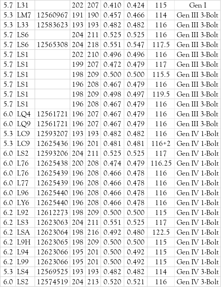

I'd guess duration at 50 intake then exhaust, then lift for intake and exhaust, then lobe separation? Looks like some stump puller cams but I suppose the head design and flow make up for it.
