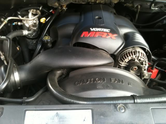

The LQ9 has Flat Top pistons, and a shit load more mid to top end power, 93 octane required. Take a Denali (lq4) and a Escalade (lq9) on a trip on the hwy, and see the difference. run them side by side.
Here is a pic, of my Vortec Max (LQ9).
Im about to put 6.2 heads on it with Fast & 102mm... thats what you do to make serious power. 525ish

Oh my god :Handshake: Thats a beautiful engine.
Yea I want what you got lol. And Hold up the 6.2 heads fit on the 6.0?

thanks, and Yes, I am putting 6.2 L92 heads on my 6.0 VMax. New Fast intake, 102mm Throttle Body, and a custom grind cam. It can be done, its just not a simple head swap.
