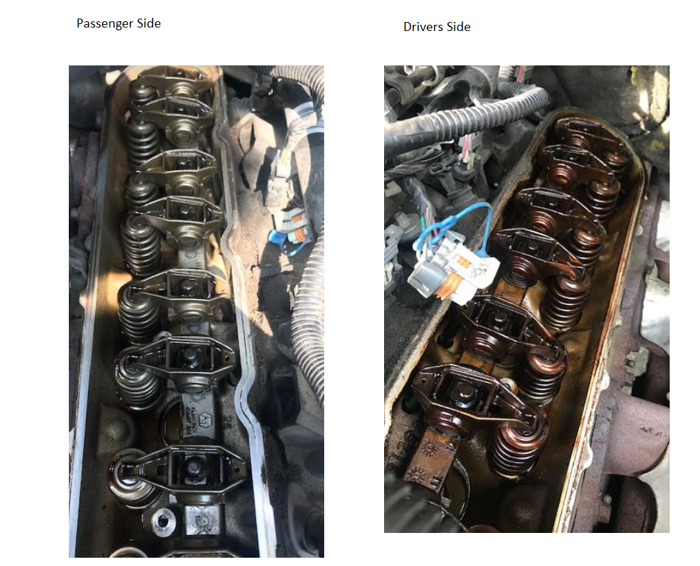

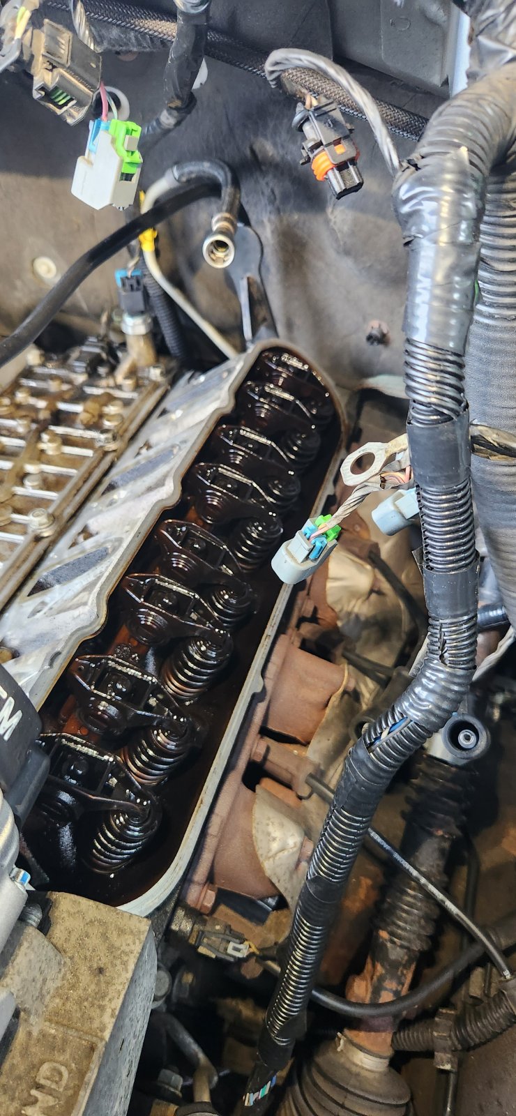

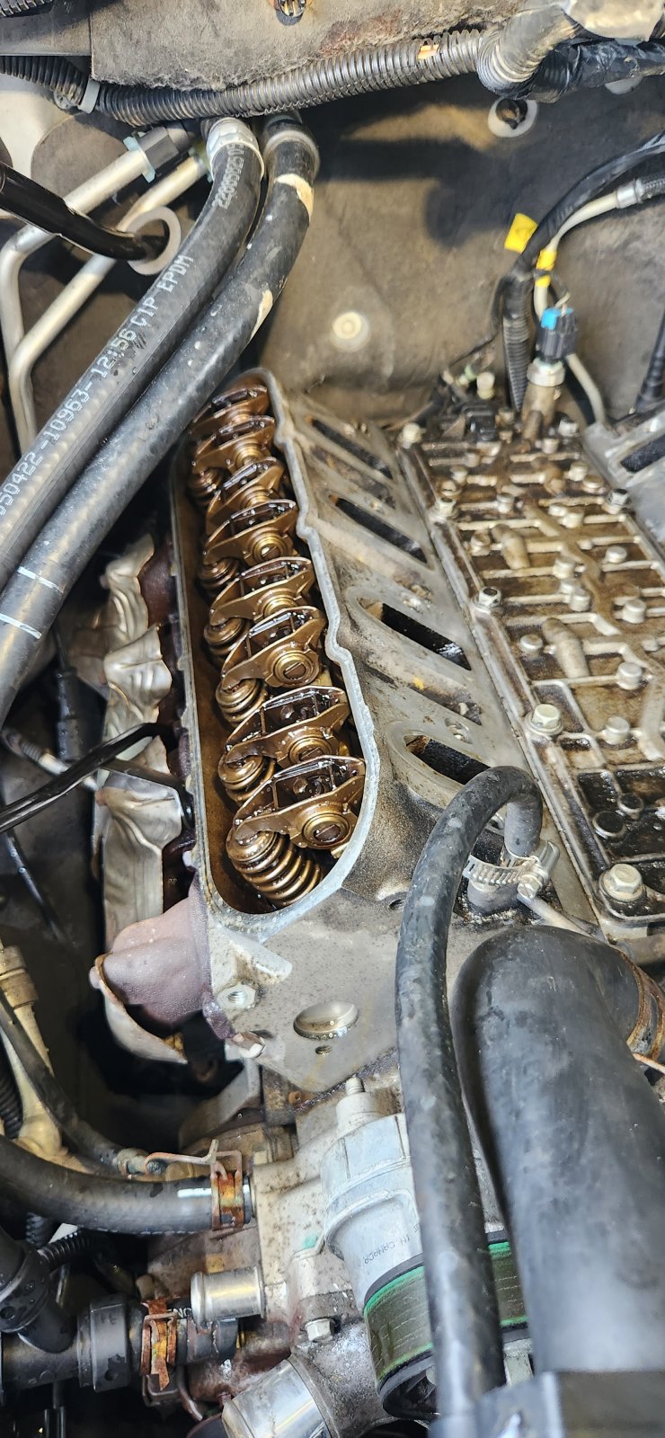

5.3L cylinder head. Which side should be normal?
wazzabie
Jul 27, 2024
11
13
Does this look like a problem? Should I be concerned?
rockola1971
Dec 29, 2016
2,862
4,085
Indiana (formerly IL)
How long have you own the vehicle? Looks like one head has been replaced. The darker one looks like that head has at least 200k miles.
Look at the stamping on each head to see if they match.
Im going to have to totally agree here. I have never seen an LS engine with considerable amount of miles on it not having matching patina on the valvetrain and tops of the cylinder heads. Drivers side head looks to have a fair amount of miles on it and from what I can see in the pic completely normal visually. That Passenger side head looks like it was either replaced or pulled, cleaned, likely rebuilt within the last 50k or less.
unknown history till 44k miles. total miles is 190k

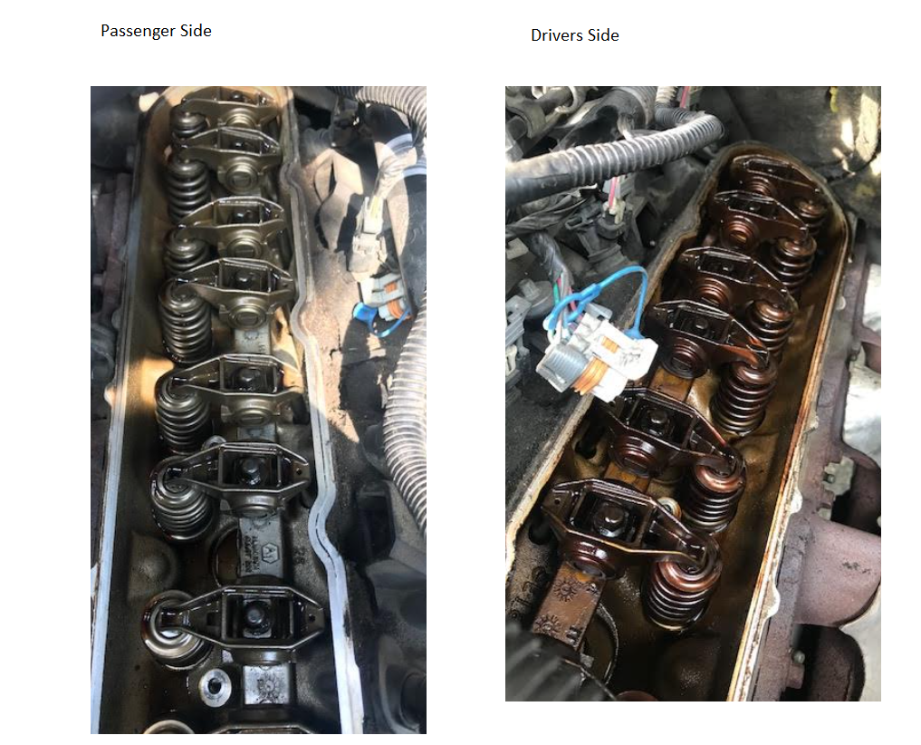

There has been a coolant leak with this motor. Engine oil analysis report says coolant in motor oil.
ivin74
05 NBS Nali
Aug 3, 2014
2,420
2,557
Htown, Texas

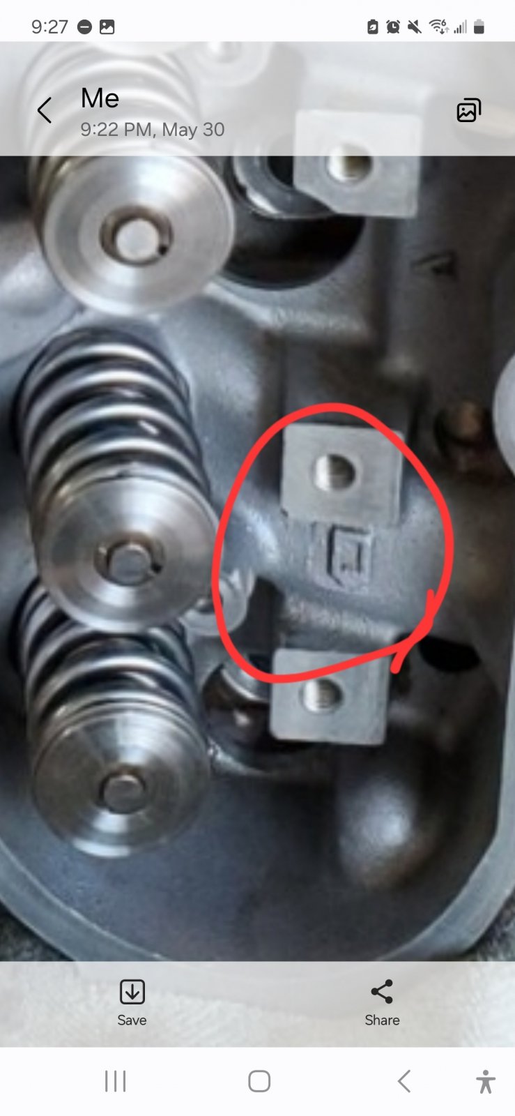

You might have the troubled 706 heads on that suv. To identify those heads look for the stamping shown on the pictures below.

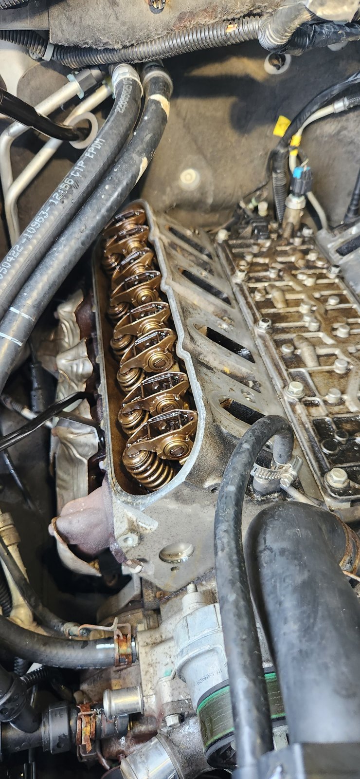

This was my first though when I saw your first post. The left side is just too clean. Before going any further with taking things apart, do a coolant pressure test with the valve covers off. This should show where the water is getting in.
If it were a small crack, you would see the cleaned portion just beside the crack. Mine was a very slow leak, and the area cleaned was small, just around the bolt head:
Was there any other unusual wear according to the report? I suspect the coolant leak is/was quite big, and may have caused other internal damage.
High levels of lead and copper. So the coolant is eating the lower bearings. This is just in trace amounts. I caught it early. I read the orange coolant does not become milk like shake in engine oil. I'm using high millage synthetic engine oil. The motor oil looks normal when I drain it. I did a coolant pressure check with the valve covers off and did not see any water near the head bolts pool.

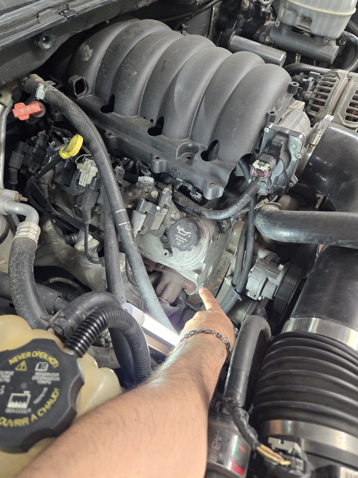

No noise and good oil pressure and no warning lights....should be good. Yes, pcv on left side. Please do not reuse the old v/c seals.
No noise, good oil pressure, no overheating, engine has never over heated on me, I do get low coolant light. The low coolant light is intermittent. The coolant usually stays about 1in below the reservoir line until I add more coolant. I replaced the coolant reservoir thinking it was the low coolant indicator switch but that was not an issue.
You need to pressure test the cooling system. If you have rear heat, you need to check the heater hose tees at the p/s firewall area and see if damp/wet and also check the weep hole on the water pump. Check the tank seals on the radiator.
