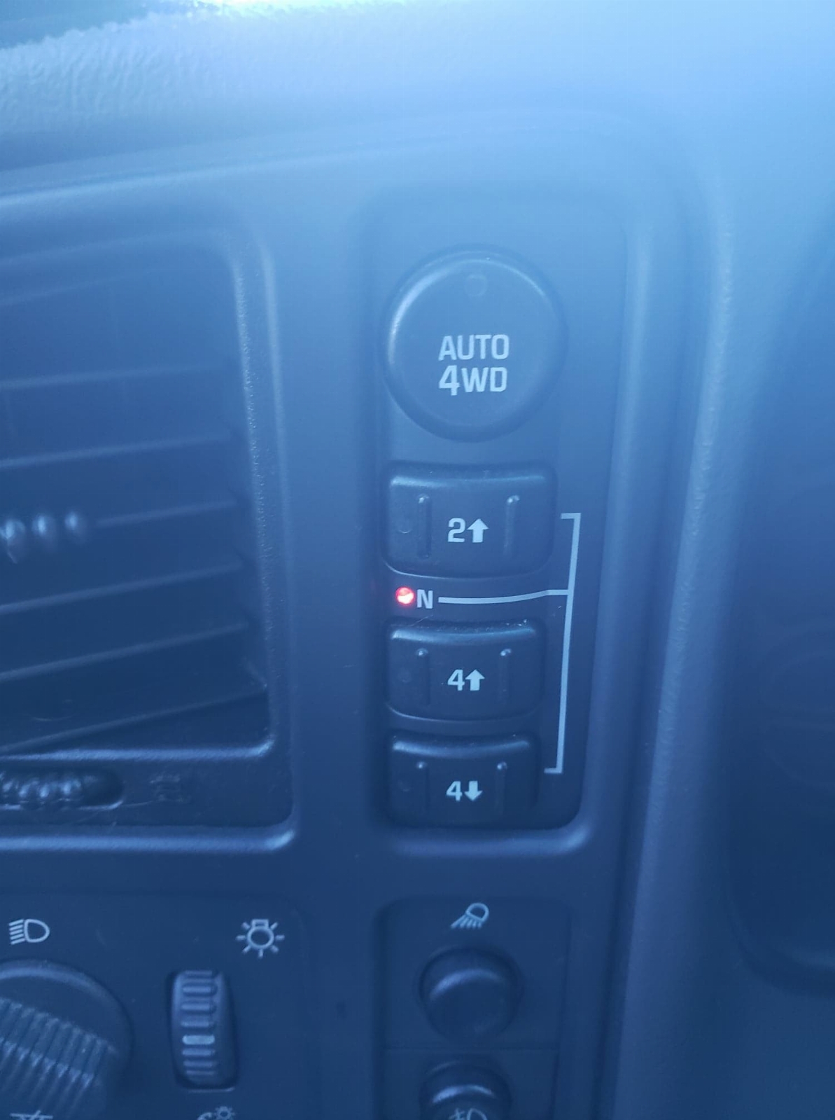

Symptom is that on startup the 4x4 selector is in N. Selecting any other mode, that modes light will flash for a few, then go back to N.
So I had this issue once before. Found a thread that mentioned that sometimes the communication fails to reach the modulator on startup. Fix was to remove the fuse momentarily. Of course this worked. Tho recently this is happening much more often, and without the need to pull the fuse, as by the time I start up next it is good to go.
My question is, is a component about to fail, and if so, what do I replace?

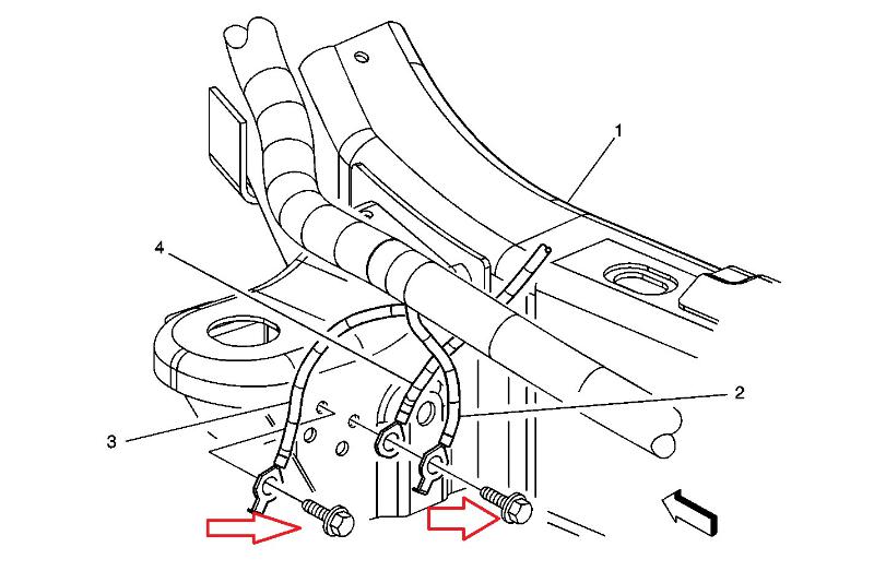

@******.sixty9 you should also clean and retighten the two grounds that are outside of the frame on the body, under where the driver's feet would be. They're right behind the LF wheel. One of those is for the 4x4, but I'm not sure if it's only for the front diff actuator or helps ground other parts of the system. One of mine had stripped threads in the body so I put a bolt and nut on that one.

I definitely need to check those grounds. Might explain the whining noise I always get from my speakers.
