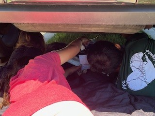

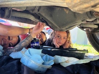

I ended up ordering the AC Delco fluids for all 3 holes and was able to knock this out Sunday, even got the wife and daughters under there to "help" haha.
Since my street is a slight hill I pulled it up on paver strips I have on the side yard that I did for the boat a few years ago and laid a blanket over the grass. My youngest thought it was a dam picnic and started bring dolls outside to hangout under the yukon haha.
The job overall is super easy and if the spare tire wasnt there the overall time would have been cut in half since it blocks straight access to the top half of the rear diff cover and I couldnt use my impact to zap off the bolts. I kept the tire there instead of dropping it since I figured the time to drop it out of the way would take just as long as the time to just work around it.
I think I was into it ~$200 for all the fluids, gasket and bottle pump tool plus I got my girls active turning the wrenches so Id say a win for me
