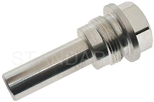

i prob wouldnt rely on pvc to maintain that fork pushed out, front diff would prob get hot enough to deform the pvc after a bit of driving.
someone sells an aluminum plug that threads in and keeps the front axle disconnect pushed
cant seem to find where i picked it up from but its this:

That thing is $100. The whole actuator is plastic and it's held up for........ who knows how long. It's pretty thin plastic too. This PVC will outlast that actuator plastic.

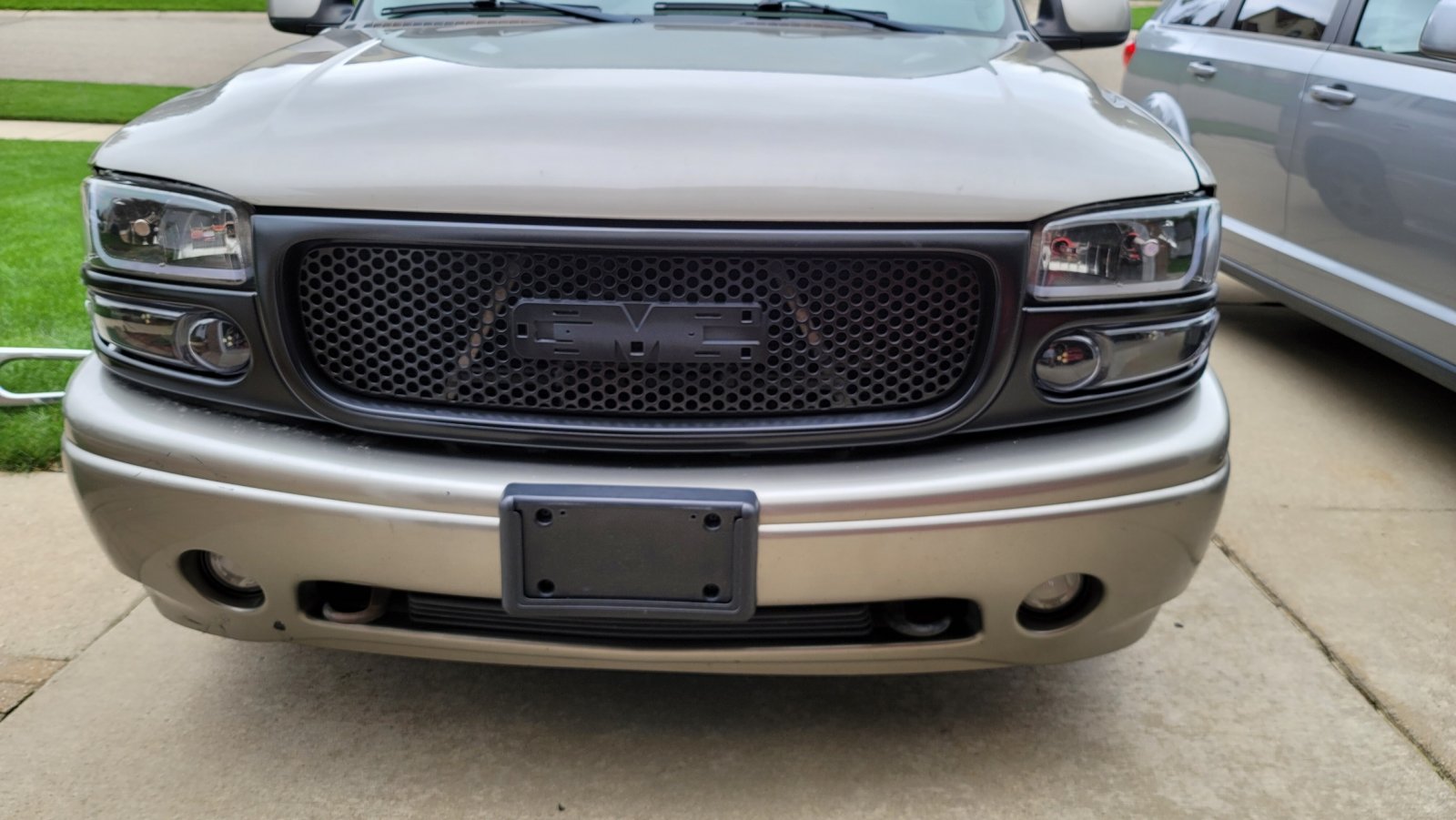

Hey OP on a side note can you post a better pic of your grille? I've been toying with the idea of blacking mine out but want to see how it looks. We have the same body color and headlights.
I didn't have the front emblem done yet, this is the only front view of it I can find. I plastidipped an old one from the junk yard to see if I'd like it or not. I have another one that I'm planning a bit of a hybrid project for. I'm going to keep the grille from the denali, but remove the honeycomb and insert the horizontal black bars from a 00-02 Yukon/Sierra. I never liked the honeycomb, but like the rest of the grille, and parking lights. So I'll see how that goes. I'll also be painting that one black, not plastidip.
