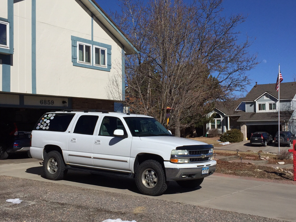

I've been running 33's (285/75/16s) for over 2 years on Z71 springs and aftermarket torsion keys. I also have Bilstein 5100's all around and extended swaybar links in the front.
As you can see from the picture, the 33's don't really fill up the wheel wells. I'm pretty sure I could run 35's if I wanted to:

That is actually the stance I am looking for, maybe a hair taller. In a perfect world I would do 3.5" up front but it seems like these trucks don't like that. I do think a 6" lift with the drop xmember is a bit much for my goals and would cause more damage than good. I plan on doing a lot of trails with this truck, no major rock crawling but I know the closer to stock you keep things the longer they will last. No problems with the droop stop at your height? Thanks @Martinjmpr
Looks perfect to me!
