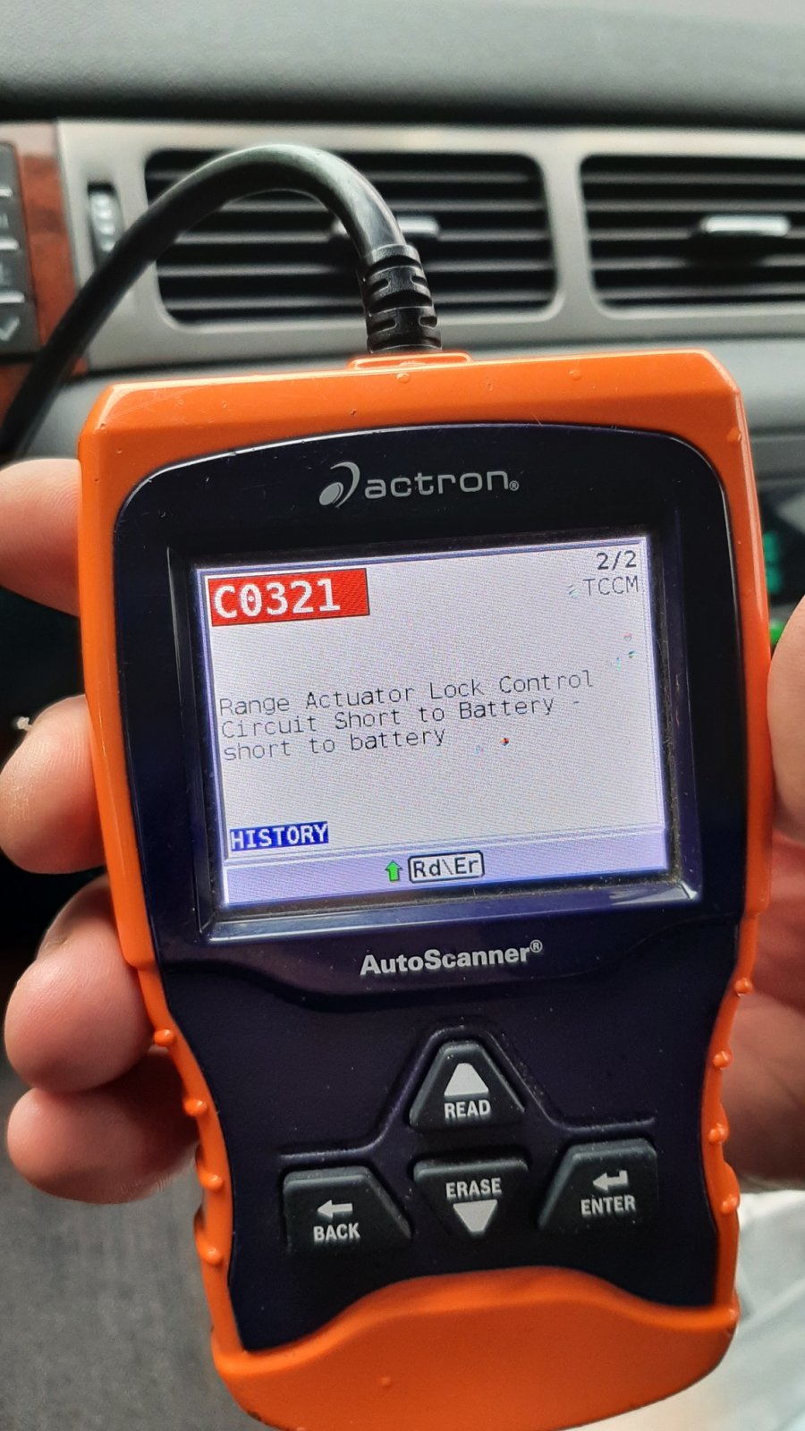

Boston, MA (MetroWest)
Here’s a pic of the code readout

I can't see how it would be related. Did you see any C7xx DTC's in the scan?
Looking through my shop manual, parts wise, it looks like about $400 in parts is your maximum exposure for fixing the C0321 (likely quite a bit less, if you bought parts online and got the correct replacement part right the first time). Labor is anyone's guess if you don't plan to do it yourself. My shop manual calls for the use of the Tech 2 (factory style scan tool) through some of the decision matrix diagnosis to command certain functions if it is a part failure (likely) and not a wiring failure. You can get quite a ways through the diagnosis matrix with just a VOM.
Looking at my shop manual my guess is it would be a part (encoder motor, TCCM, etc.) versus a wiring problem. If you know anyone close to you with a Tech 2 (or clone) or an advanced scan tool that can mimic the functions of the Tech 2, it shouldn't take long at all to diagnose the problem and fix it.

As @wsteele mentions, the use of a Tech 2 is highly recommended.
My '04 had an issue with no fault codes, but when 4HI was selected -- and indicated on the switch -- the truck would act as if it was in AUTO. I monitored the "commanded" and "actual" states of the mode selection, and the Tech 2 showed me that although commanded to 4HI it switched to AUTO. Mine (2004) ended up being the encoder motor.
