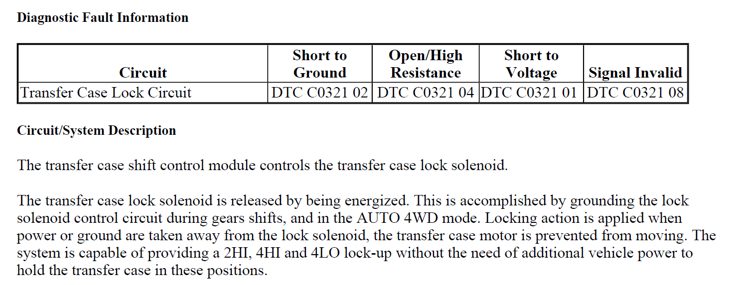

From the shop manual:

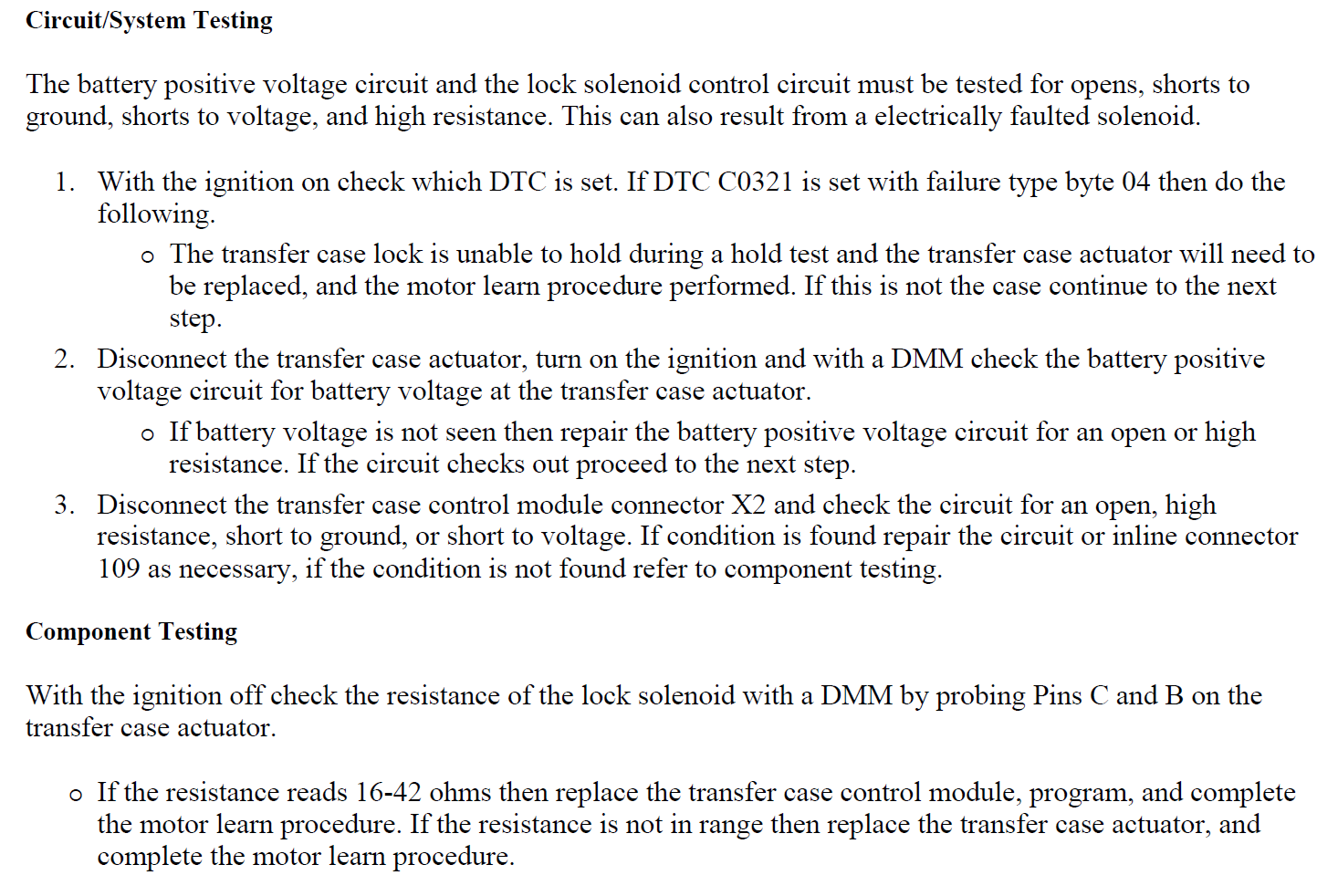

It is likely the transfer case actuator (tc motor) or the transfer case control module. Both require some work with the Tech 2 or other high end scan tool (like a Snap On) to complete the repair.
If you are near anyone listed in the Tech 2 owners sticky above, maybe reach out and see if they may be able to help with that side of things, then just do the diagnostics listed in @swathdiver’s post above.
if you still don’t know what to do, take it to a dealer, it will be a fairly expensive repair, like $500-$1200, depending on if it is the motor or the tccm.

The code points to the actuator on the transfer case ("lock circuit" is the clue), not the front diff actuator, and @swathdiver posted a diag path in post #2. Not to be rude but if you're not willing to, or capable of, following that simple procedure with a DVOM then it's time to fire up the parts cannon or take it to a reputable shop to have diagnosed and possibly repaired.
