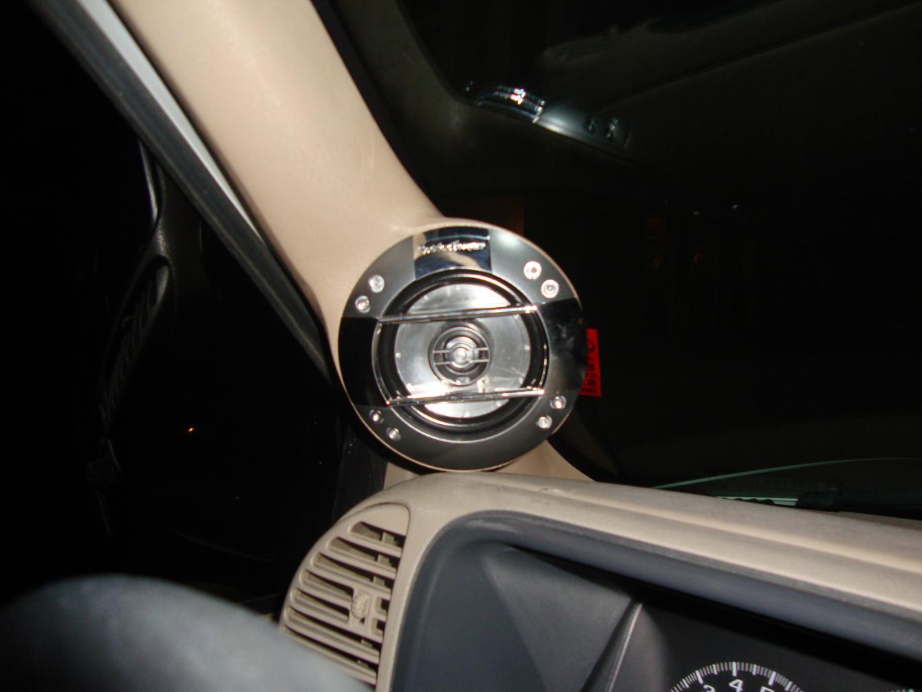

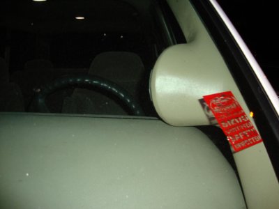

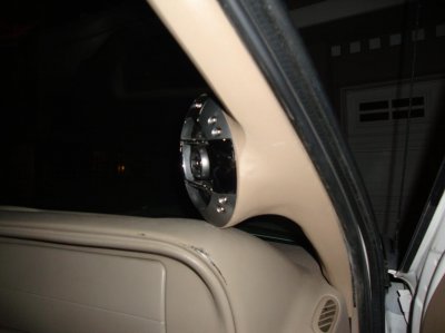

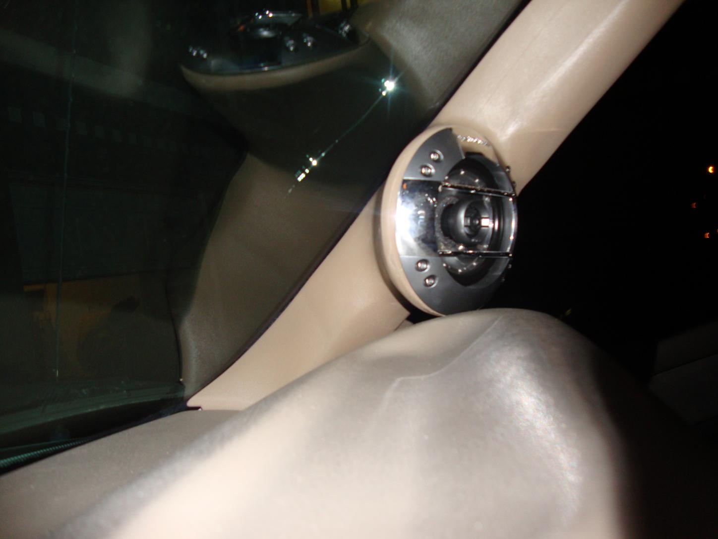

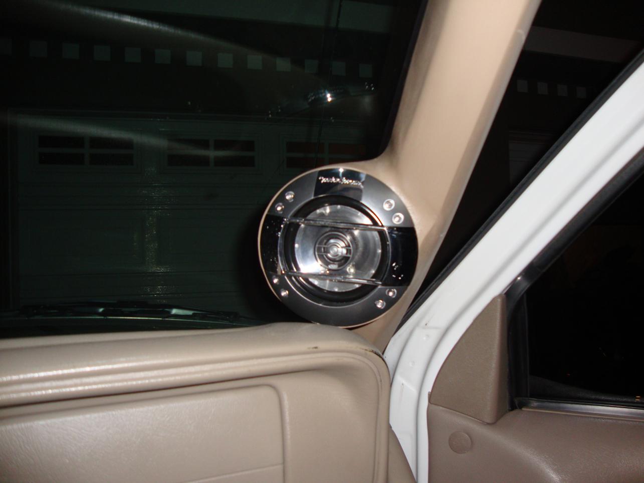

My very first fiberglass work 4" 2way rockford, power series

Daaaaaaammmmnnnnn..! Most people just put tweeters... But cot damn... still not 2 shabby 4 ur 1st attempt... 2 thumbs up..!

Those look damn good man! I just hope they dont catch the sun and blind the shit out of you...
50,933
19,327
Nice work but IMO really messes up the flow of the rest of the interior. I would not like it if it was in my ride :shrug:

DAM!!! Nice work!!! Hope like hell you got a good alarm on your ride. Thats just begging "Break in. I got nice system in here!"

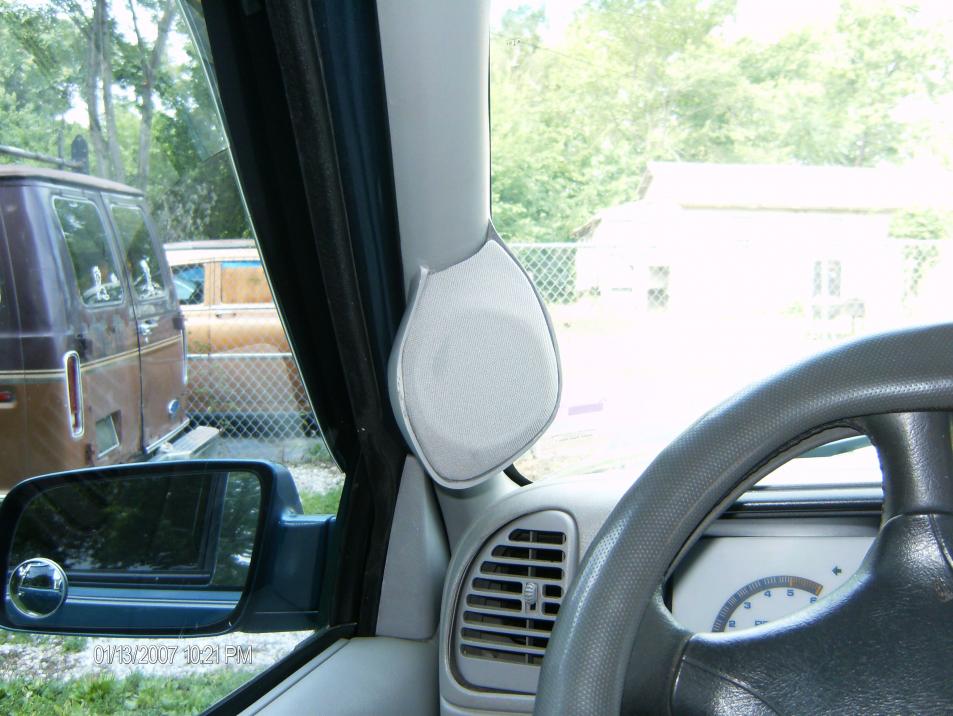

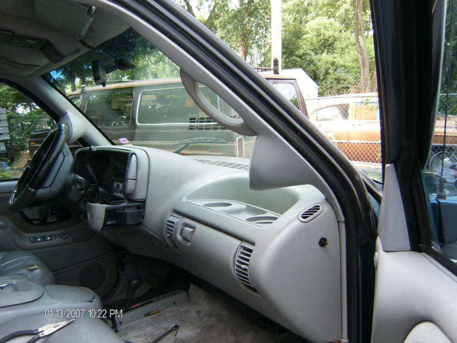

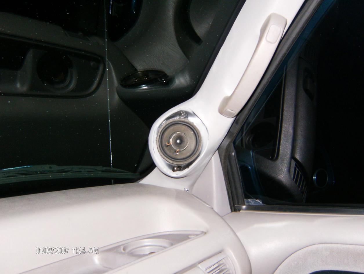

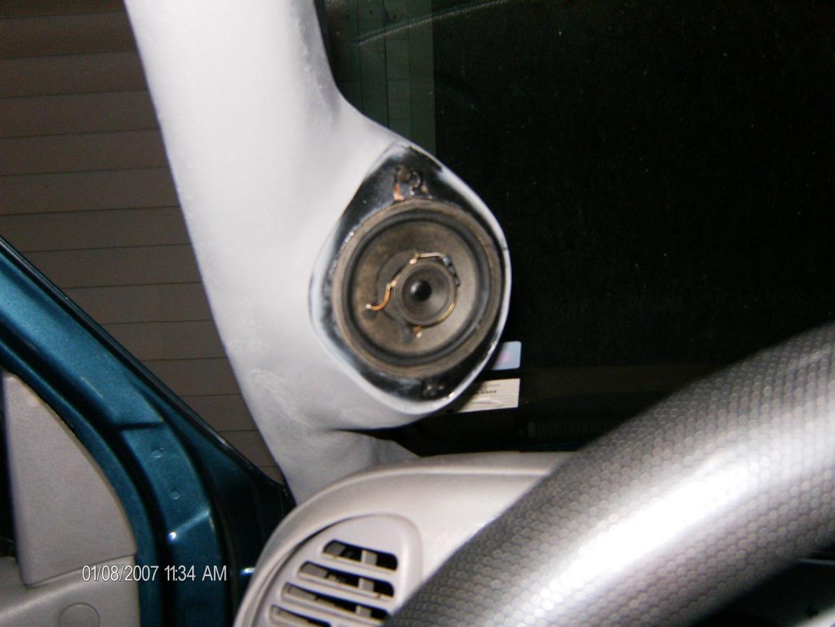

nice first time glassing!! but are they obstucting your view? i did a
a set for my 3 1/2 in the pillards and they was to much in the
windshield my wife wouldn't the truck so i made another pair more
inline with the pillard like the pillard gauges.

this pic is the first ones i did and the middle pic also
then the other two is the sec pair.

Not really my style, I think I would rather have a tweeter in the pillar. But, very nice glass work, and they do look good.

They don't get in my way too much because their down in the corner of the windshield. It was actually very easy to make. I used the speaker grill to make a ring out of a thin piece of wood and used some skinny pencil shape wood to hold it in place.then I went on YouTube and watched how other people laid down their resin and fiberglass mat.Then put a layer of bondo on top to make it thicker and stronger.The longest part was the sanding it just takes time to get it smooth and get it to flow as much as possible. Then primer and a coat of SEM texture coating and the final color. It took me about a week only getting to work on it like two hours a day after work.
