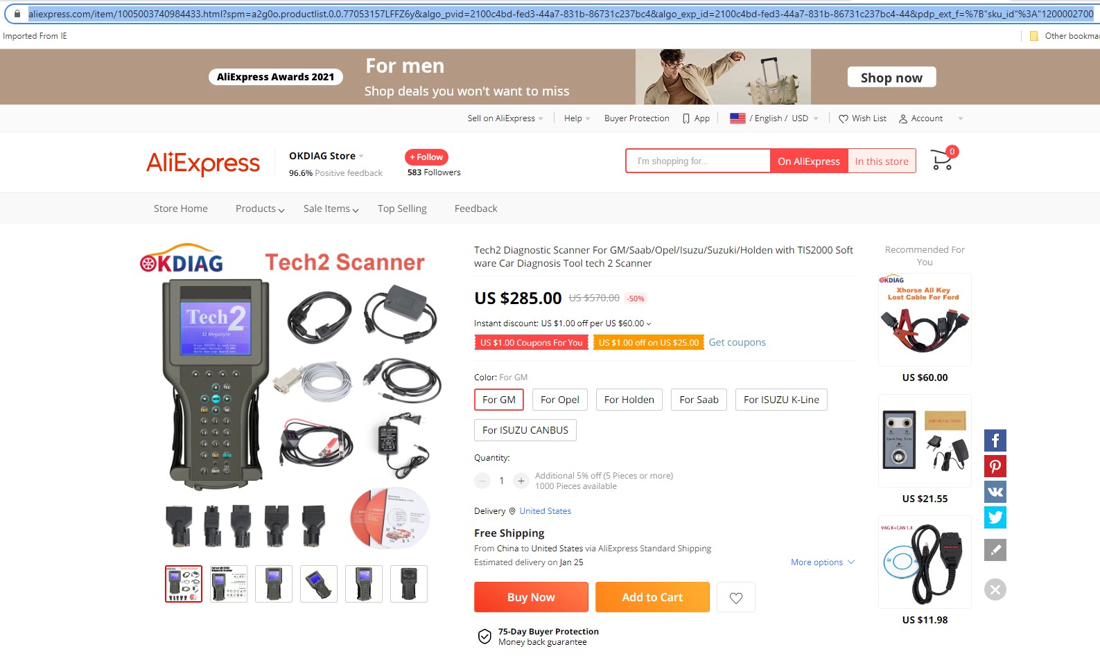

Is that just a code reader or a bi-directional scan tool? If you're going to keep this, get a bi-directional scan tool like the Tech-2 if you don't already have one.

If you are committed to keeping this truck, purchase a Tech 2 for ~$300. It can read codes, reset codes, and most important, it will help you troubleshoot specific codes, bringing you to a much faster resolution, without just throwing parts at the truck, hoping for a solution.
For example, I got a backup assist code, and using the Tech 2, it told me that it was a backup sensor issue (the 4 sensors on the rear bumper, versus the control module), AND it told me which of the 4 sensors was the one needing to be replaced.
this. i want a tech 2! i can’t seem to find one in that price range. i have been looking for quite some time.
it’s not necessarily that i am committed to investing in/keeping this truck so much as i am committed to investing in expanding my knowledge & my skills in this field. its also worth mentioning that i am a strictly GM owners in regards to my choice of vehicle so the tech 2 wouldn’t be a bad investment either way.
yeah, i’m totally aware of what it is capable of doing & i really really want one - i just maybe am not looking in the right places. or is the tech2win the same thing? i read some varying opinions on the tool. unless you have any direction in which you can direct me - id be forever grateful. it would help me big time in locating alot of these headache codes.

Here you go: https://www.aliexpress.com/item/100...pdp_pi=-1;285.0;-1;-1@0;USD;search-mainSearch
Make sure that you purchase one specific to GM, and not some other car/truck brand.
