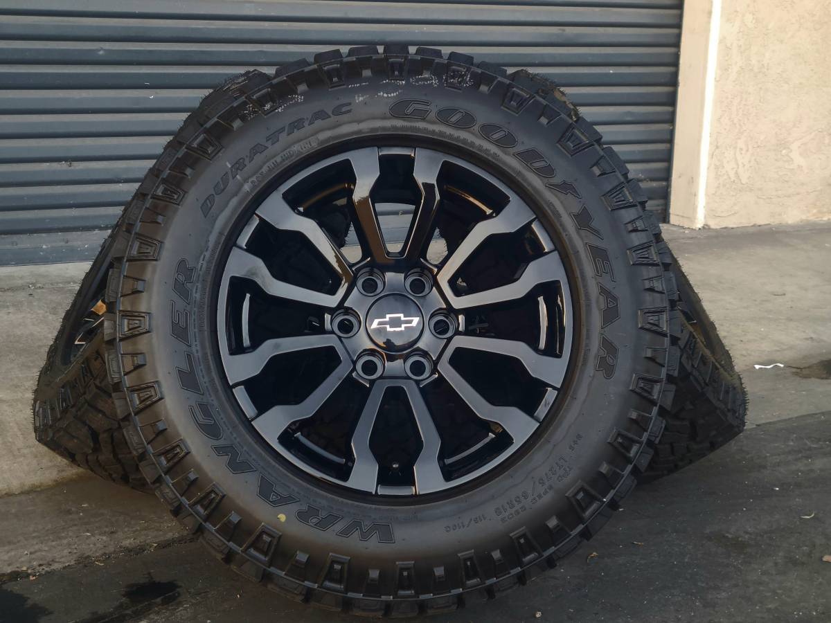

Well damn. I just read that and my happy feelings left. I just got 2015 LTZ wheels and had them powder coated. Did you have the 5 or 6 spoke? And where wouldn’t it clear?
Answered my own questions by going back and reading their the entire thread. Bummer. NNBS upgrade it is then. For now.
