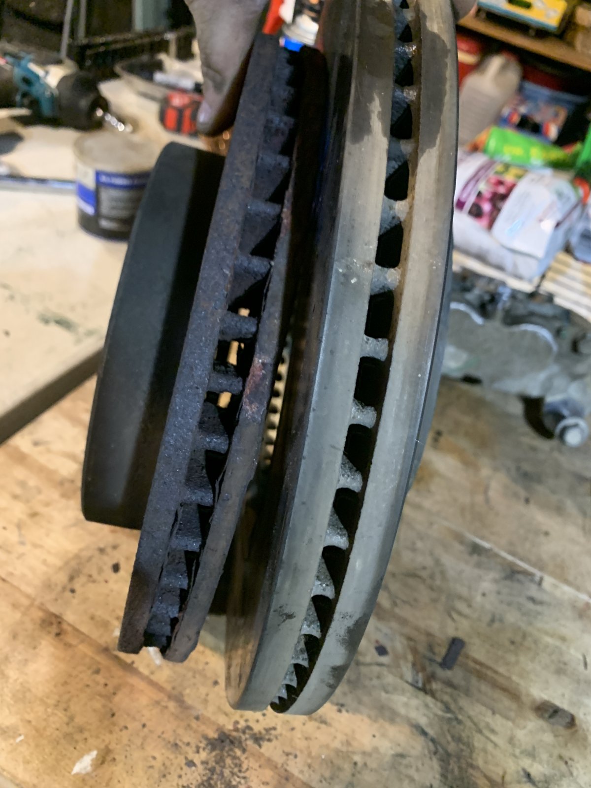

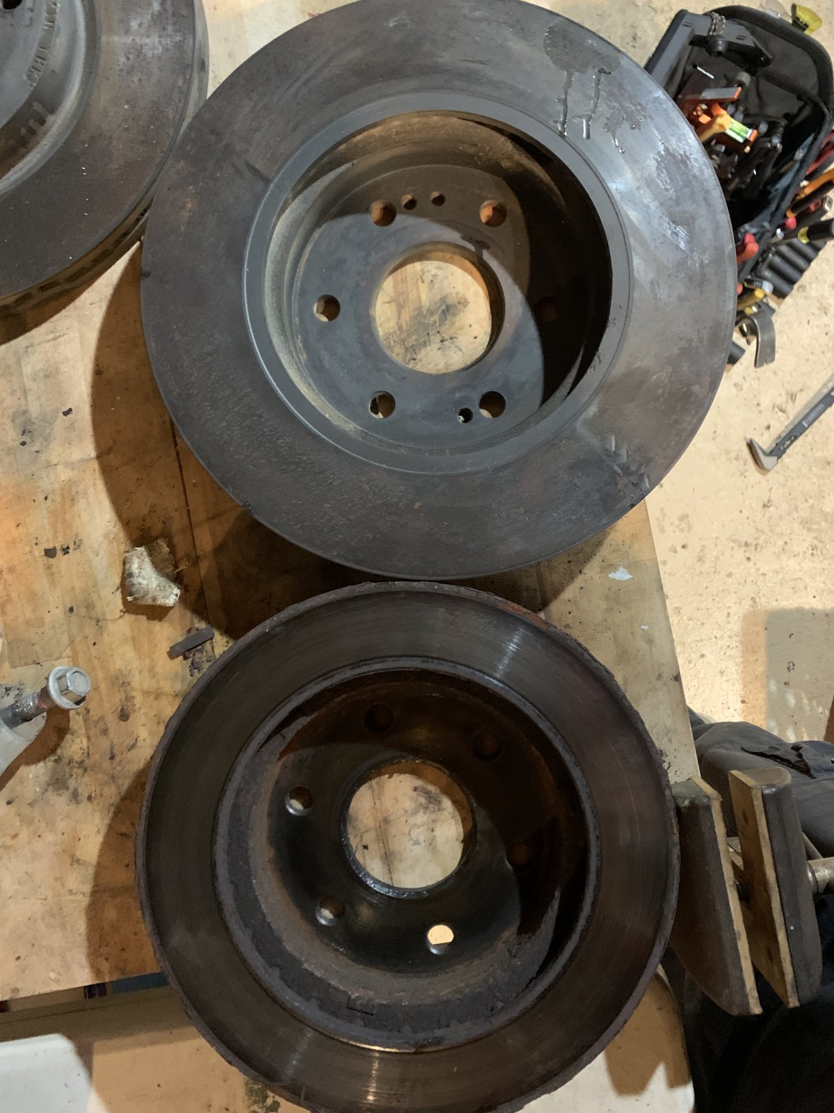

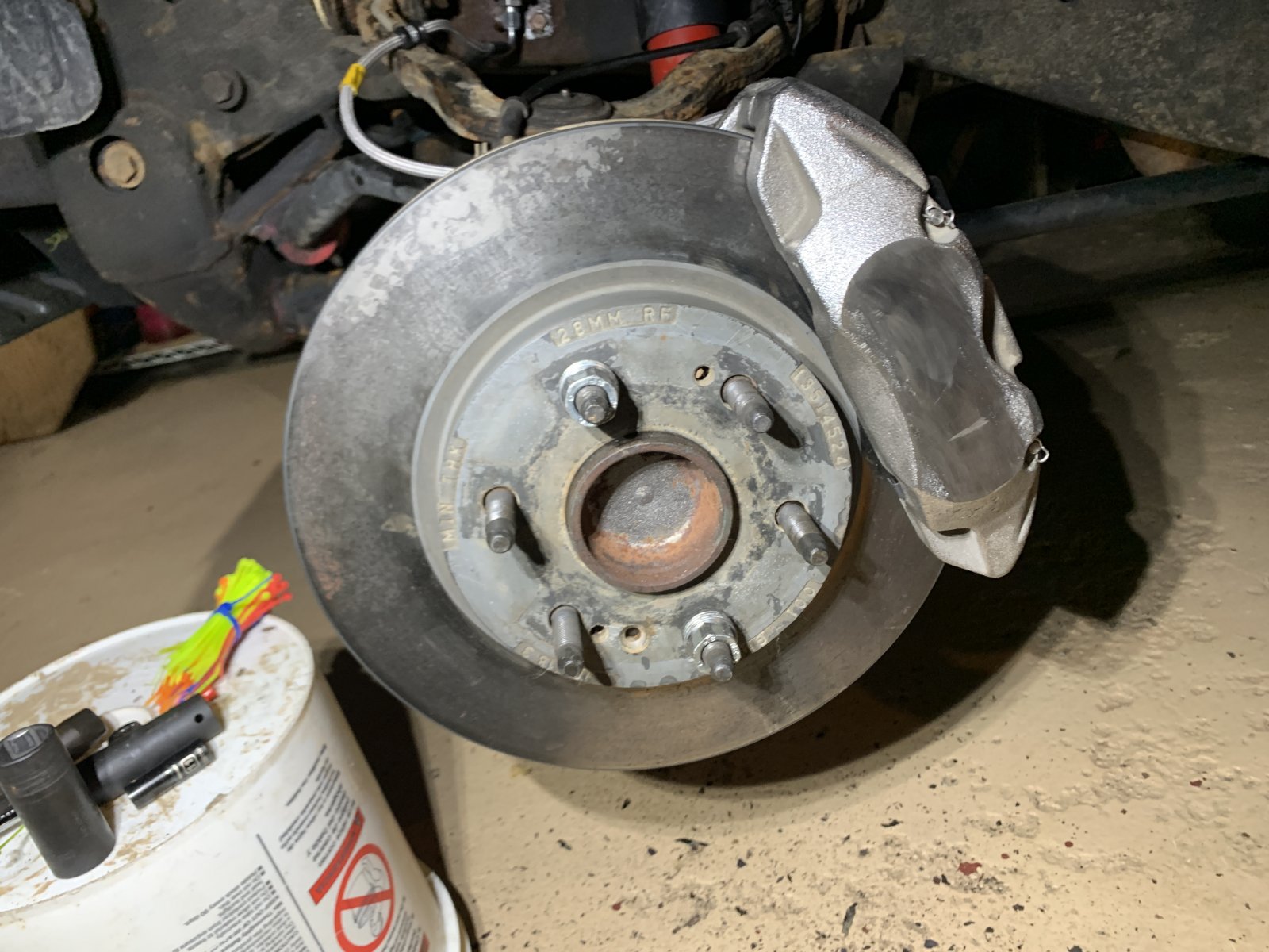

Started my big brake upgrade today. I knew I was in for trouble but I like challenges. So I have the stock 17" Z71 rims.
In order to get the calipers to fit I had to grind down the ridge on the top of the calipers, as some others have done, and I needed a 1/4" wheel spacer.
I don't care for wheel spacers but 1/4" is minimal so I felt OK with that. I used a single 2mm stainless washer to space the caliper. The caliper is not centered on the rotors, it is offset a little back, which allowed me to get away with using a single 1/4" wheel spacer.
My brain went a little crazy at first, but after some thought I do not think the caliper being slightly off-center matters. The pistons on the calipers will extends and contact the rotors, and the pressure on both sides should be equal.

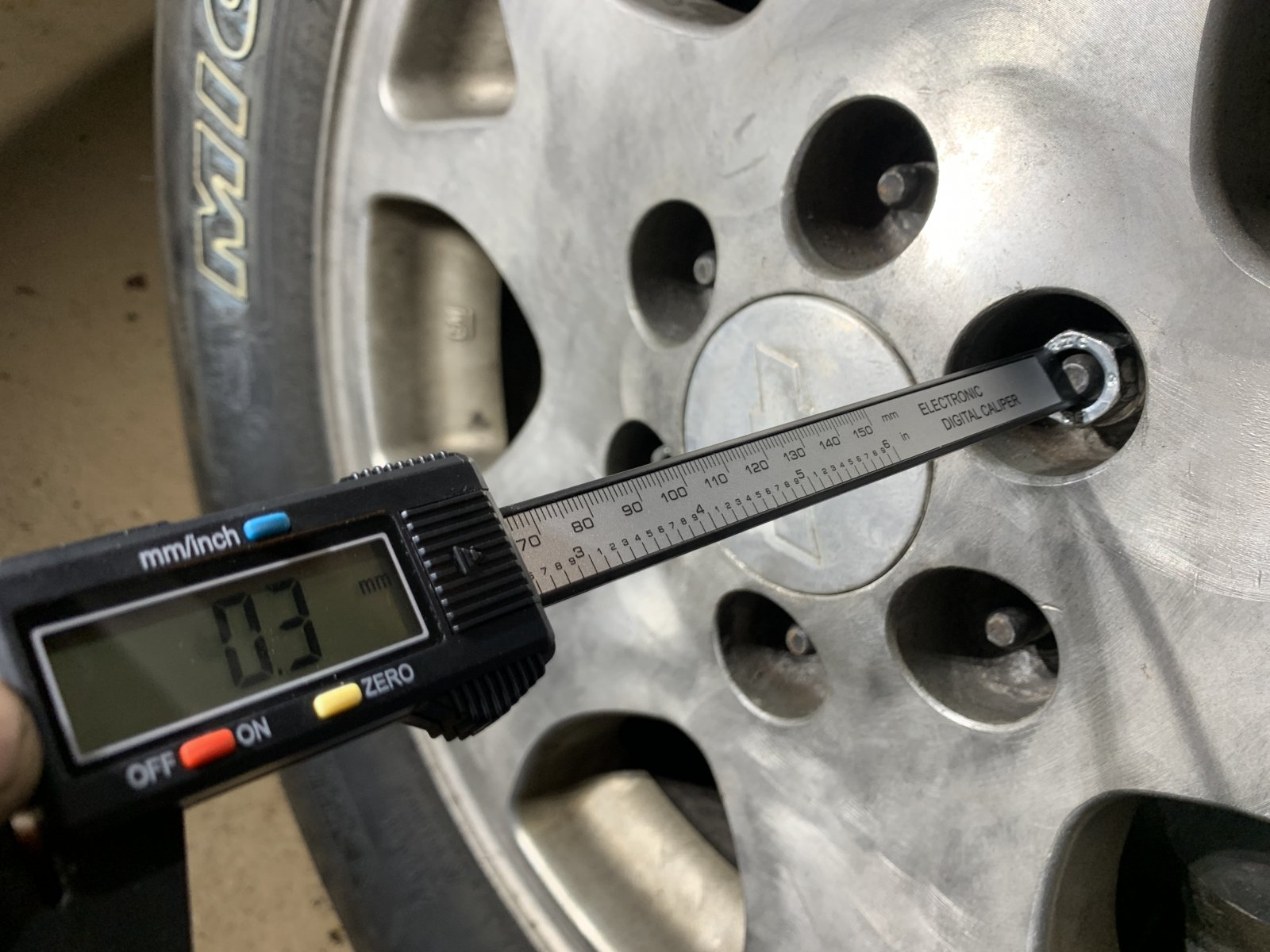

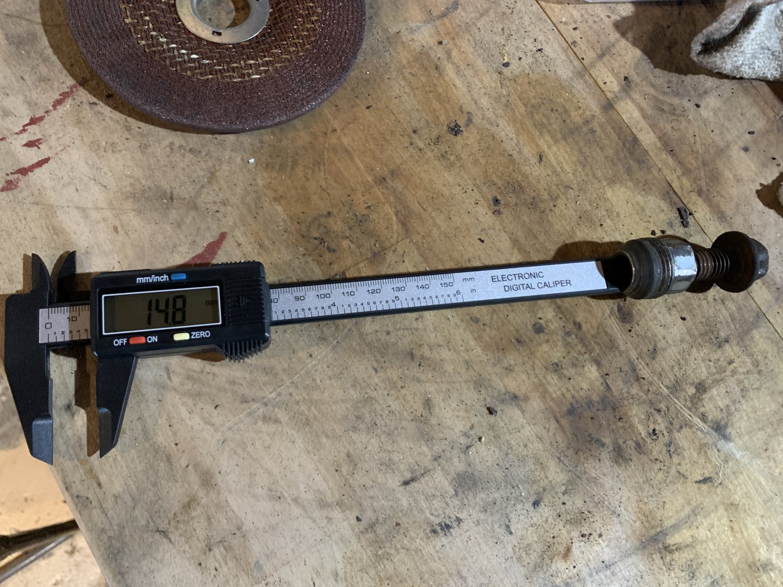

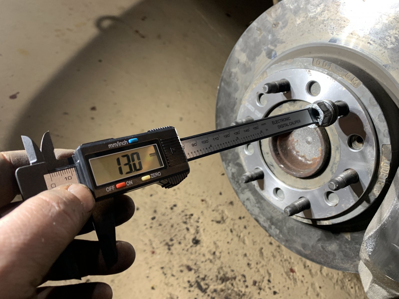

I was worried about the wheel spacer, so I took some measurements with a digital caliper and I calculate that with a 1/4" wheel spacer I lost 15% of my thread engagement.
Isn't there a considerable amount of threaded shank protruding from the lug nut when it's tightened? Or, do you lose that plus whatever amount to equal that 15% reduction in thread engagement?

There is an unthreaded section at the top of the lug, as well as an unthreaded section at the top of the nut, so I had to device a method to accurately get these measurements.
Here is what I did. First I put the nut on the stud to where the first thread would catch. Then I measured the depth of the hole.
The first place I can catch a thread is at 13mm.
Then I put the tire on and measured again.
The depth at .3mm means I have 12.7mm of thread engagement.
Now I need to know what the full thread depth is, so I put a bolt in reverse to where it would catch a thread and measured again from the bottom.
14.8mm is the total thread depth of the nut.
12.7/14.8 = .858 or about ~%85.
