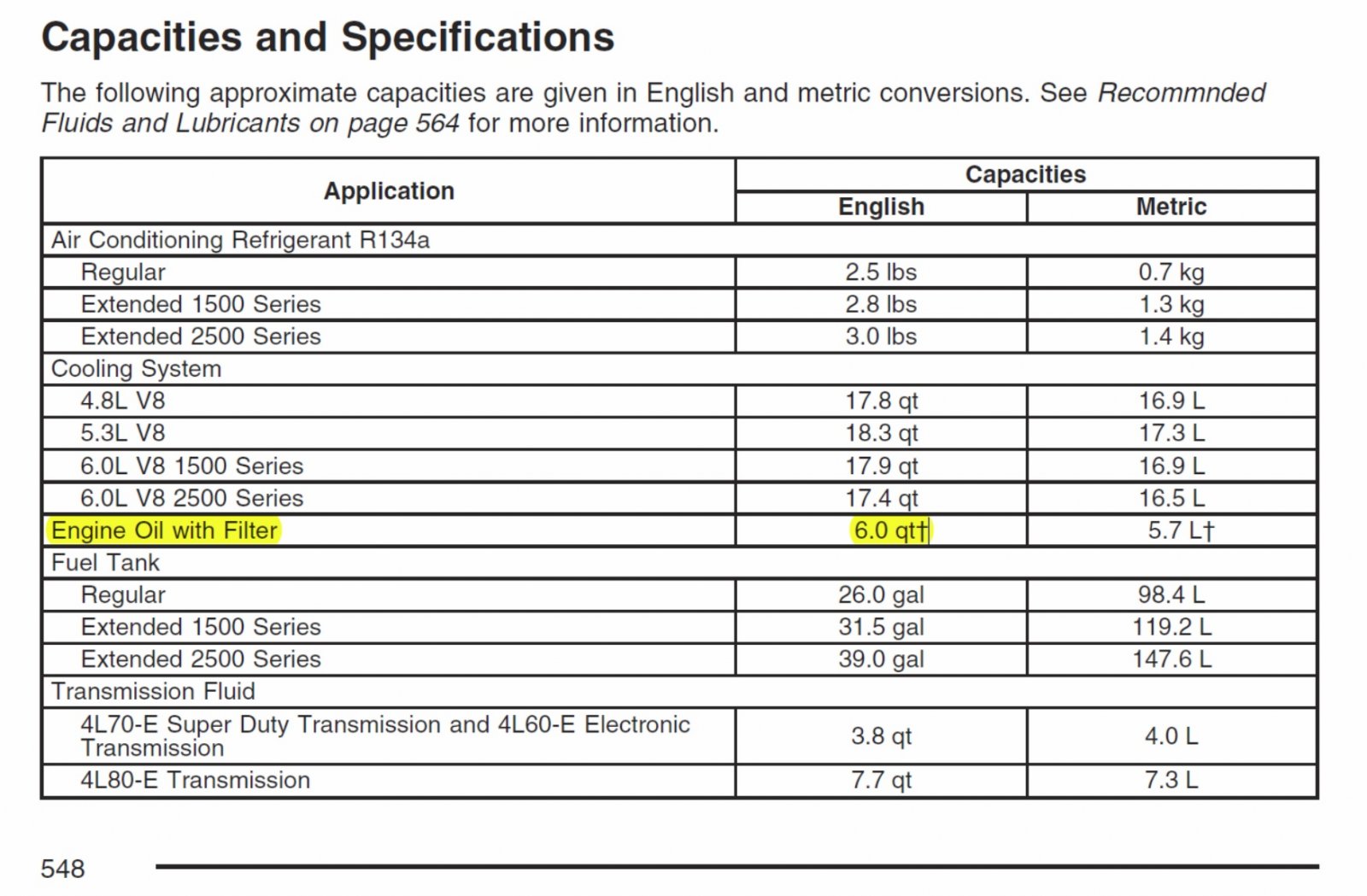

I say you put in one quart too many.

Bill/intheburbs, the DIC said: 25% remaining ? so this wasn't an extended oil change interval. Some folks here on TYE may remember what a mess this vehicle was when I bought it 17 mths. Read my threads from Oct-Dec of 2018. I resurrected it from the dead. Its a great vehicle now.
Our 07 Yukon 6.2L Denali holds 7 qts because 1 yr ago I added a remote spin-on engine oil bypass filtration system, Amsoil EaBP90, that holds an additional qt of oil. I posted a thread here on TYE back when I did it.
