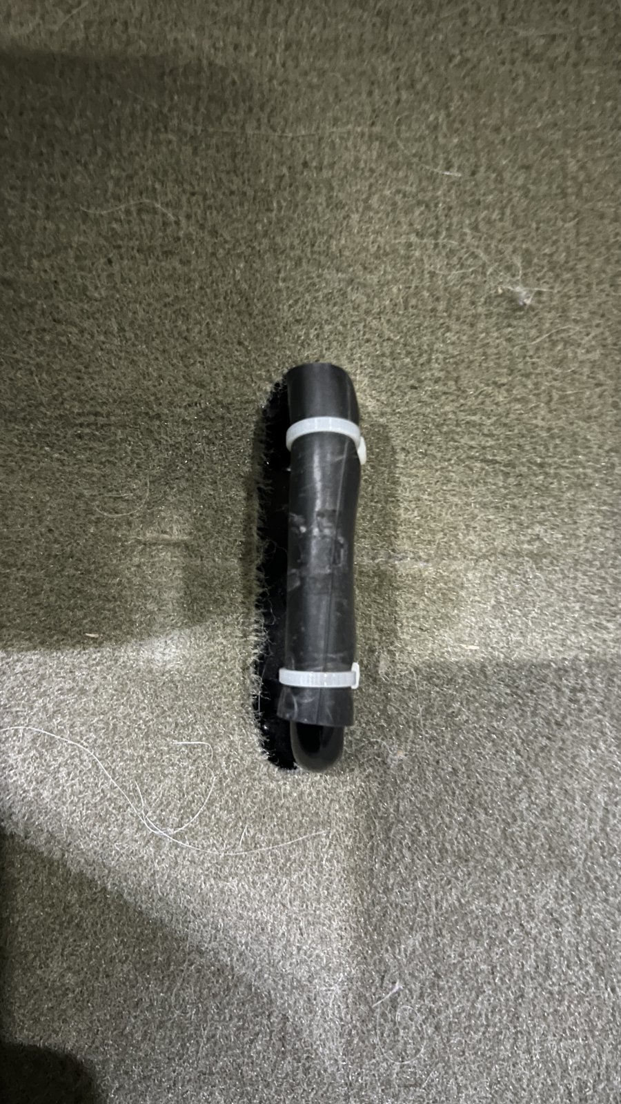

My 2016 back captains chairs were rattling and I found a temporary fix. I installed 2 short pieces of bicycle inner tube attached to the latch rod on floor with tie wraps. Seat is a little hard to latch down but does work if pushed firmly. Wrapping with layer of electrical tape might work better but haven't tried that. I did previously install the washers under the floor attachment pan bolts as recommended on a YouTube video but that didn't fix it. Made no sense as to how it would but I tried it anyway and didn't help.

Try this fix for your rattling seats. I used short piece of bicycle inner tube attached to the floor attachment rods with tie wraps. A few wraps of electrical tape may work too. My seat is a little harder to latch down with rubber on seat attachment rod but it will latch down if pushed firmly.
