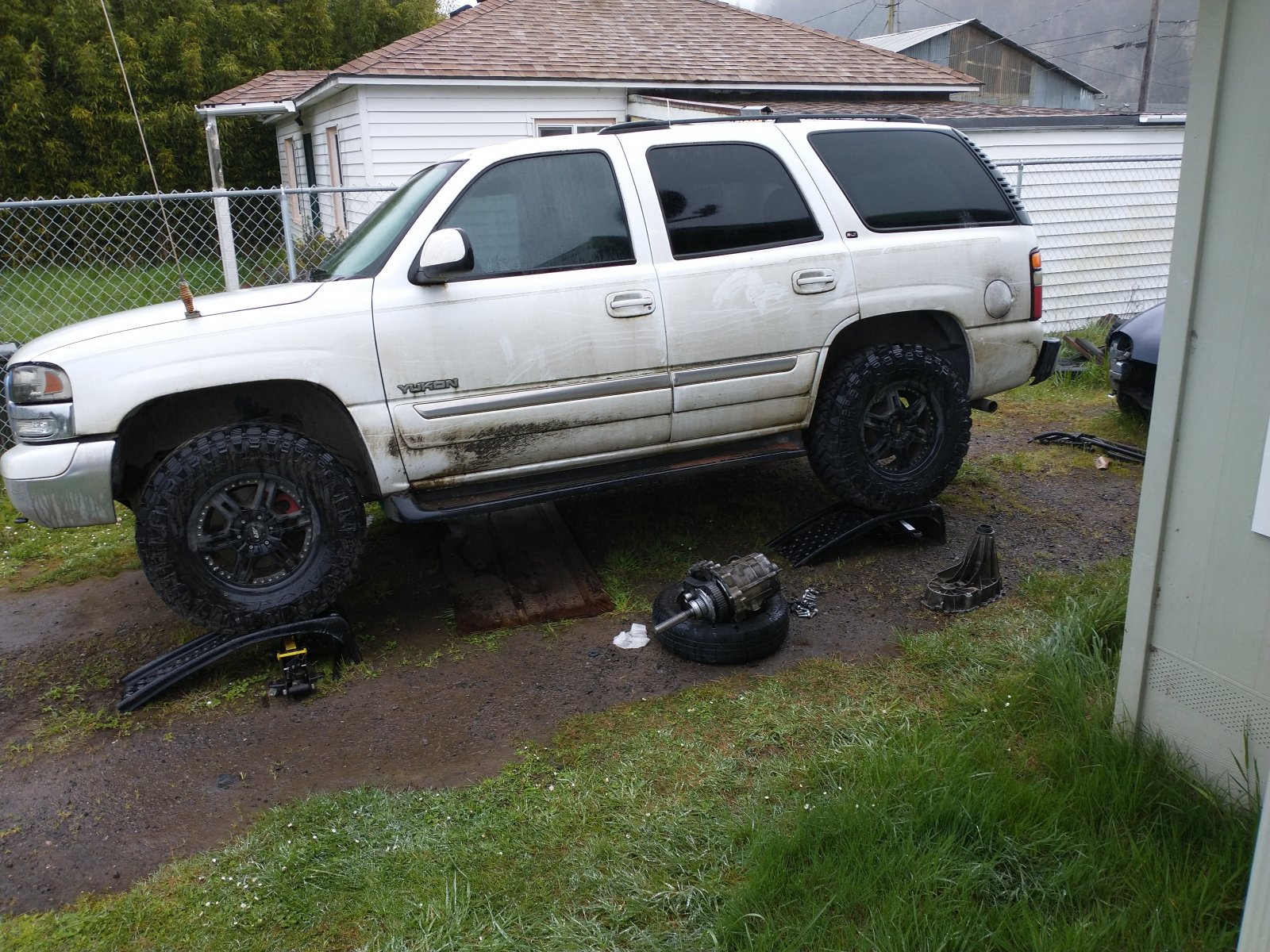

this is mine right when i got my km2's. (before i got keys and spacers) and i think i only rubbed like 4 times or something but you should be fine cause this tire is beefy

what size are those km2s? 285/70/17? You got any pics with the keys and spacers in?

Nvm. Saw your other post with the keys and spacers. When you get a chance, could you measure the height of your front and rear fender well? From ground to bottom of fender well. I'm interested to see how high you are with 2 in spacers and keys.

Yeah I have Dynapro MT's 285/70/17's I had no problems with rubbing before I put keys and spacers in. Oh and I have an LT not a Z71. I believe the z's were a little bit higher stock than the LT's.?. I am at 39" in the front with 2" keys and 39 1/2 with 2"spacers in the rear of the hoe.
