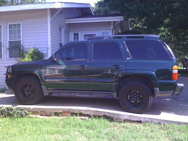

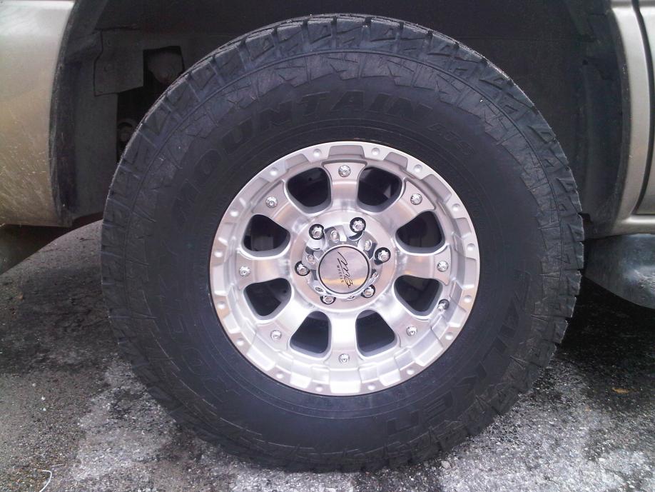

I have an 04 Z71 4WD, running P285/70R17 Bridgestone Revo 2's and have no rubbing. Did not have to adjust keys either. Fills in wheel wells great.
gmcjohn
Oct 21, 2009
192
Abstrastic, What size rims are those? 16s?
