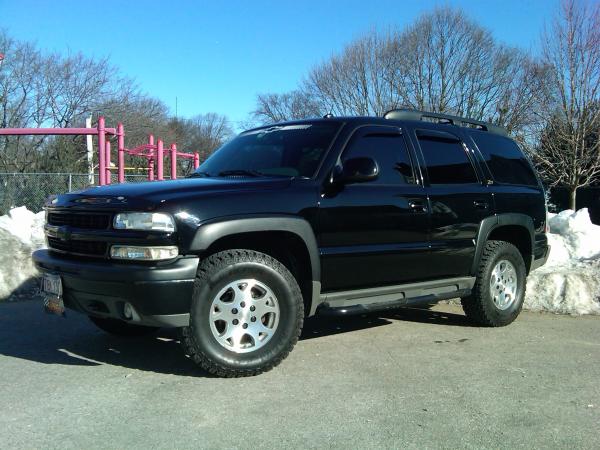

Here is a picture of it before the drastic changes!.picture.jpgNo I left the rear alone I just cranked the front keys
