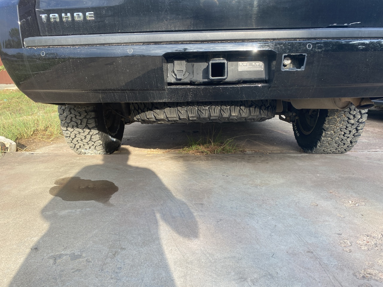

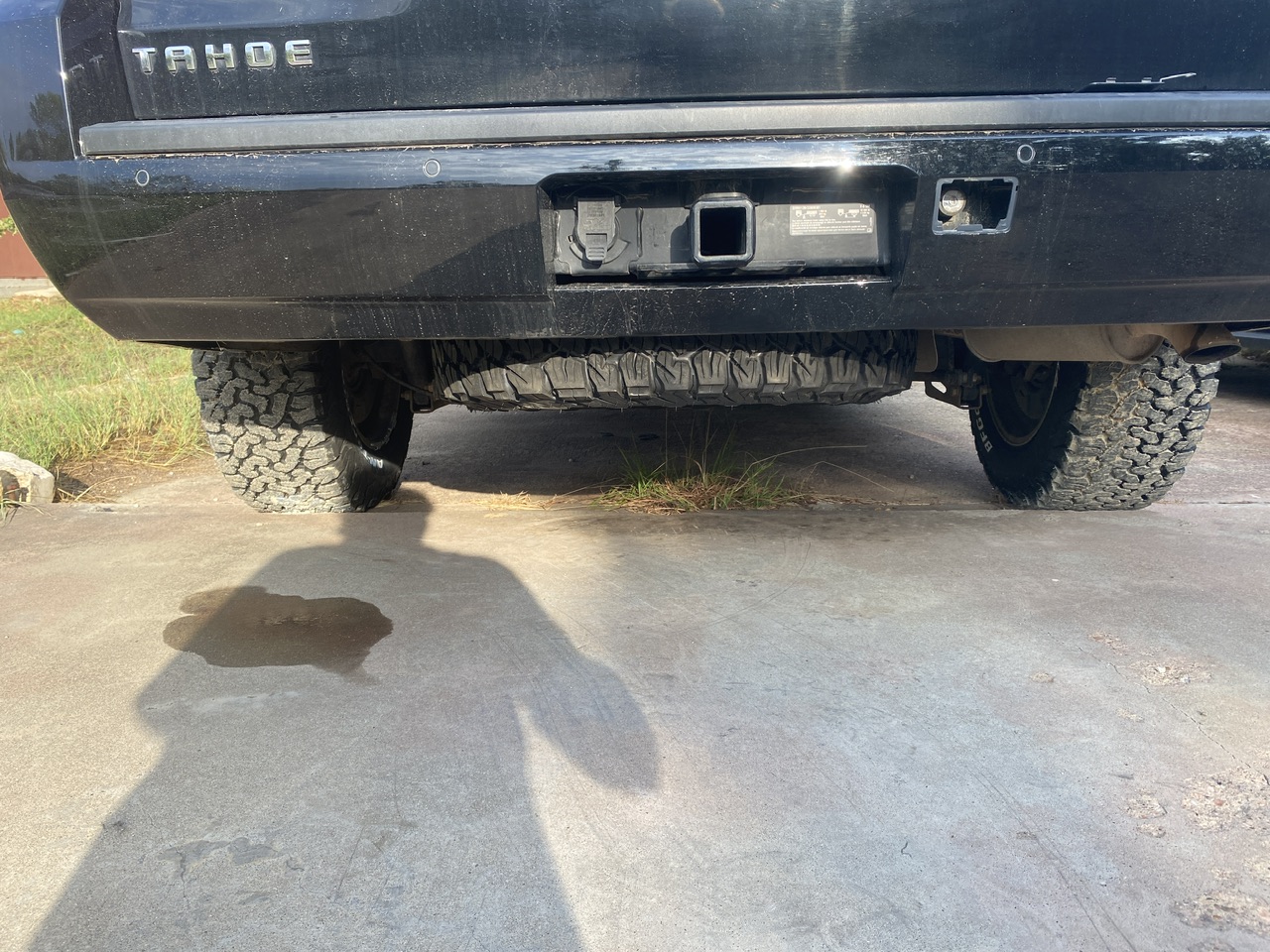

Sparksalot
Sep 20, 2020
6,775
20,587
Bastrop County, Texas
Good to know that fits!

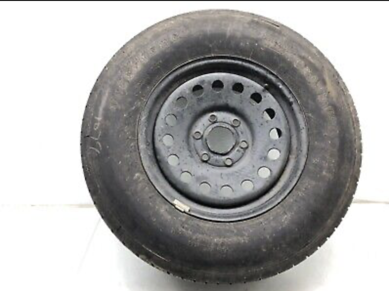

Was looking for the crappy black stamped steel one. Like this factory 17".
