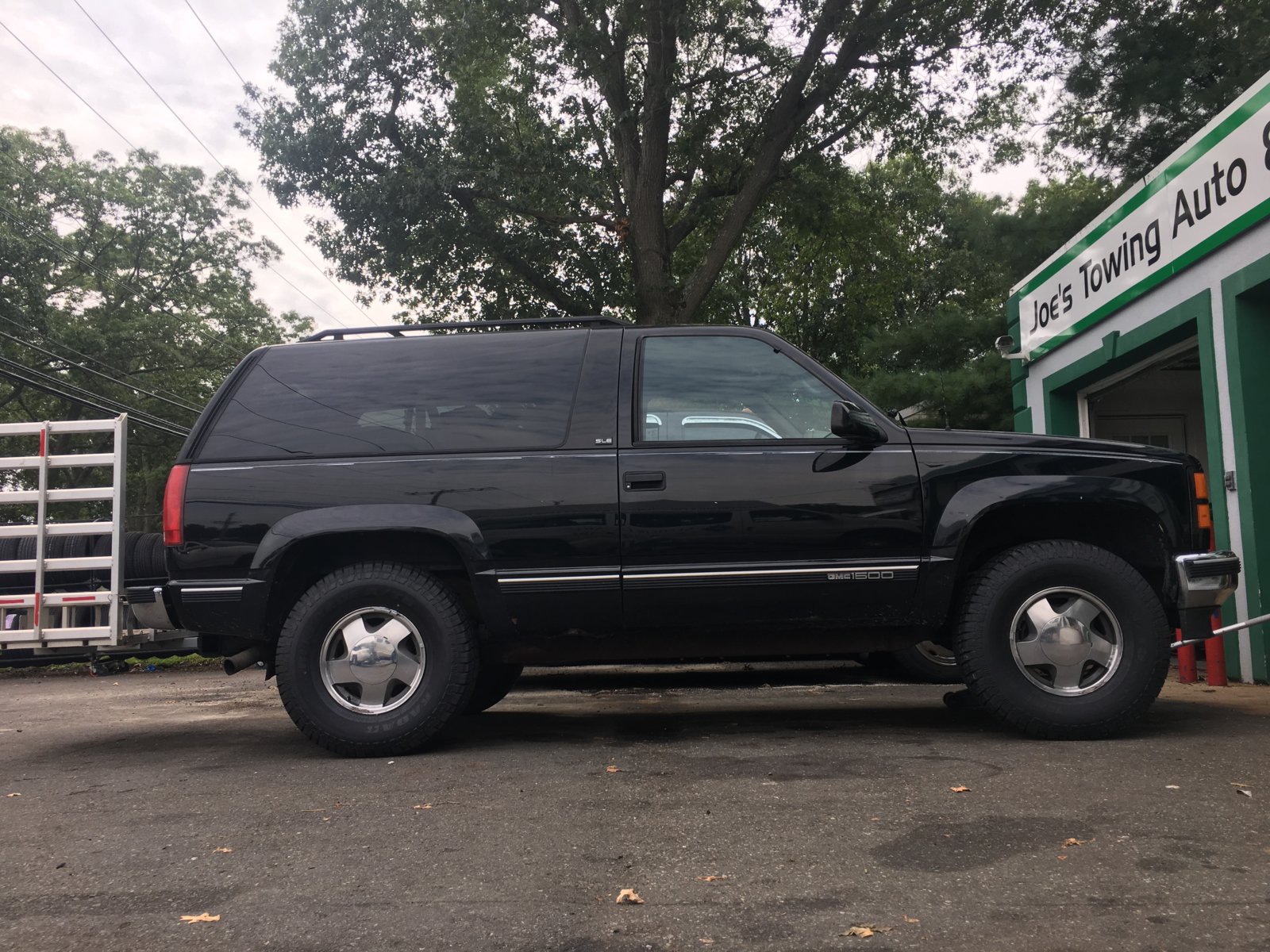

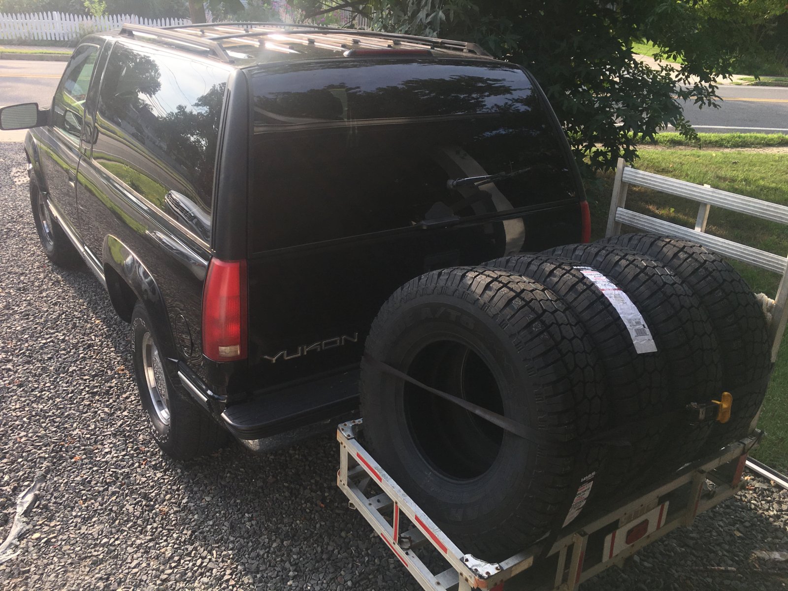

285-75-16 A/Ts
arrived today.
Replacing
P265-75-16
No lift

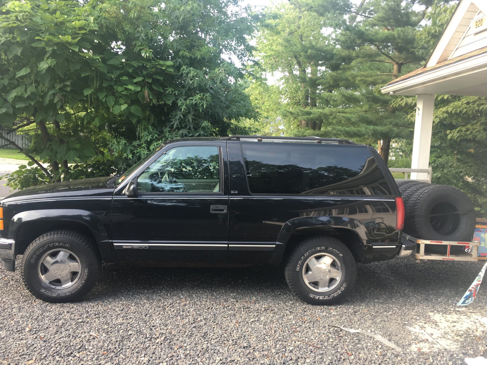

Radar Renegade AT5
285-75-16
Set at 38psi
After One Day and 80 miles, I found the set to be:
Quiet (for an A/T or aggressive HT)
Comfortable on the road
And overall my 2 door Yukon feels like a more confident and planted ride on dry road.
I am still breaking them in, and will do a short video soon.
They look great on the truck, and clear the fenders without rubbing at full turn.

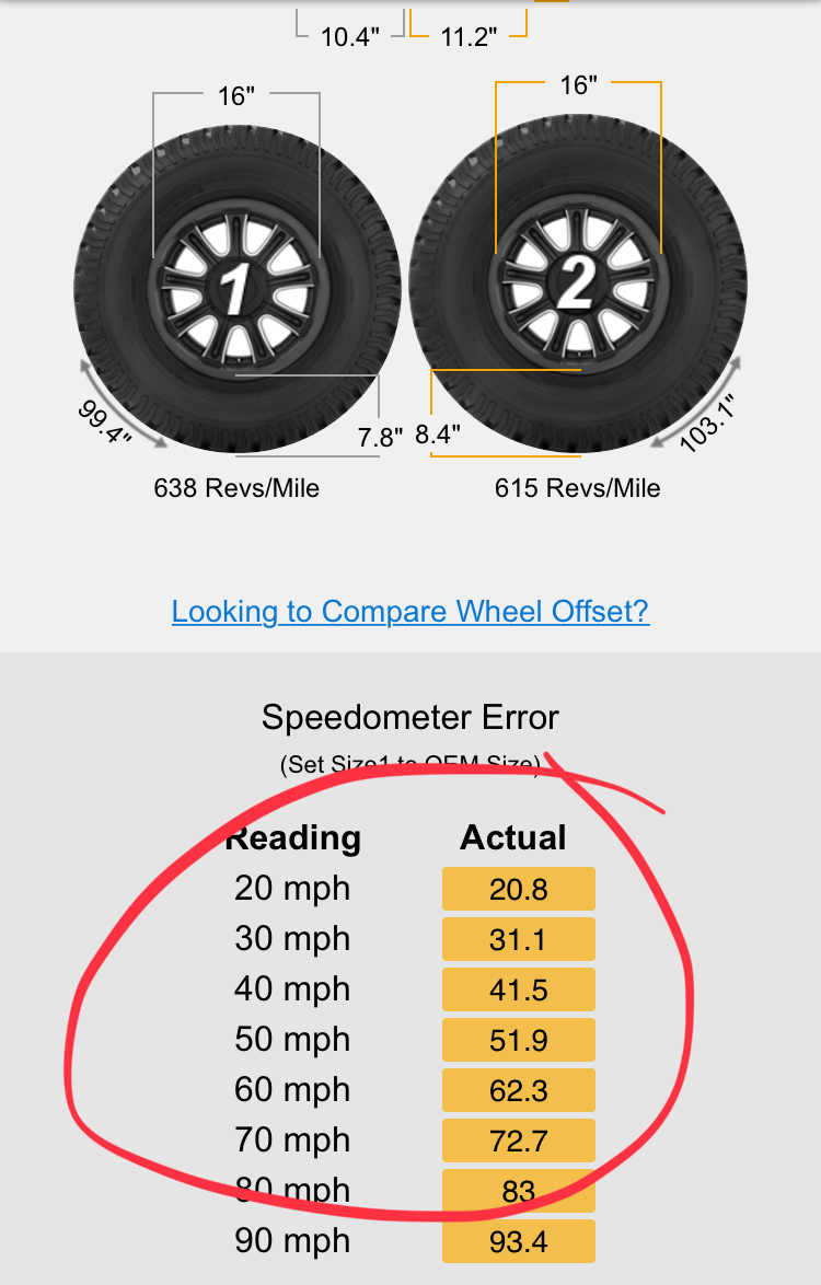

Your speedometer is more off now isn't it.I have 265/16 on mine right now and I don't like that speedometer is off.on highway speedo has 65 but feels like 55 mph
TARDIS
TARDIS
May 20, 2018
123
148
Jersey Shore
The speedometer is incredibly close to accurate MPH.
This chart shows you the difference in OEM (265/75/16) and my current tire set up.
At most I am only 3 MPH over at 70mph.

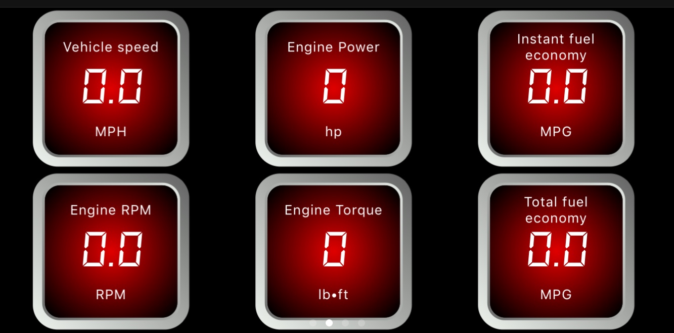

Luckilly, I also run a digital screen from my OBD2 that gives an exact MPH by callibrating the size of the tires. BB73E2CC-1A92-4E2D-9F0B-1BC46D4560D5.jpeg
