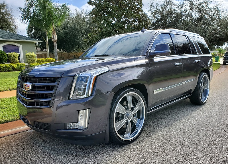

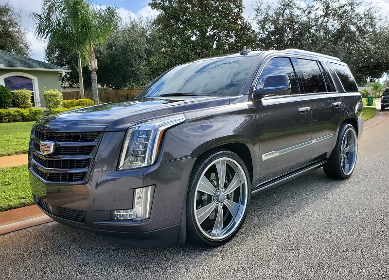

I'm running 295/30/26 tires on the intros that are on the Escalade. No significant rubbing issues except for some slight contact on full lock.
Staggered 02
Jul 5, 2019
672
1,556
The wheels are staggered. I actually have staggered offset wheels on a few rides.
