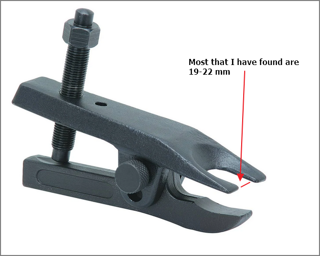

Hi All,
I am attempting to swap out the lower control arms and I can't seem to find a ball joint separator with a fork wide enough to fit around the 23.24 mm lower ball joint shaft. The one I have is 19mm, and the largest I can find is 22mm. (With the exception of possibly some very expensive Euro kits)
Does anyone have a source on one that fits?
I would much prefer to use this over beating the hell out of the knuckle, or using a pitch fork. (Tried both already.) The separators have always made removing the ball joints a snap. (Worked like a charm on top)

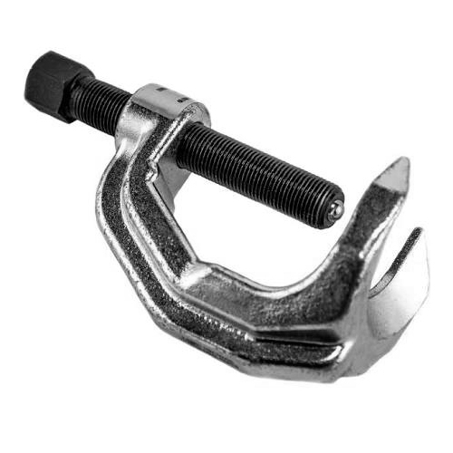

We ruined some HF Pickle Forks earlier this year trying to get the lower ball joints to separate from the knuckle. Bought that tool up there from HF and ground it all over to get it to fit. In the end, we cut off the tip of the balljoint and then slipped this modified separator over it and BOOM, it came apart. Oil and heat did not work for us.
Next time, I'm going to buy the right tool and not waste time. J-43631

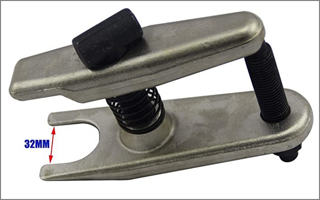

I found one that should do the trick. 32mm fork opening. Build quality is very nice on it, too. I much prefer leverage and the right tools over swinging sledge hammers.
I am replacing the entire lower control arm with a new ball joint attached. You have to remove the lower ball joint shaft from the steering knuckle to install the new lower arm, though.

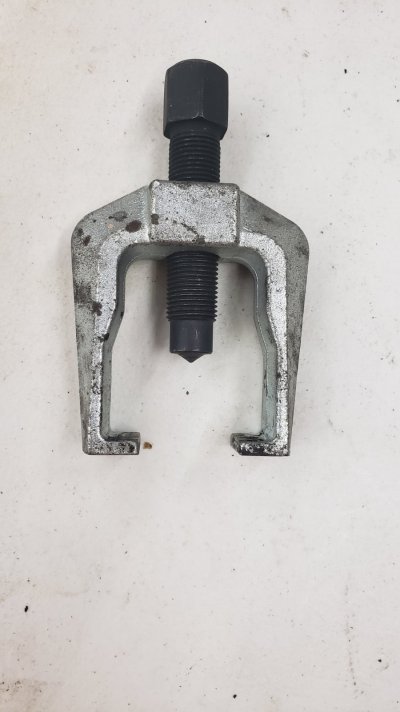

I have a US General one that looks just like that picture in the first post. I don't think I've ever used it, but it specs 3/4" (20mm).
When I did mine on the 2011 a few years ago, I used this. Don't know where I got it from though. It measures just over an inch opening, actually 29mm

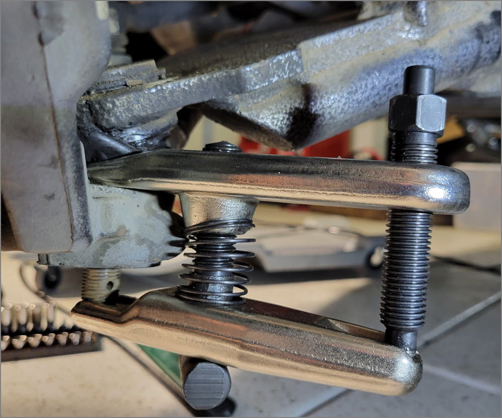

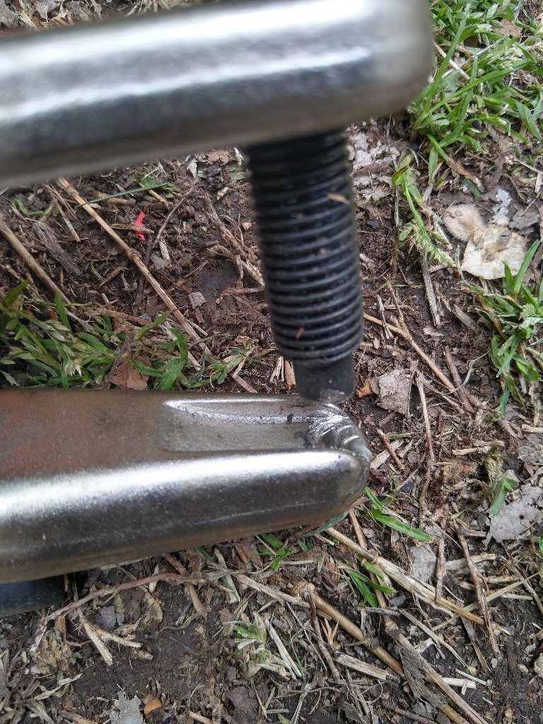

I bought the same tool, but with no branding. The bolt ends up slipping off the end and butchering up the surface. I'm gonna try and get a replacement and see how that one dView attachment 368179
What I have found to work well with this type of tool is to put a good amount of pressure on it and let it sit a bit. I have had several instances where after a bit of time left in place, it pops on it's own. A little heat and some percussion on the knuckle can work well to help it if needed, but don't go overboard on any of it.

I bought the same tool, but with no branding. The bolt ends up slipping off the end and butchering up the surface. I'm gonna try and get a replacement and see how that one doesView attachment 368179
This is the exact problem I ran into with my separator, although I was using a different one than you. Every time I tighten that bolt, it just slid further and further off.
I ordered the same one that tahoe_incomplete ordered. Hoping I have positive results.
