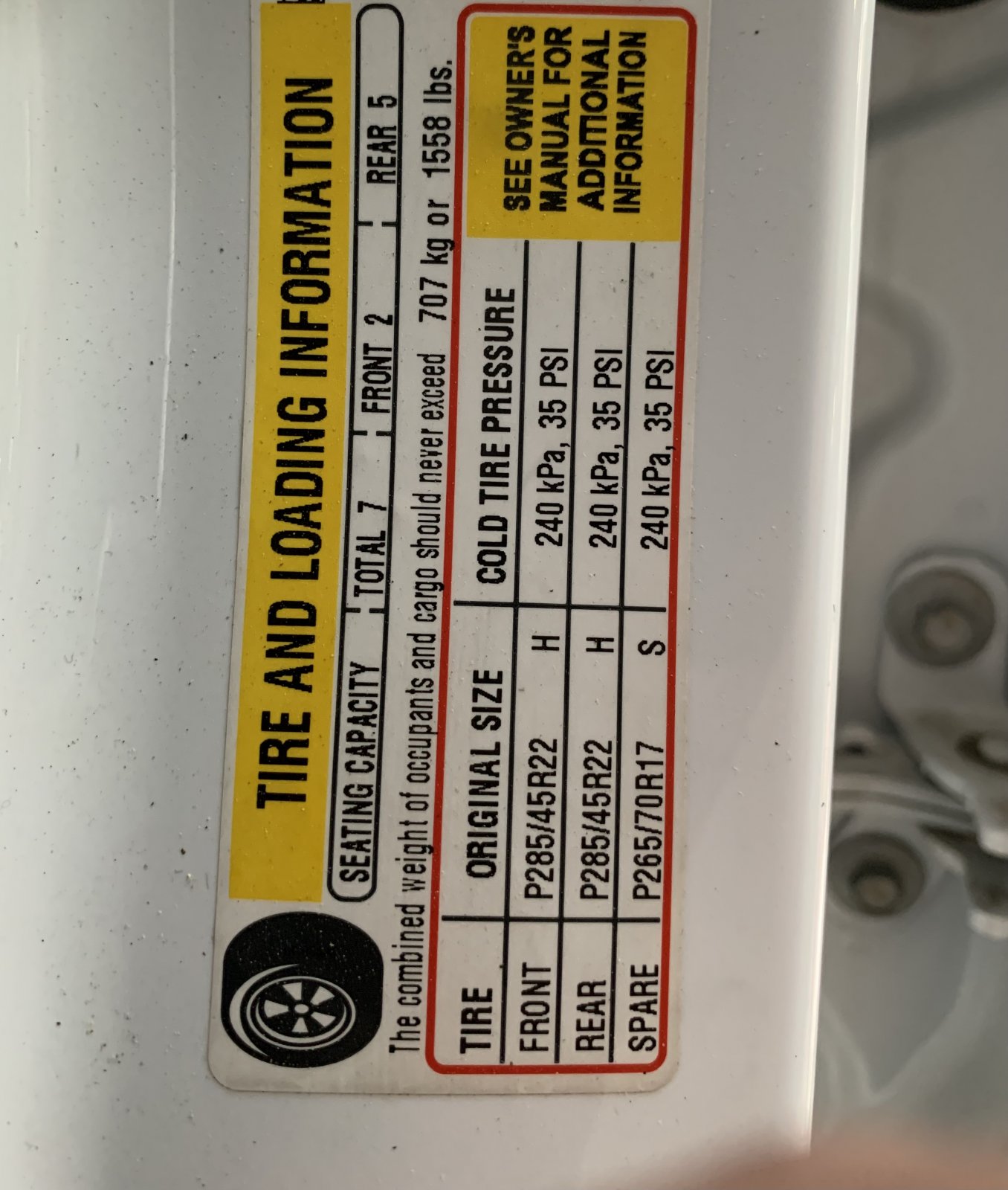

Door sticker from a 2016 Tahoe attached. Bought it used recently and have about 12k miles on a new set of Michelins. Wear looks great so far. Balancing this size tire is apparently a challenge. NTB struck out twice. Find a tire store with a “road force balancer”. Discount Tire hit the mark the first time, and typical with Michelins, one balancing lasts the life of the tire.
