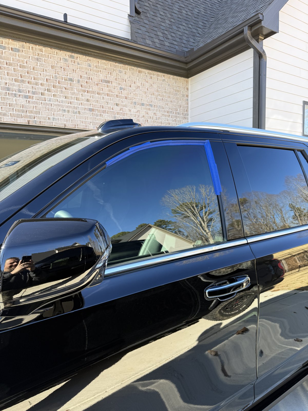

Semper1833
Mar 19, 2021
I would like to know as well if a fix was found, 2026 Tahoe High country and I did tale test and fixed the noise, seems to be where window goes into upper door frame.
