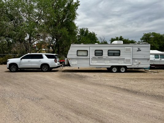

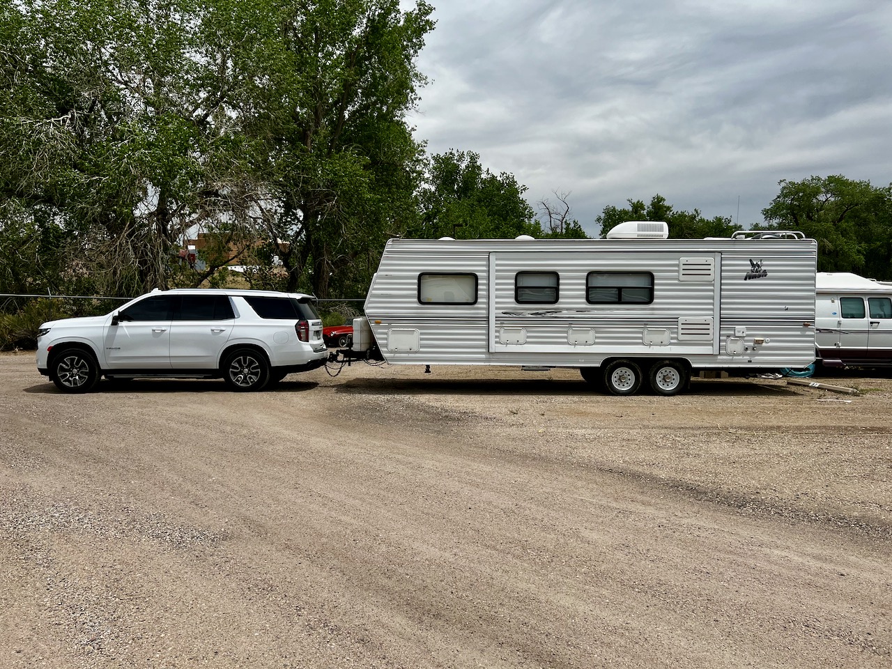

I was able to get into a 22 Tahoe LT, Duramax with Max Tow using a Husky WDH and am pulling a travel trailer coming in just under 8000# and just under 30' in length so I'm maxing out the rating. Pulling out of Denver into the mountains on I-70 isn't giving me any headaches but I am typically staying in the right lane taking it easy around 45-55 MPH when I can. If I had the option to get the Air Suspension I would definitely want it but overall I don't think the sag is too bad with the WDH setup correctly.
Below is a photo of my setup ready to go to see the amount of sag on the rear.

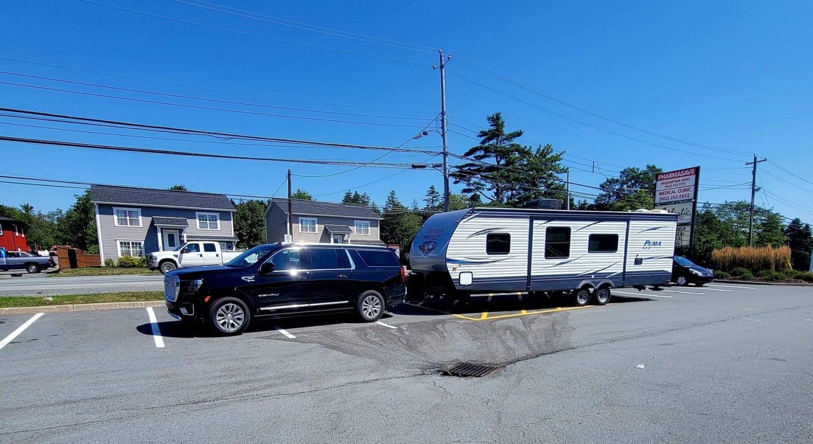

I have a 2022 Yukon XL Denali with the 6.2
No max tow
No air ride just the magnetic suspension
towing a 32' Travel trailer weighing about 7200 lbs. I use a Husky TS centerline weight distribution hitch. 1 inch sag in the back and 1/8 to 1/4 raise in the front.
Just towed it round trip of 700km and I didnt have any issues
The level looks pretty good in that pic. If anything, I'd want the trailer tongue to be slightly lower in order to prevent excessive sway. I wouldn't want it any higher.

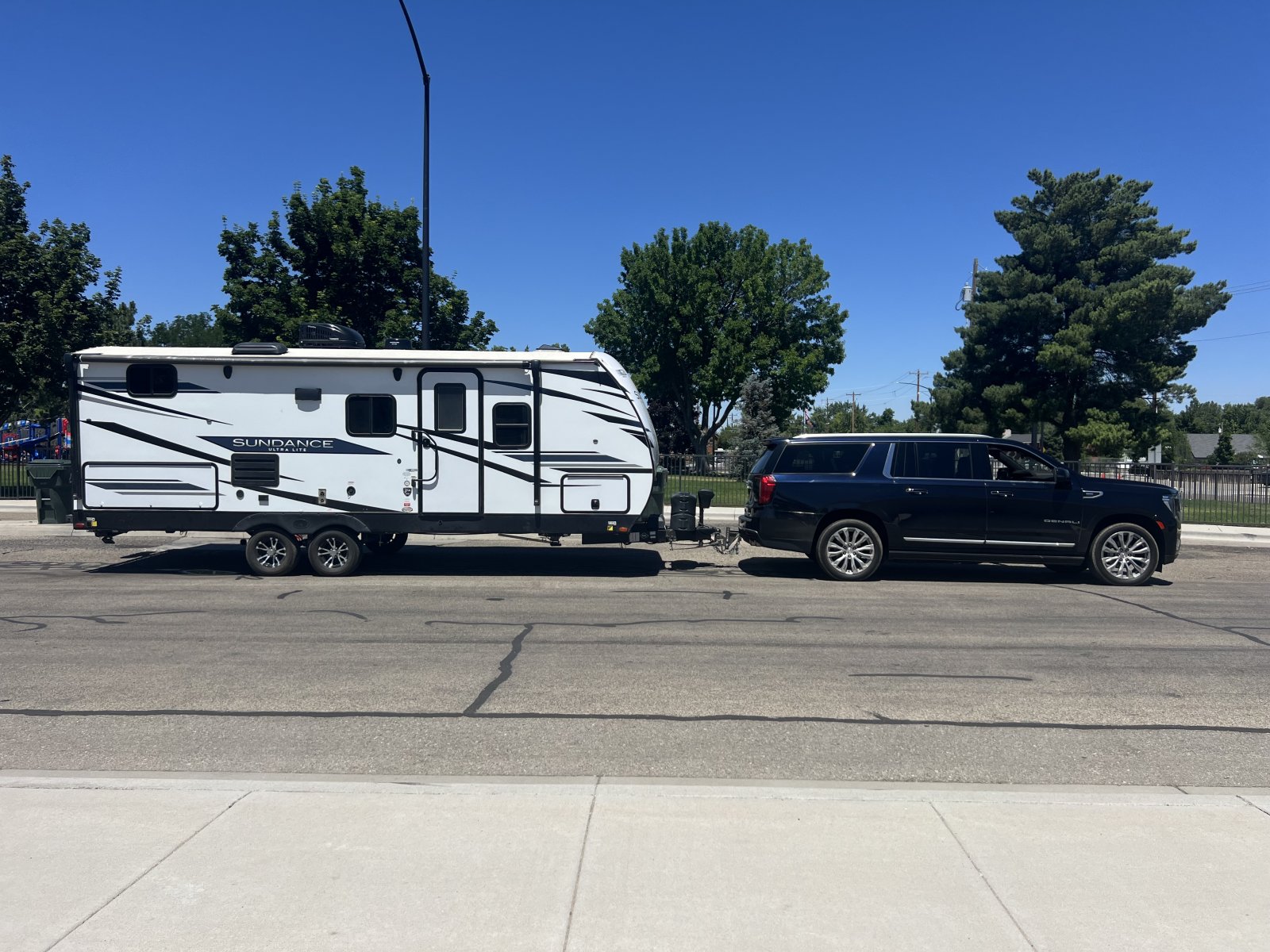

I have a 2022 Yukon SLT with the 5.3L V8. I am towing a 26' travel trailer and have the WDH but i still have some sag in the back im trying to get rid of. any recomendations for air ride? I can't seam to find anything.

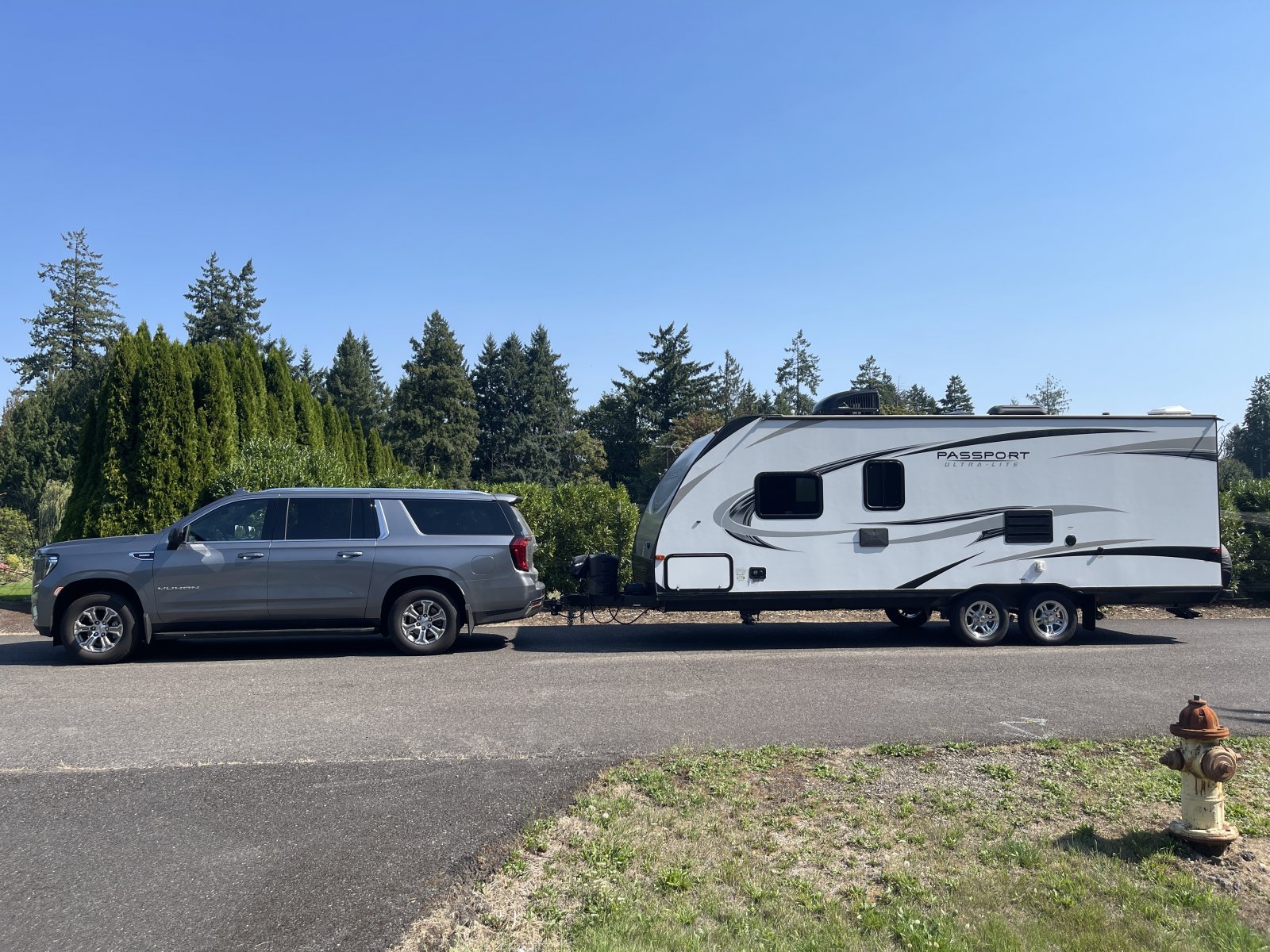

Don’t overload the front of the trailer. Spread out your gear from the front to the back so it’s not concentrated in the front. There’s already plenty of weight up there with the propane, batteries and WDH.
Unfortunately there’s no air bag setup available on the ‘21+ IRS system.
Here’s my setup. ‘18 Passport 239MLWE. ~4750lbs when fully loaded.

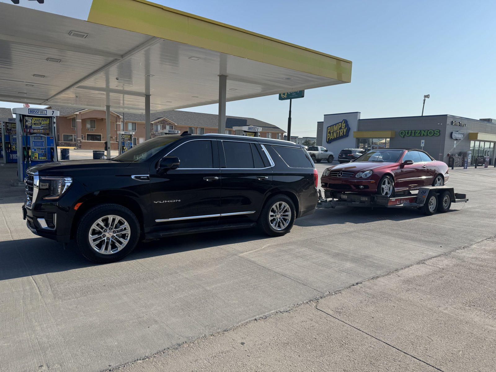

Out of curiosity, what's the concern with sag? I recently towed a car with a '21 Yukon, 5.3L, and max trailering package. It looks like quite a big of sag (couldn't move car back on the trailer) but the Yukon pulled beautifully, without steering or stability issues. Total weight: 6000 for Yukon, 2200 for trailer, 3800 for car, 605 passengers and dogs, 100 luggage, 215 lbs fuel (both vehicles, full tanks). See photo for reference.
21,322
30,319
Well, you might have exceeded the payload capacity of the Yukon and it's rear axle capacity. This can damage the old axle shafts, but not sure it would affect your IRS. Even though she drove fine, her front end was unloaded which could have caused problems in a crash stop or sudden avoidance maneuver. But if there was no room on the trailer to back up, even a little, I'd rather be tongue heavy then light and have the tail wag the dog, that's worse!
I towed a Cadillac earlier this year and moved it back on the trailer until my truck leveled out.
If you do this kind of thing again, run her over the CAT Scales at your local truck stop. This will give you the weight of the steer and drive axles and the trailer axles. Before you do that, weigh the truck by itself someday with just you and a full tank of gas in it. Then you can compare those weights against the limits. These trucks are overbuilt and can haul more than they're rated for short distances and or on level ground.
