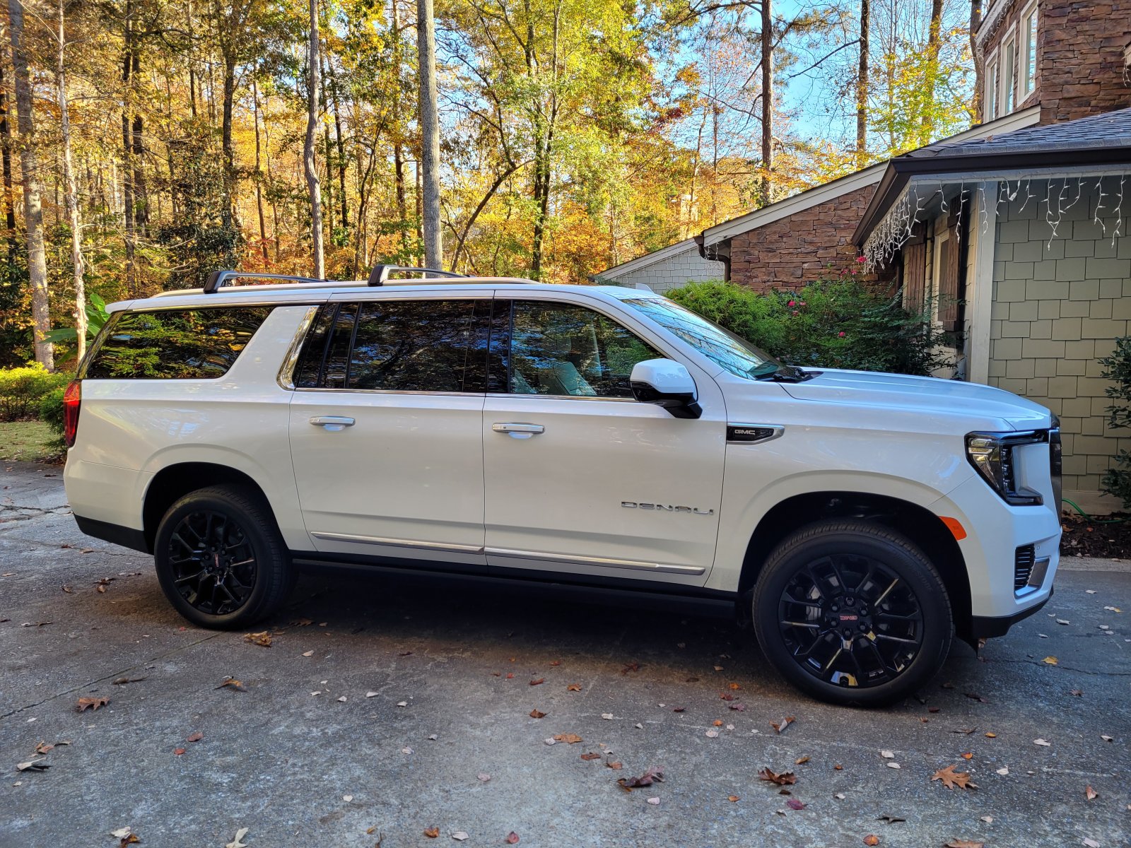

Hey all - picked up a 2022 Yukon Denali Ultimate on Nov 1st (ordered in July). Really lucky to be able to get it when we did given all the production shortages and delays. Great truck so far, but just noticed after ~1500mi that the center console controls (sunroof, roof shade, center console motor, garage door control, motion sensor, etc.) stopped working. All the roof lights in the headliner (middle and back rows) also stopped working. Took to the dealer today and said the control module went bad? They apparently have to overnight a part and will have it fixed tomorrow. Apparently a fuse also went which is why the rear lights stopped working. Sounds suspicious that both would fail at the same time. Anyone else have similar issues with '21 / '22 parts failures this soon? Of course it's covered under warranty, but I wasn't expecting to be in the shop for 48 hrs only 4 weeks into ownership. Should I be worried / surprised that a $93k truck has parts that fail this quickly? Thx!
