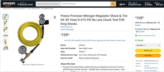

I wonder if something like this off Amazon would allow us to tap into, and use the air from, that port on the factory air ride tank?
Anyone out there wanna be the guinee pig?

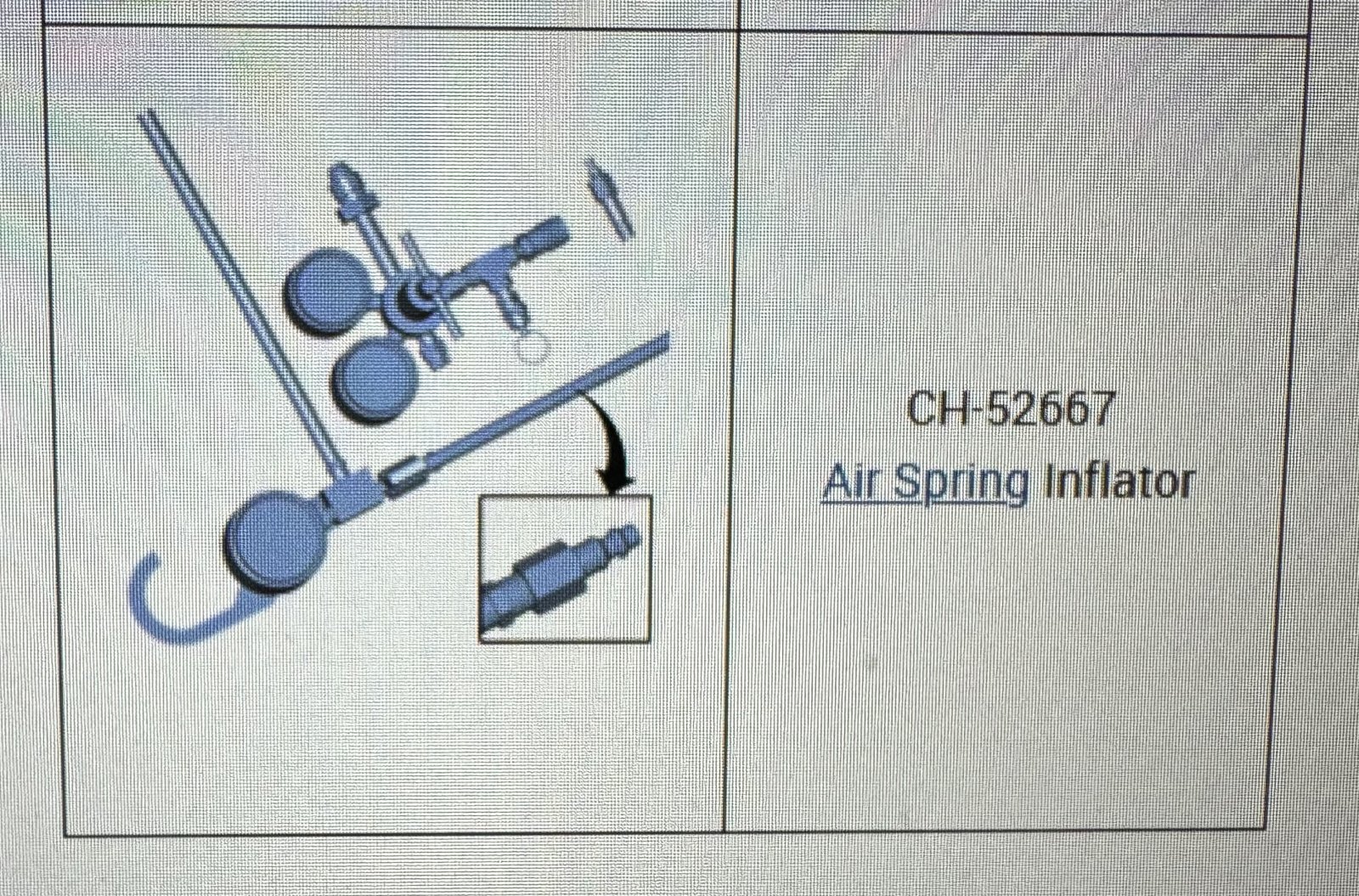

See attached. They called the tool a CH-52667? Also attached a tsb. May be op’s original problem?

I'll be damn ,,, it is a r134a refrigerant fitting on the tank.
I googled that part number and found one of those tools available for sale (costs $1600, um no thanks) , but reading the description sure was interesting, below is copy/paste for the description of that tool (see bolded and underlined section for the interesting part)
CH-52667 Nitrogen Injector Kit GM-52667
This tool is designed to inject nitrogen into the air suspension air springs and air tank. When servicing a component, the system loses air, and the onboard compressor cannot fill the entire system.
An adapter will be used on the “Wonder Valve” fitting of the air spring and an R134a fitting on the air tank. Nitrogen will be used to achieve the air dryness specification and to inject specified pressure into the air springs and the air tank. This will also prevent any oil or debris from entering the system.
The kit contains:
  • CH-52667-1 Regulator Assembly
  • CH-52667-2 Port Assembly
  • CH-52667-3 Fitting Assembly. Adapter for the “Wonder Valve” to be used with the air strut.
the above was copy/ pasted from this website
