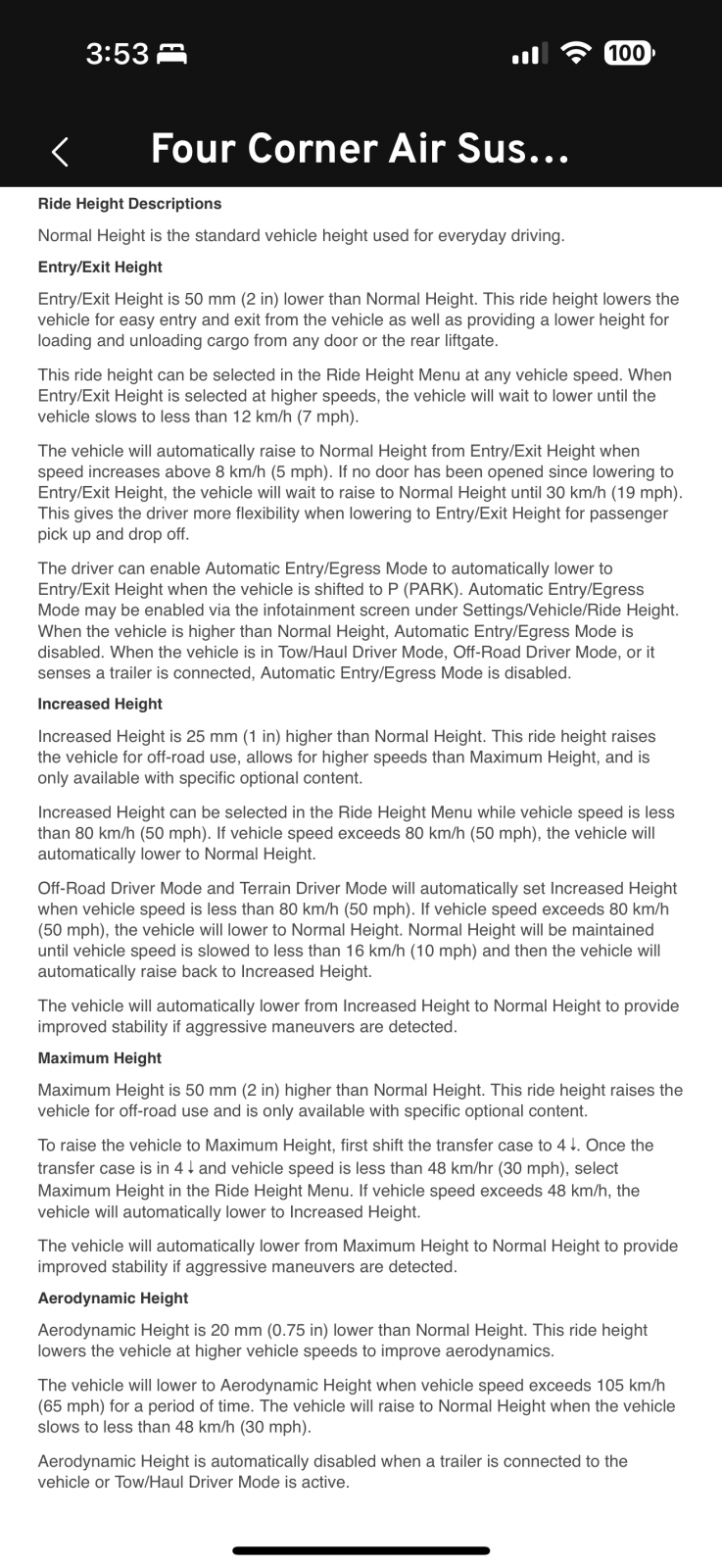

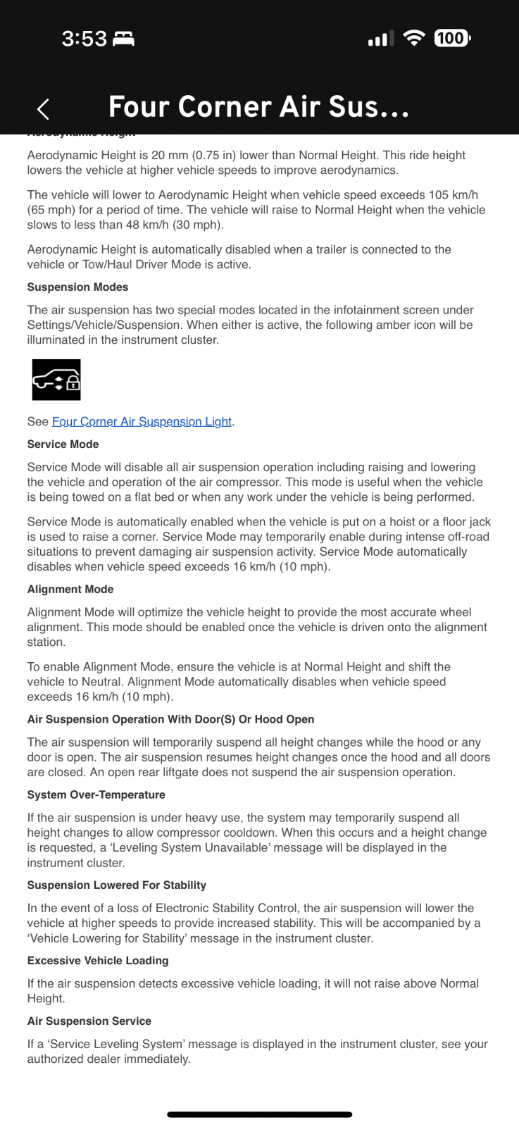

What drive mode are you in?
Certain ride heights are not available in all drive modes. For instance, you cannot go into “Increased” ride height when in tow/haul mode. And you can only go to Max ride height in 4Low. Also, if the load comes the vehicle is too much, you cannot go above normal. Speed is also a factor.
Attached are screen shots from owners manual.
Second this comment. If this isn’t your issue. Off to the stealership. No reason it should have issues already.
I'm tracking all.of this - I've used the leveling system multiple times both higher when off-road and lower when in a parking garage. It won't work in any of situations where it was working before, so it's not an issue with the vehicle configuration.
Also, I believe it will actually tell you in the warning message if it can't raise the vehicle due to tow-haul mode.

So just an update in case anyone else runs into this - I think I found the problem.
Got home yesterday, and everything has been working without any issues today.
Thinking about it, I think what happened was that there is probably some type of weight or pressure sensor, and with 4 people and the truck fully loaded, it either couldn't, or wouldn't raise the truck. I suspect that if I had lowered it, it would have come back to the "normal" position without any issue, but it wouldn't go higher than that due to the weight.
As soon as I unloaded everything from the trip, its been working fine. I believe payload capacity for the truck is around 1250lbs. and doing some quick math in my head, we were probably closer to 1700lbs. passengers/cargo
GM should really update the message in the DIC to provide a little more information - would be trivial to add a message that says something about too much weight to increase ride height, or something to that effect instead of just saying "system is unavailable".

Excessive Vehicle Loading listed in the owners manual as a reason for the Unavailable message (see 1st Screen Shot posted in post #7). However I agree w/ you that a message update saying "Vehicle Load Too High to Raise Vehicle" would be better than "unavailable."
