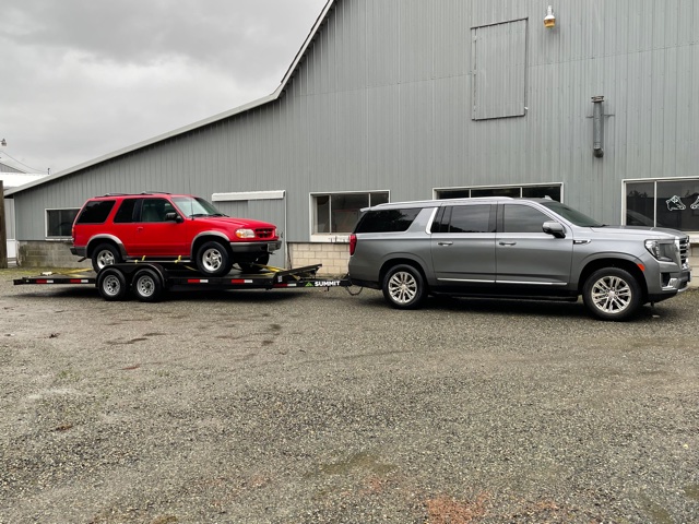

Hi, towing 5500 lb travel trailer with 720 lb hitch of weight before adjusting distribution hitch. All weights under Yukon rated capacity. Using Anderson weight distribution hitch, able to move 100 lbs to front axle, 100 lbs to trailer, so 200 less on rear axle. Yukon definitely sags in the rear, 1-1.5 inches. Has anyone added airbags to an SLT to help level truck? Does adding airbags effect the warrenty?

Its going to sag guys... You may get by with airlift helper bags in the springs, but other than that, the suspension is tuned light for ride comfort...

I tow a 7000 lb camper with our 2012 Yukon XL Denali - all of which came equipped with the rear air suspension as standard equipment. It turns it into a fabulous towing platform because it takes out all of the squat. Looking at the new trucks now, the Denali comes standard with Magneride, but air ride is yet another option on top of it, for several thousand $. That's a big loss for me. I may just opt for a lower trim when the time comes and add aftermarket airbags for towing.
I generally agree with the comment that a conventional solid axle is preferred for towing, but I've towed with IRS before and it was fine. Lots of folks out there towing with Expeditions as well.

The full on air suspension is an add on, but the regular spring suspension should come standard with the rear air leveling shocks on a denali.
From my understanding there are no aftermarket air bag setups available for the new rear independent suspension on these. And possibly wont be in the future.

Does that thing have the rear auto leveling air shocks? If so, that is sad. The prior model year air shocks worked fabulous at keeping the rig level, at least the last two we had did.

no air shocks

Well yea thats the issue then. Of course its gonna sag low in the back with a load. Hell, the last few rigs we had would air the shocks up just with a decent amount of people in the cabin…no trailer.
I wonder how feasible it would be to change out the shocks with aftermarket replacement air shocks and add in an airbag set from someone like airlift or firestone. . .
