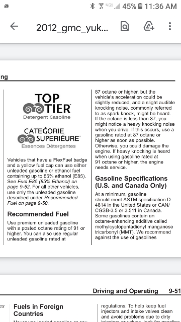

I think the recommended octane is at least 91
I've always ran either 93 or E85, which is something like 105 octane.
A couple years ago when I was on a summer trip I was in the boonies and needed gas and the highest octane they had was 89. I did run it, but just that one tank.
Attachment is From my 2012 owners manual
