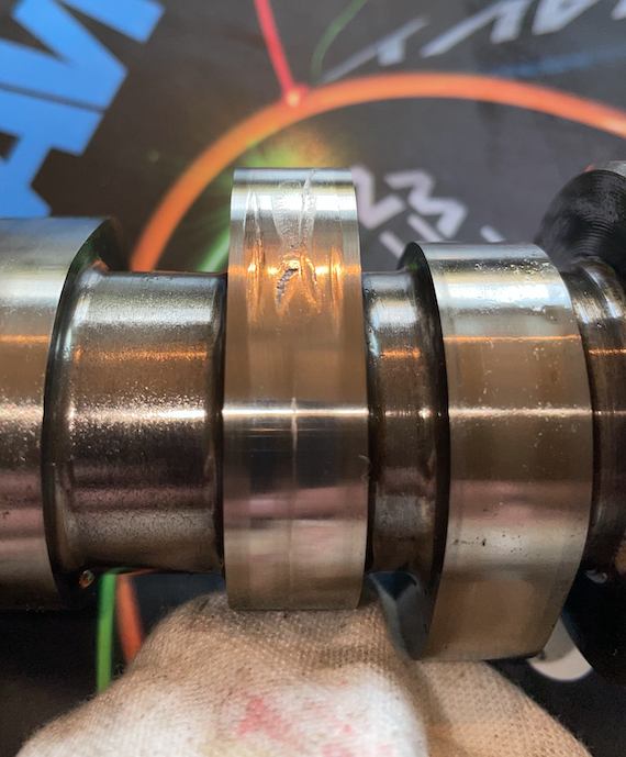

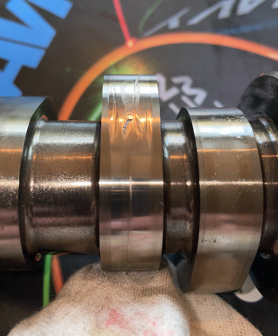

I too have been wondering if cams might start showing up as a problem on trucks that have had lifter failures. It *should* be SOP to inspect the camshaft lobes for damage when a lifter fails, which is difficult/impossible to fully assess when the camshaft is still in the engine. When a lifter fails, it hammers the cam lobes and causes damage (see pic below of what a cam damaged by a failing lifter looks like). While the cam will likely still function for an unknowable period of time, it will not last as long as one that has not suffered damage. The good news in your case is that your damage was bad enough to cause audible symptoms leading to GM replacing the cam, but that will not always be the case and cam failures on the rest of the fleet that suffered lifter problems is only a matter of time.
This is exactly what I’m worried about with my Tahoe. I had my lifters replaced (both banks) at approximately 7000 miles. Allegedly there was no damage to any other components. Allegedly they inspected with a fiber optic camera, though no evidence of this was ever shown to me. I am particularly skeptical of the representation that nothing else was damaged due to the fact that I started noticing what was later determined to be a lifter issue at approximately 4000 miles. I brought it in the first time around 4500 miles. Point being, I drove my Tahoe with bad lifters for approximately 3000 miles, and there is supposedly NO damage to any other engine components?!?! Seems far-fetched. I have not experienced any noticeable sounds or performance issues since getting my Tahoe back (yet), including two trips to the mountains involving miles of low-gear climbing, though I am just waiting for the issues to start again or for some other issue (like cams) to surface. I have no faith in the long-term reliability of the vehicle. Sucks, because I love everything about it, but reliability is a deal-breaker. I also don’t like being lied to about everything else being okay, when that is at best a hopeful guess to cover up the techs failure to actually inspect. Sounds like the original poster got the same treatment. Just waiting to be in the same boat, as the immediate poster pointed out, at “an unknowable time.”
