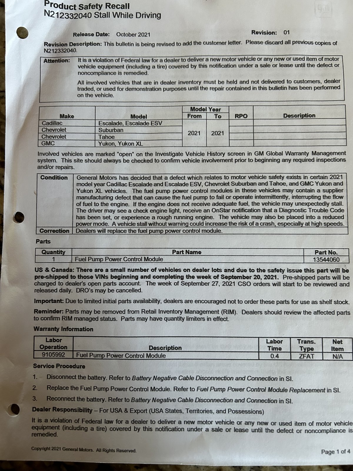

There was a recall but my vehicles vin was not in that recall they are replacing the fuel pump power control module. And yes had no front brakes went straight to floor I did not know but yes only reason I got stopped was because my back wheels were locked up . Tow truck driver also couldn’t get it into neutral dragging it on and off the flat bed everything shut down although could manually steer . Windows rolled down and radio turned back on when trying to restart and there was a horrible engine sound . On your forum someone else had this happen and onstar never answered me either was on hold due to high call volume and they would be with me shortly. I called my son told him where I was and he called me help

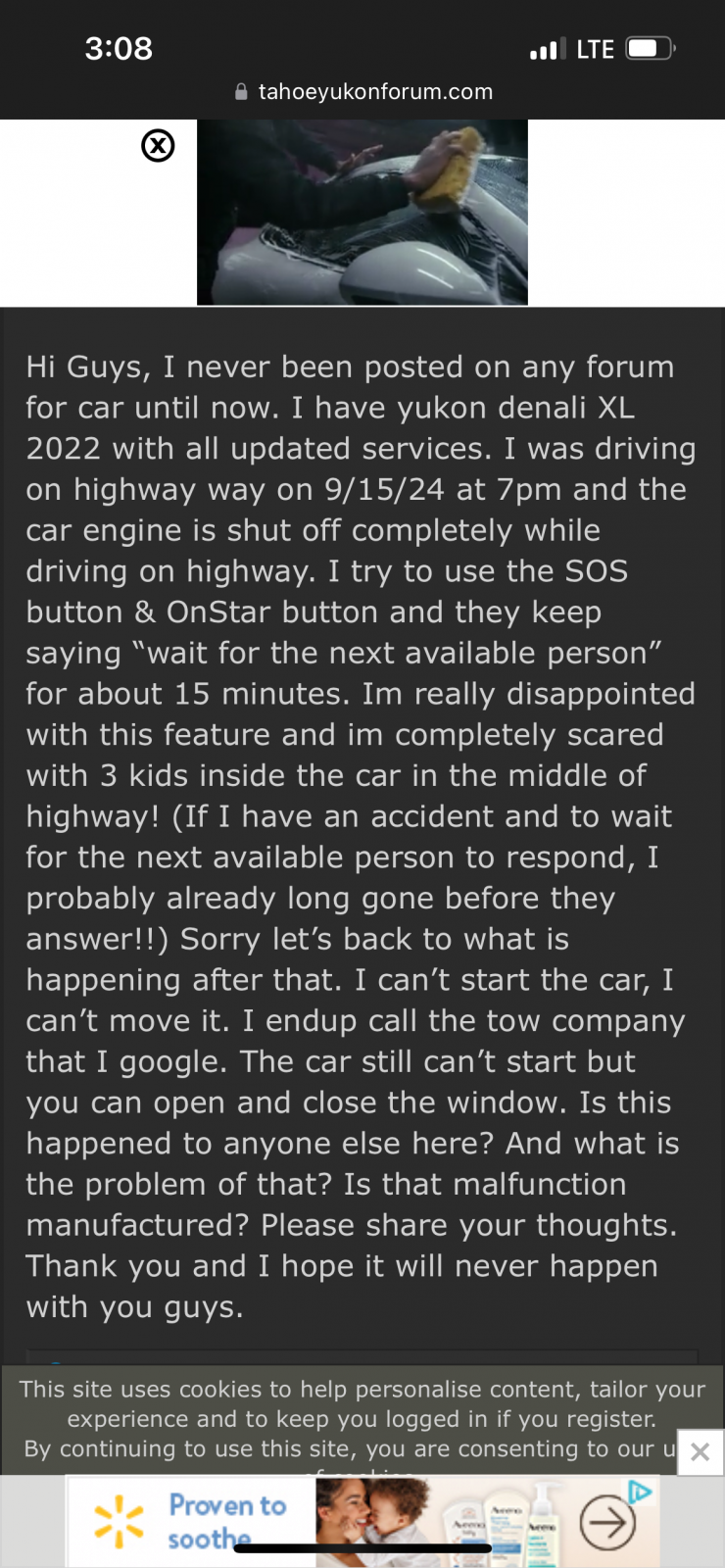

Yes, agree that you likely had Fuel Pump Module failure...at least that is what it seems. That is a known issue. It makes sense as well that the tow drive cannot get it into neutral. That is a defect of the design, you cannot shift if the vehicle is not running...so that makes sense if you could not start it.
But, it makes no sense that brakes failed (no front brakes)...Unless you also had an issue w/ the master cylinder, ABS module, ABS Pump, etc...so, if the only thing the dealer did was replace the Fuel Pump Module, you likely still have a brake issue. The two systems are not connected. Brake boost on these vehicles is electric, so if you had battery, you should have been good.

Well they still have my cadi and they changed the fuel pump modular . They are keeping to investigate I will inform on what happens really same old. And they will be doing 2 other recalls for transmission and gait way something.
