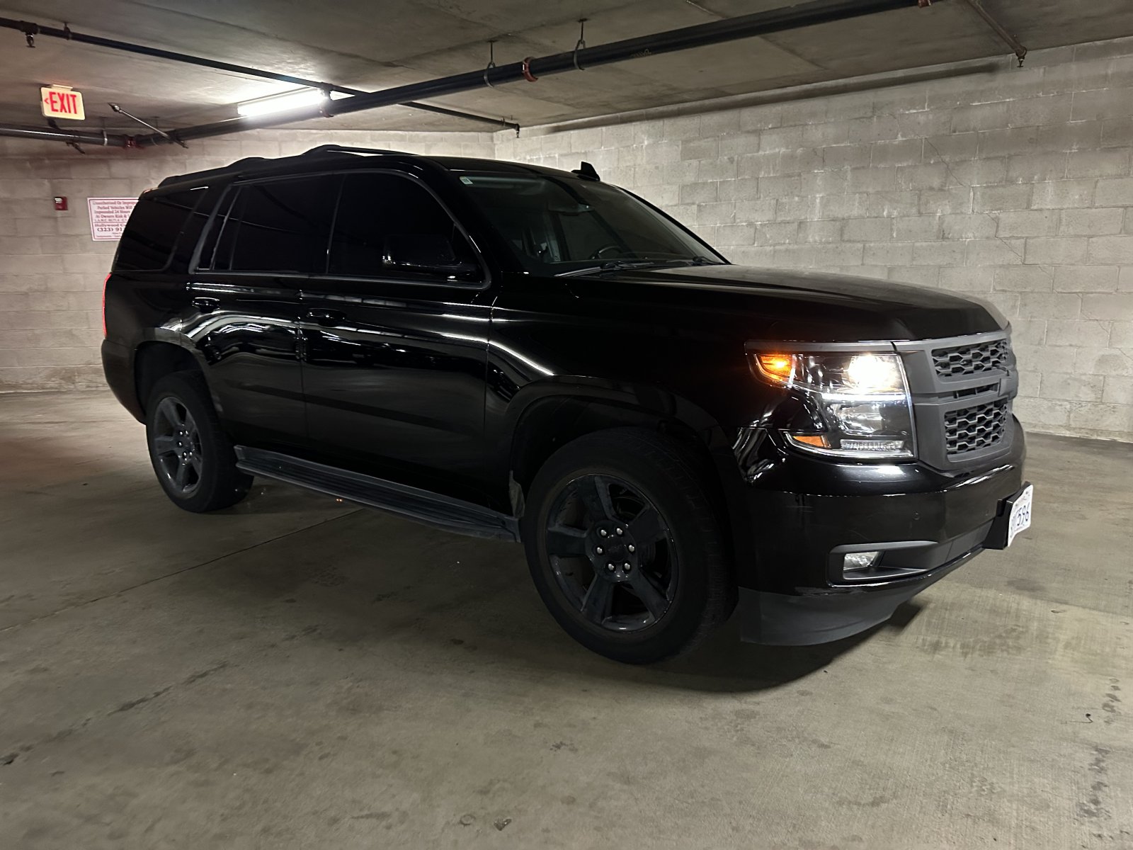

Greetings yall!
So I just recently sold my 2019 Raptor and have now taken over my wife’s Tahoe. I’ve been lurking here for the last few weeks…
I just purchased the Cognito Elite kit.
Can anyone out there with this set up let me know what’s the largest size tires I can put? I’m seeing 295 as the highest, however I thought I read about a few people running 305.
What off set are you guys running? I’m seeing some with a 0 or +18
And lastly, I have also read about some people adding a ready lift 1” spacer in the rear to maintain the rake. Any input would be appreciated.
I do not intend to tow, however we often camp and I carry gear regularly.

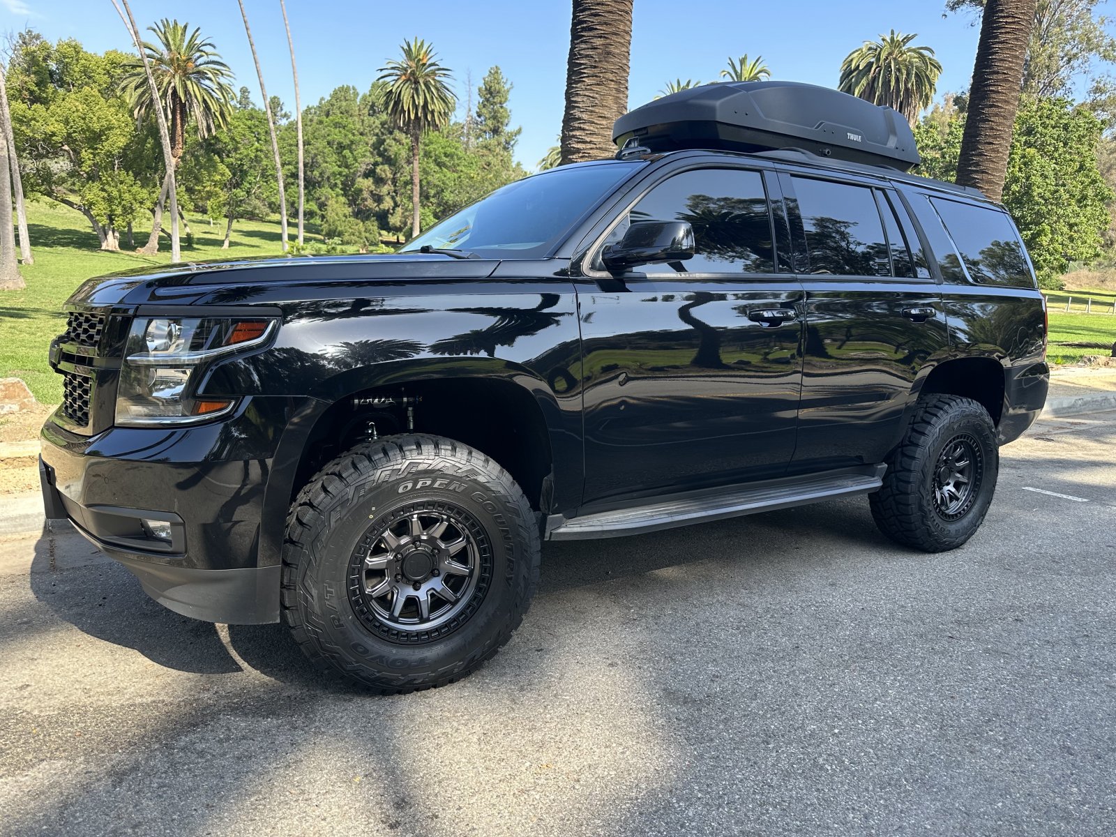

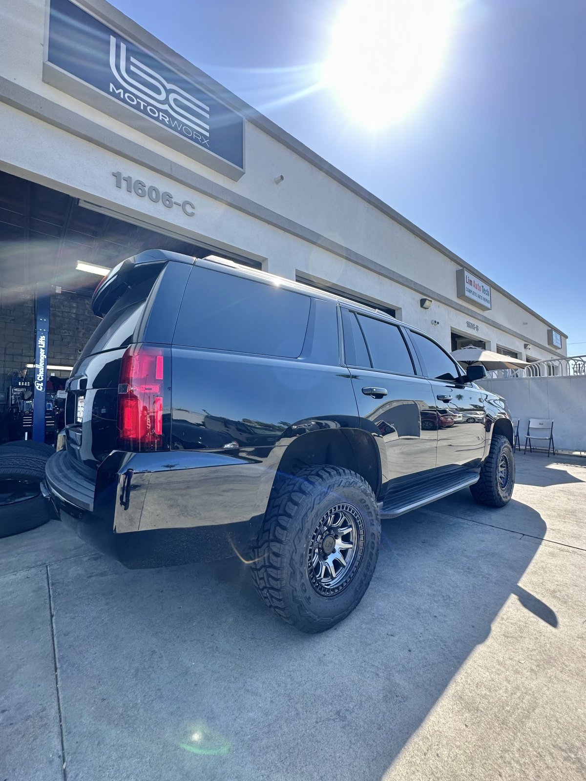

Love how this turned out!
Ended up just adding 2” coil spacers to the rear. Would’ve preferred longer coils, but the spacers were available the next day… opposed to a 3-4 day wait with coils.
Just in time for our LDW camping trip.

Thanks! Had blast this weekend camping and hangin at the lake.
Of course!
Current build specs:
Suspension:
Cognito UCAs
3” Level w/ Fox 2.5 up front
rears Fox 2.0 + 2” coil spacers
Wheels:
Black Rhino Calico 17x8.5
0 offset 4.75 BS
Tires:
Toyo RT 295/70/17

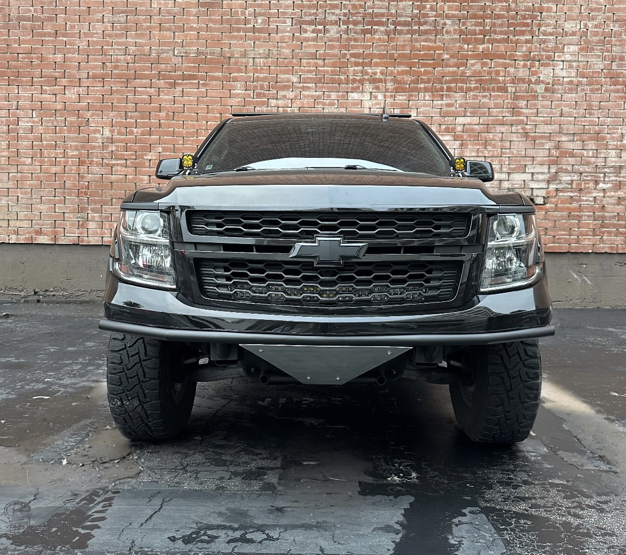

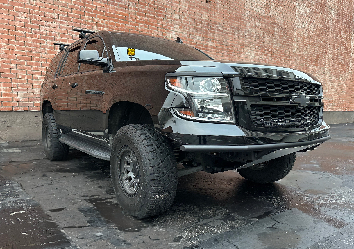

Looks so good! There's no real good off-the-shelf bumper options that aren't ginormous
Thanks!
Oh totally. I understand the functionality of some of the ones on the market, which have a full front gaurd.. but none of them are low profile.
The closest I found is the Baseline Overland front bumper. However, it's almost $2k and doesn't look amazing for that price.

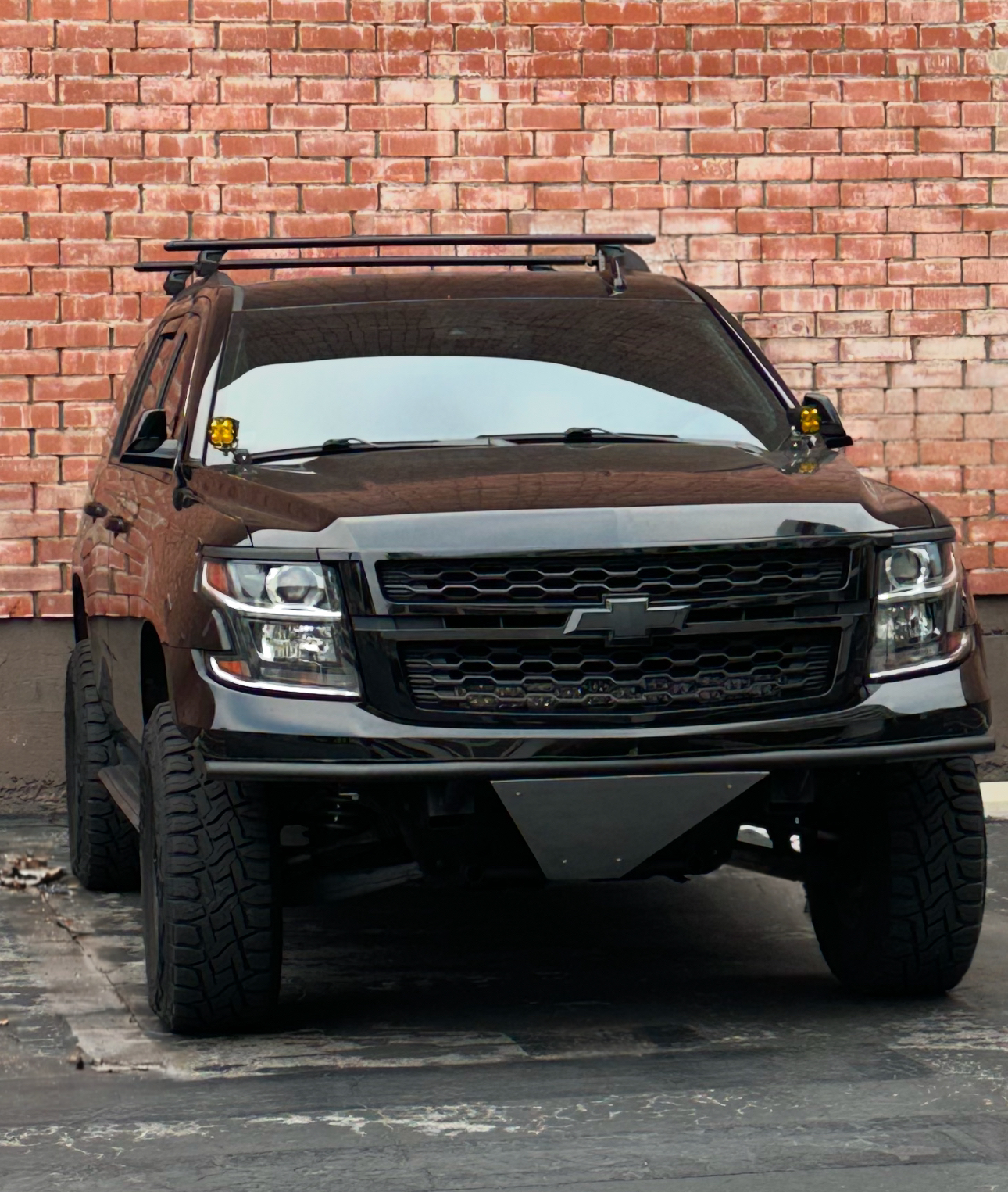

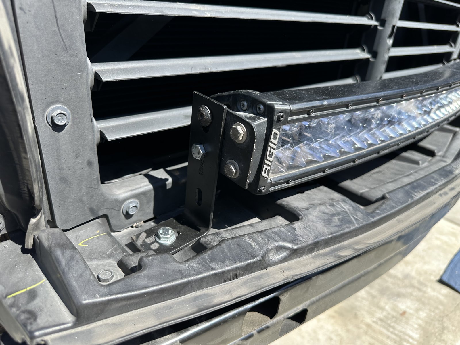

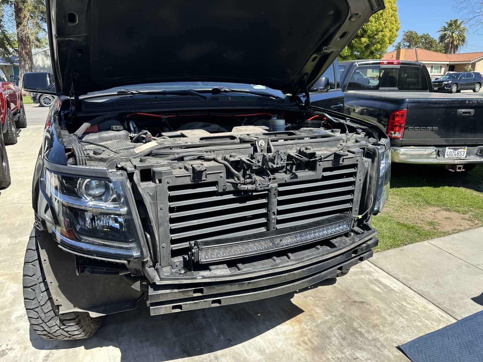

Of course! So I used an old LED bar I had from a previous vehicle, which is a curved 30" Rigid light bar. I utilized simple L brackets from the hardware store and cut them to the height I wanted. Which I basically eye balled with holding the grill and bumper in place.
Upon initial install of the bar, the grill and bumper were pushed too far forward being unable to put back in place. So I had to move the light bar as far back as possible and had to cut the bottoms 2 rows on the radiator shutter. (No picture shown of the cut shutters). I have read from others that without the shutter being cut or trimmed, there will be an ongoing alert for the active shutters.

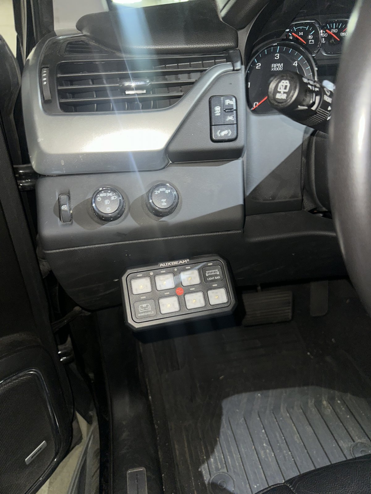

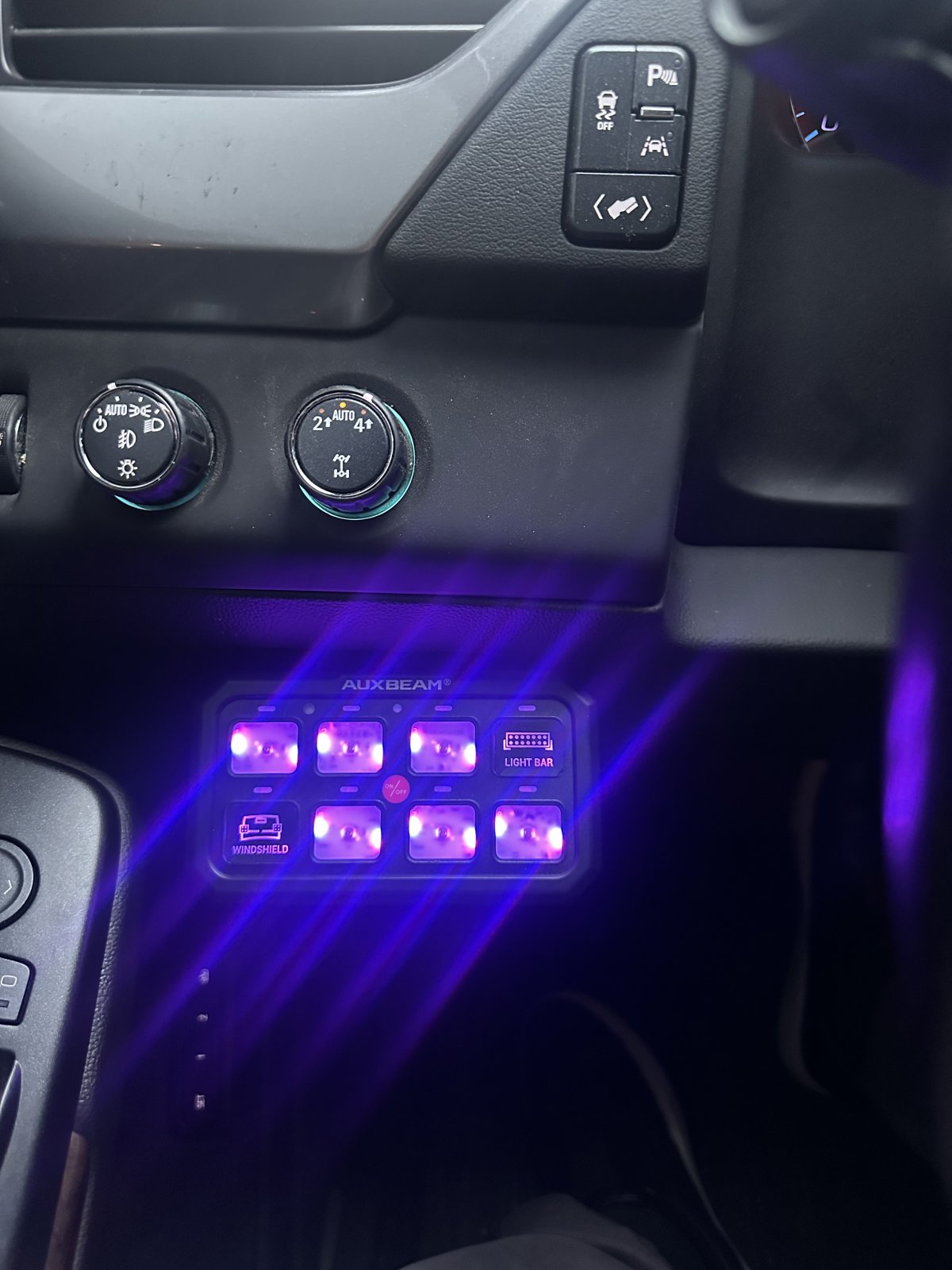

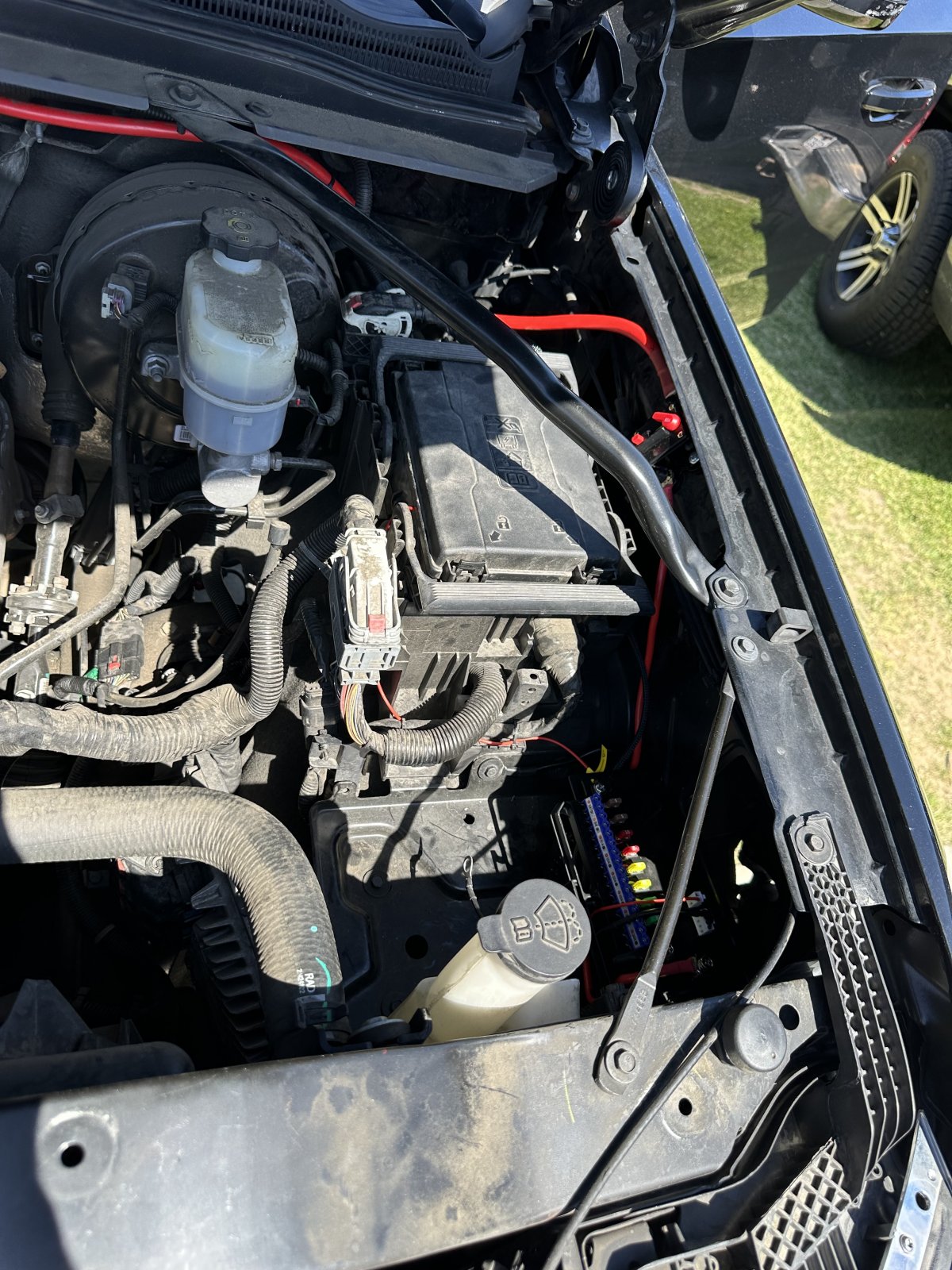

The wiring is installed into an Auxbeam RGB RA80 switch panel. Which was mounted in the location where the second battery would be. Ideally the Auxbeam (or any switch panel) would be as close to the battery as possible, however I did not find any feasible location. There's plenty of space at the driver side battery location (if you don't run a second battery). It is also close to the fuse box when will be utilized for the install.
The battery cable which came with the Auxbeam was too short, so I purchased an extended cable from Harbor freight.
There is a single power cord that I fished through the firewall which then attaches to the control panel. I installed the control panel to the left of the steering wheel. However I am considering relocating it, as I have hit it a few times with my knee getting out of the vehicle. It's a bit bright, so I personally prefer the unit out of my line of sight.
As far as the Auxbeam itself, it's a pretty decent unit for its cost and functionality. I also have ditch lights wired to it.
