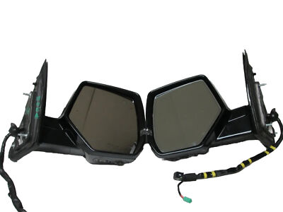

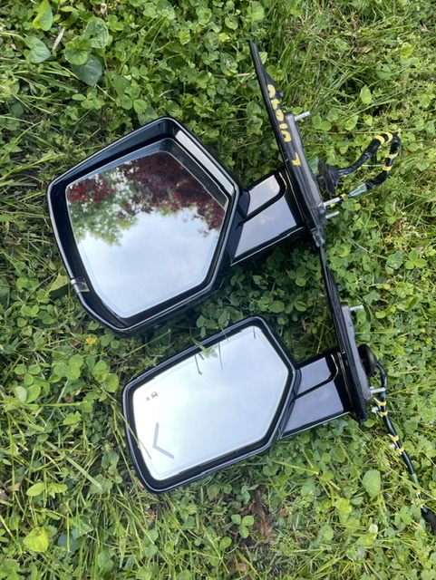

If anyone is interested this is the seller I bought my escalade mirrors. They are like brand new. I bought 1 on their ebay store and 1 on their website. Both shipped fast.
www.priorityautoparts2015.com/
Now I need to install them on saturday.
