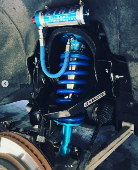

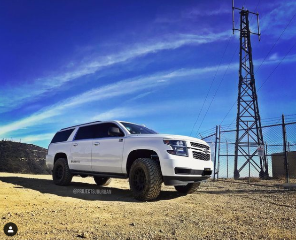

Not sure if this guy is on the forums, but on instagram @projectsuburban
He has king 2.5, baja kits(now camburg) UCAs and clears 35s with trimming. This is the exact setup I want to pursue in the future for my build. Here are some pics from his instagram and the last one of my truck on 33s:
yfIT47QDgfUrAjk4SOzEVvN153zEyEg4jwqKbREP-Wb9uoo7O8qXCdpH7dosyl32fuQjV9ehj4m9qnsrINOdghqA8zn9FOJr4wVro18WFWad2De85JP3_ZYHR5KF2jEmG21RB1sa9xbY9QoDU4BFQpp0bq-v2kngrKmTJvDEHMOsZ3ZRP_zGTA6aAUGz-iZVe6rqQdTYDe9q8Bi_940oNkT_ahsOHCTLQM6SaND36HS6rMB3JGC67XavBkRHO6TK0-JPgktrj6N0j2G9-Bfht-_lN8SQmS7kZlT6nNb2xL10yDLkR3hz3EAOq-NnEf-VvGlCrOyM47PgoiAljcMlzw8CXuRtTba1Afd9Ybm-QdHri19h9W_RvKqeWzo63ovbJTbkbHOsHgPz5CZYsg87-NcoFmDdMZKi_fhOLpgq62bC2VDMIonPo04Z-k_RHDKGjqo-IruoPJKU2KfcW5izxyQYfLNNQDIJxfs68Y4pI3bue1tZDE4N51ps3nKo02retJV4qBnlaV2gE0rcJlnvFbGd-_bR4lfBxSu4-AFHF8fEO6M8d-JgEac9OVND3bkAnPQ8KaFAMpijQfYF5AvUKdF3u0eY2gBJnjeQenVSqtLDMYEWDnQ-G5ef1_HB8uD9CEPEYctuG478hHZYXRjpb-NWpi-b4mxsDzC1NaWQBn6YA8KoBezYwQo2JB3Mmw=w934-h700-no
That’s pretty much what I want to do, Tons of free travel, upper and lower uniball arms and I don’t mind pushing my front track out 2” on each side. I was looking at Baja kits and Icons mid travel kits.
glad I could see the rear set up too, I was thinking the Z-71 and 2” spacer setup also maybe some limiting straps for droop and upgraded trailing arms for articulation. I especially like that I can fit those piggyback shocks in the stock location.

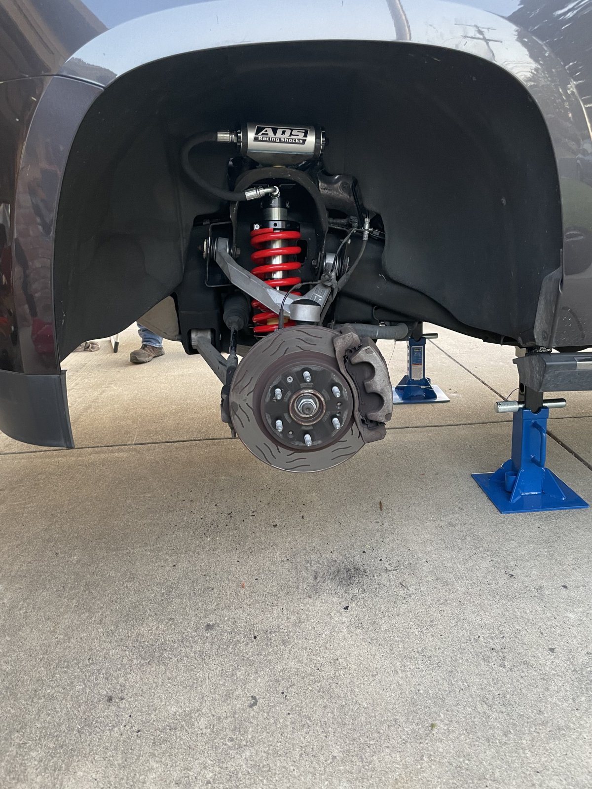

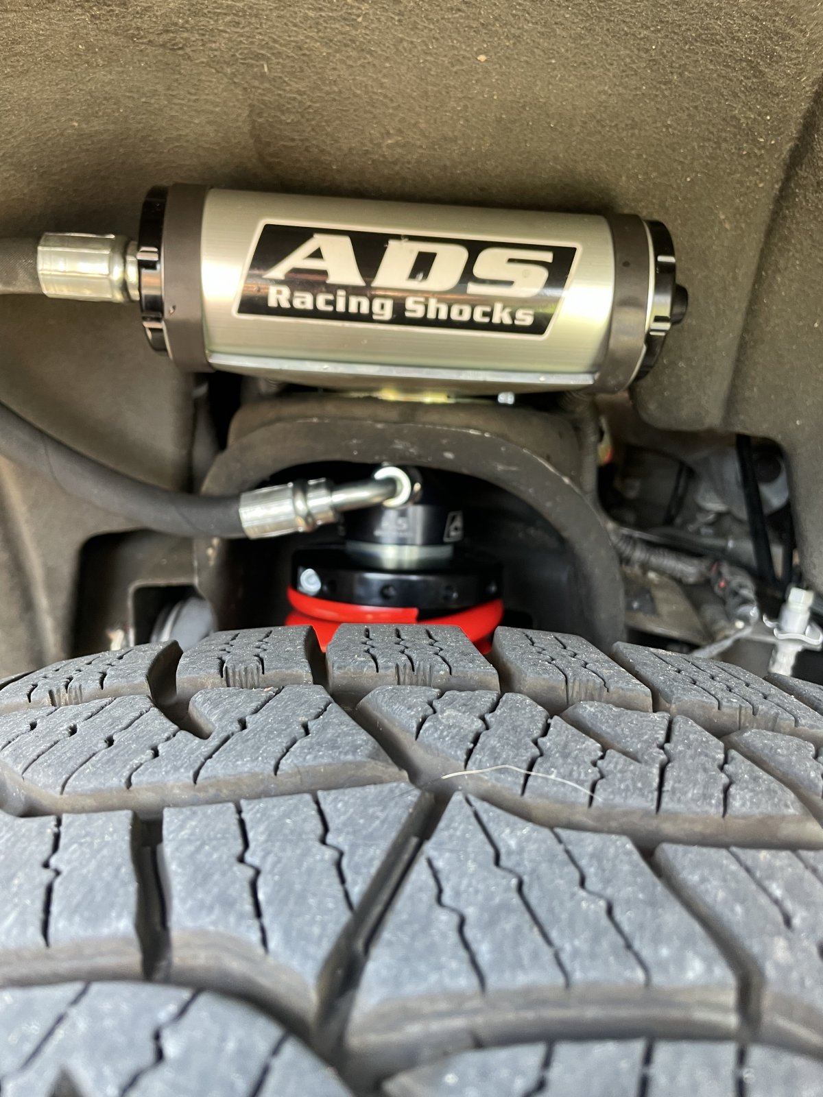

I went with the ADS stuff. I had to dial back the preload quite a bit to match the z71 springs. (And z71 bumps).
These are 600# springs on the coilovers.
Curious how much needs trimming to fit 35’s
I know some guys back off on the preload and add anywhere from 1/2”-1” spacer to help out.
That stance looks good right there, I’ll figure out trimming once I get the new rims and tires delivered. Will be interesting.
