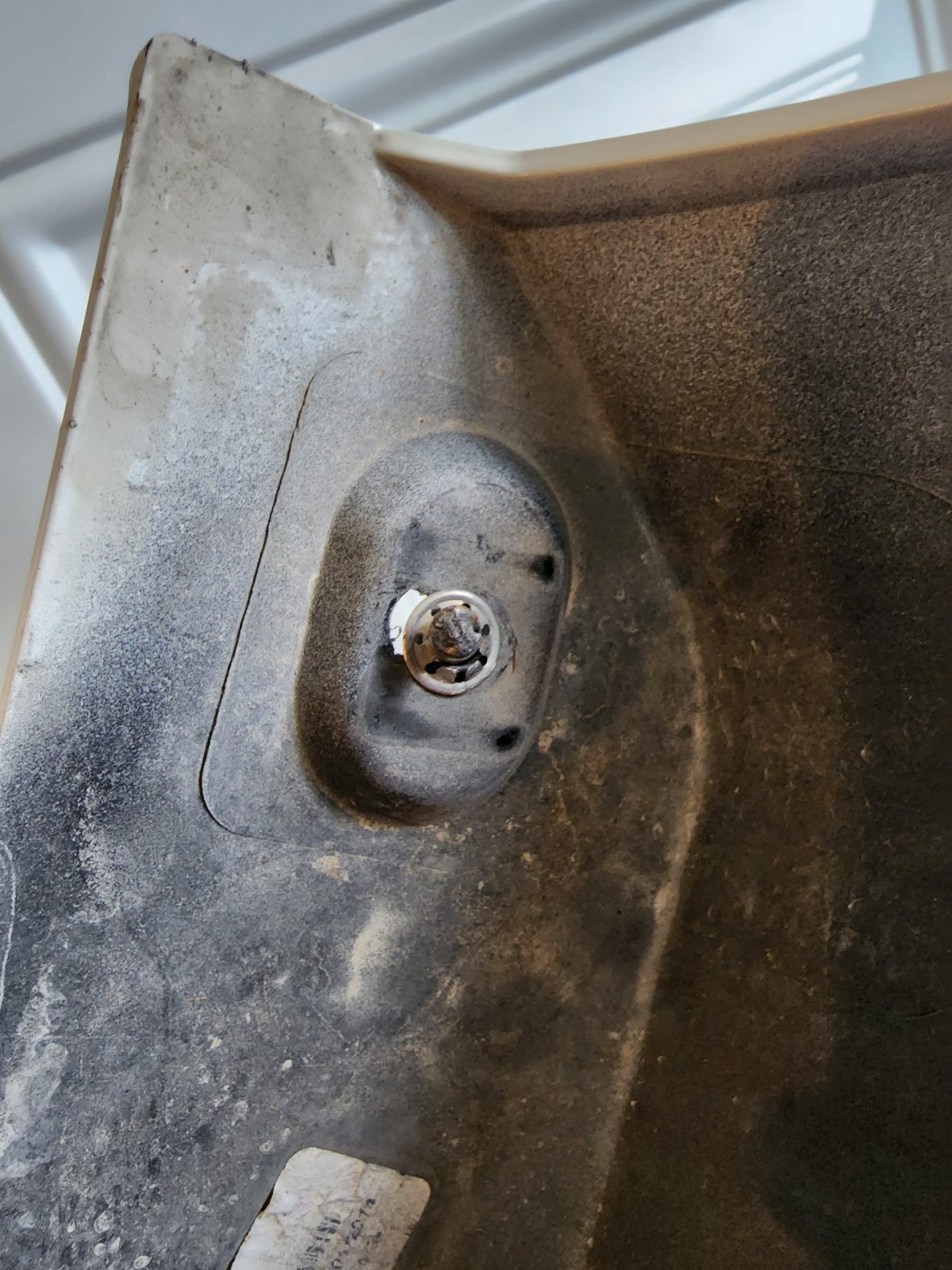

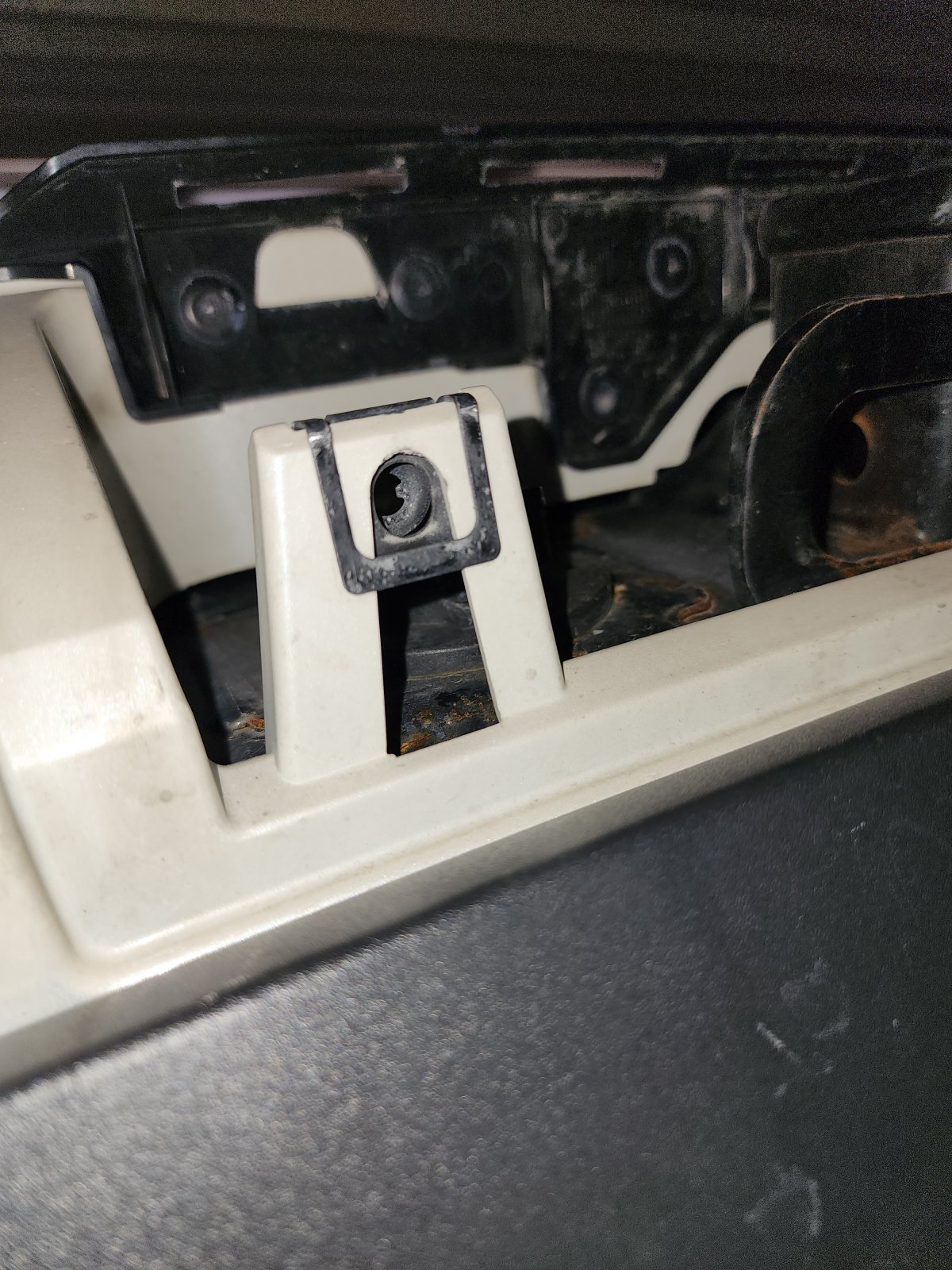

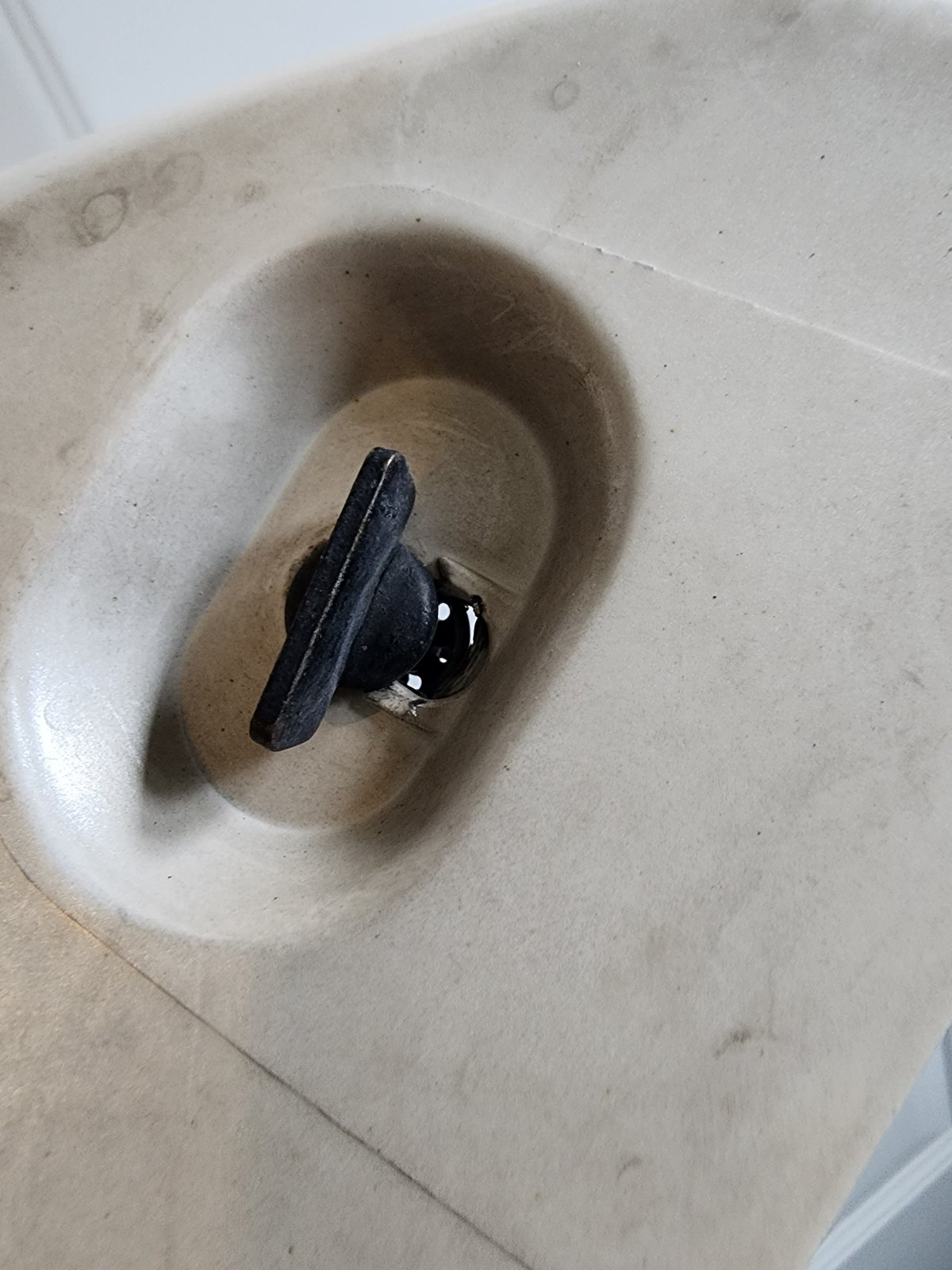

I have 2015 Yukon, I think these will work. Here's pics if mine. Could also try the clips below too. Make sure your retainer clip on is compatible.i posted that pic too.

Cover(paint to match) GM#23142973, Bolt x2 GM#11612235, Retainer x2 GM# 11612237, Nut x2 GM#11612236
