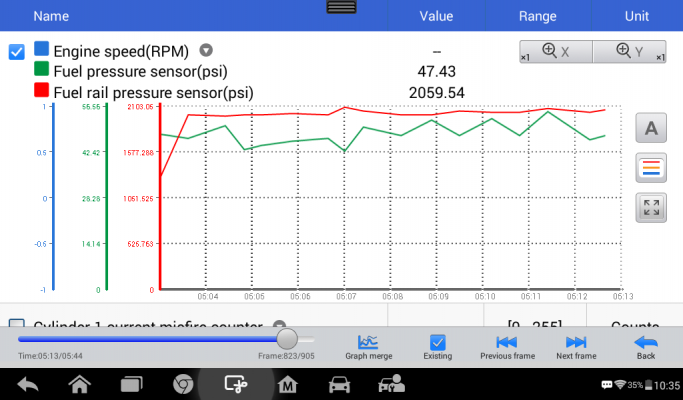

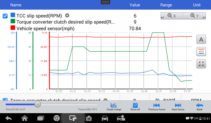

I have attached an image of my most recent graph recording of some PIDs while this issue occurred. Note the circled area since the screenshot was taken while the problem was recreated.
Anybody else have this issue or know what to check for? I included the MAP sensor reading on the graph since I saw one person with this issue reported a faulty MAP sensor being the issue.

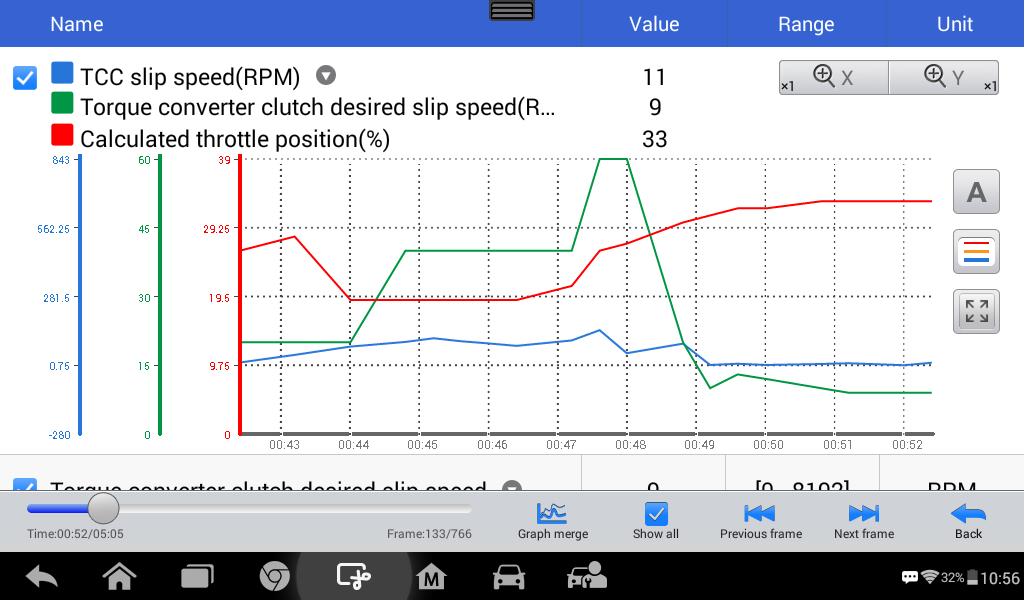

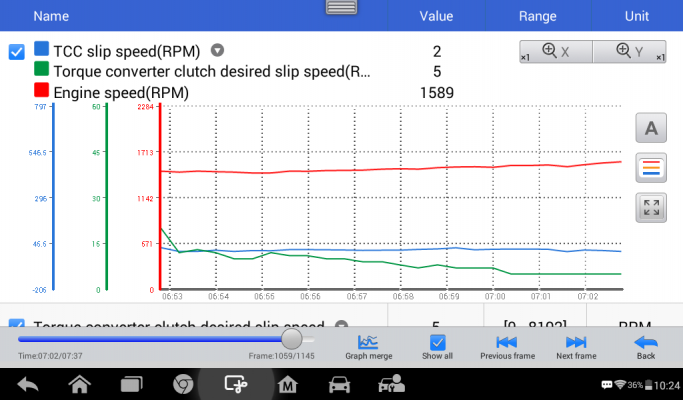

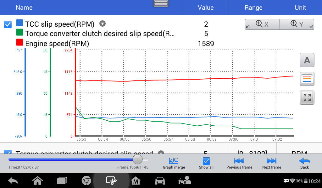

Hi! I’m really not sure about it being the transmission. I went for a test drive monitoring torque converter slip and froze the data when I experienced it. Here’s some screenshots. Note the data values above the graph.

Those graphs show the TCC is behaving as expected, so whatever is causing your shudder/vibrations it's not the torque converter clutch and/or TCC electro-mechanical circuitry. If it was, your slip speed would be much higher than it's reading and the graphs would look completely different.
That said, it is interesting that the shudder goes away once you downshift.

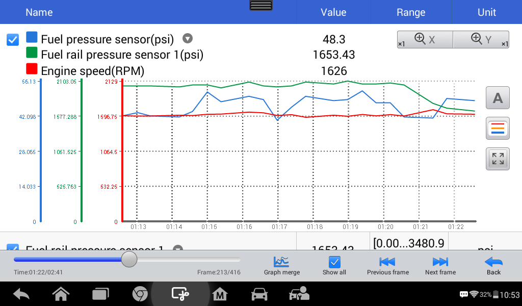

In my first post I included a pic monitoring fuel pressure. I’ll attach another one here, showing the freeze frame values at the top when the issue repeated. I have a 6L80. Thank you

Interesting...If you only started noticing the issue after you replaced the injectors, i'd be inclined to think one or more of the injectors are defective in some way that isn't showing up in the data or something got missed or damaged during the repair.

post up what the MAF is showing when the problem occurs, fuel pressure appears to be within spec (at least what is being commanded anyway)
Sure thing. Will do. I was under the impression that I was monitoring the fuel lift pump pressure output from a (low pressure/lift pump) fuel pressure sensor. Is this not the case and it’s actually just the commander pressure ? Do I need to connect up a fuel pressure gauge?

a physical gauge is best to rule it out for sure, just stick it up under the hood so you can see it through the window
and may as well do a fuel pressure drop test at the same time since you replaced the injectors

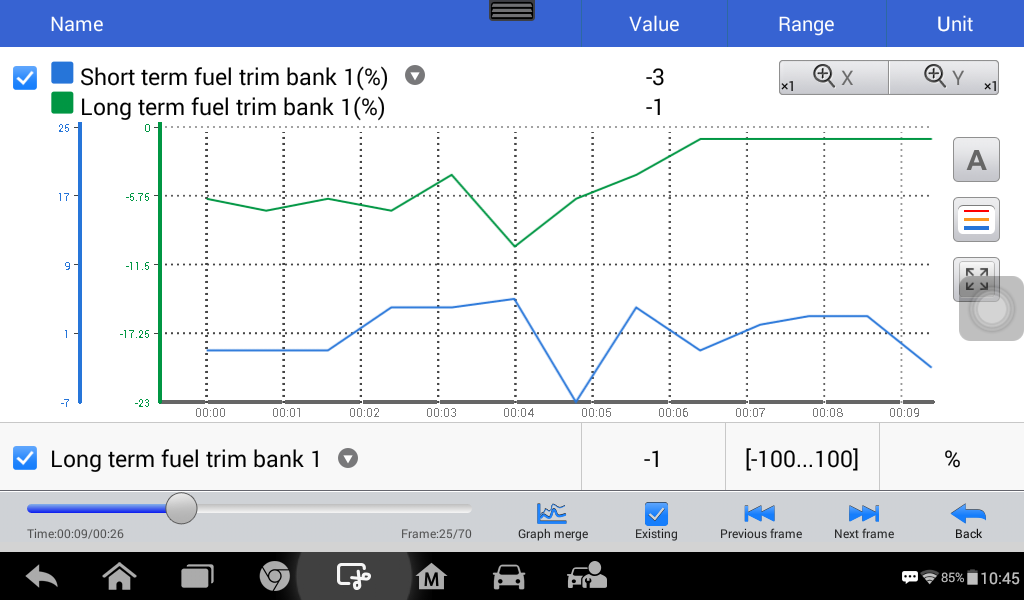

I did multiple test drives last night. On one of them I monitored and reviewed almost every parameter related to the the AFM. Cylinder deactivation was never engaged when I was having the issues. No faults occurred. Both the dash and the parameter agreed that it was in v8 during the shake. I have noticed that it occurs close to 90% engine load and above.
I haven’t yet connected my fuel pressure gauge to verify that the (low pressure) fuel pressure sensor is accurate. I verified in the service manual that the measured fuel pressure is the output of the fuel pressure sensor near the tank, after the pump. The commanded fuel pressure is a separate parameter labeled “desired fuel pressure”.

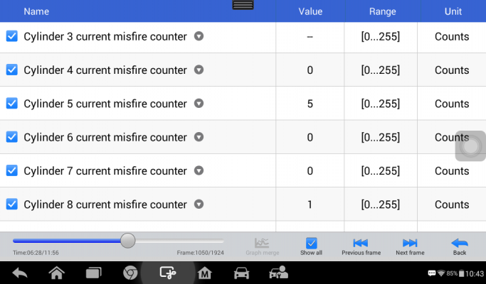

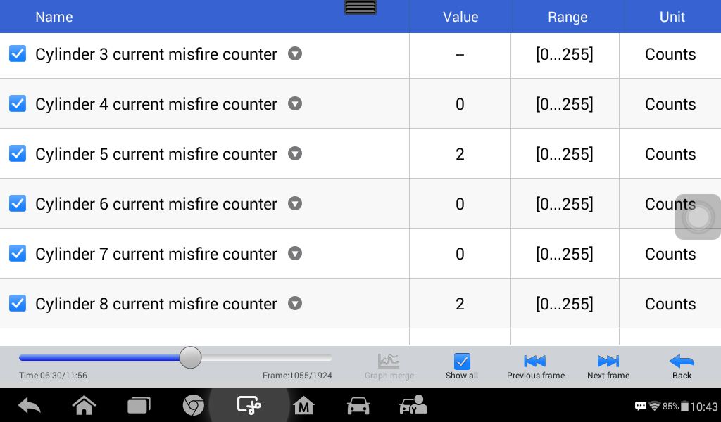

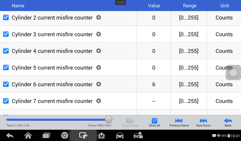

During another test drive, I got a p0300 with a flashing MIL. Freeze frame data showed no misfires(?) - a test drive watching misfire data showed just a few small misfires here and there. Report and screenshots of misfire data at time of shake are attached.
