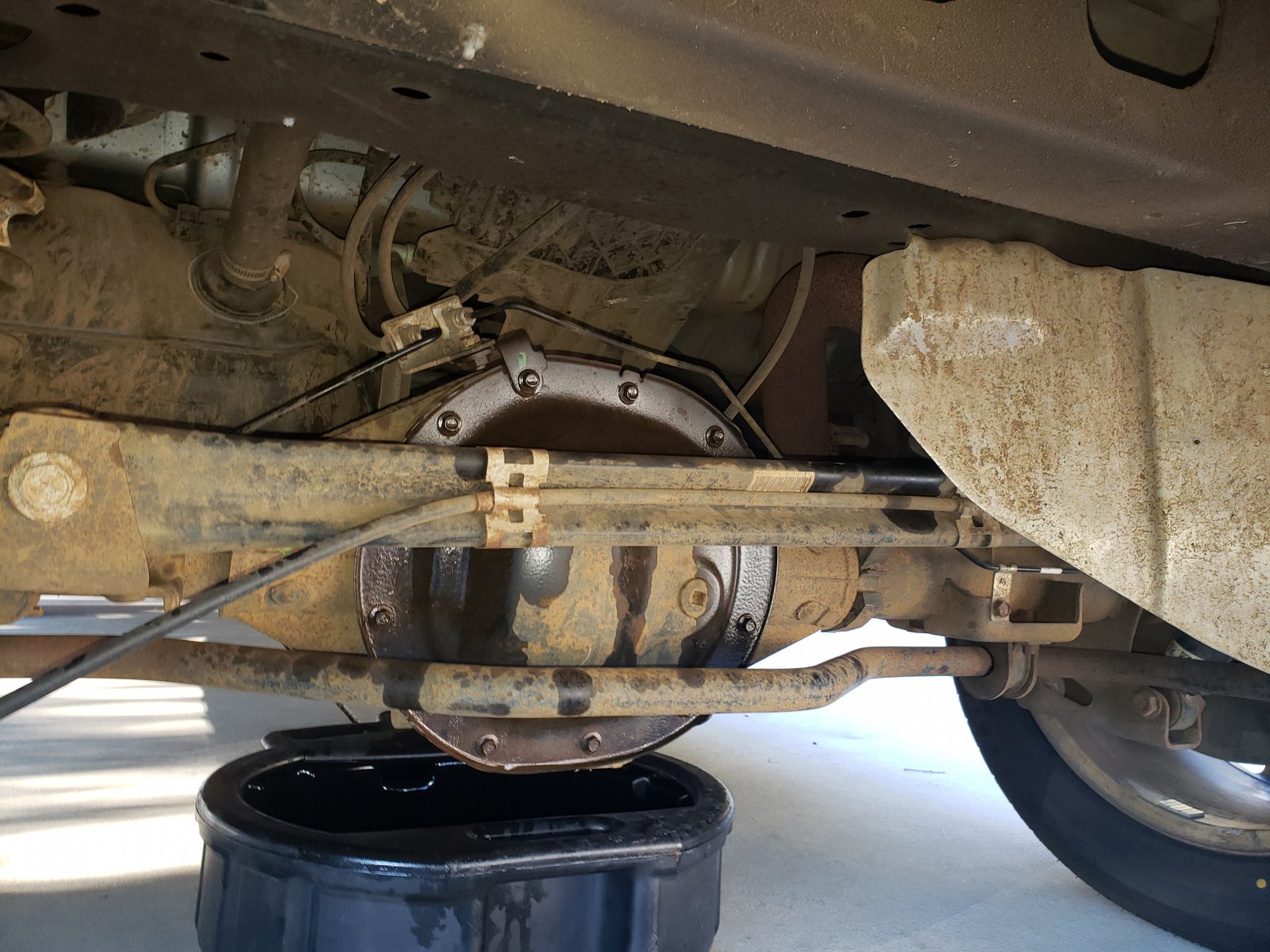

2017 Tahoe Premier 4x4, replacing the rear differential cover with a solid aluminum Mag Hytec 12-9.5.
However, it hits this crossmember, circled in the picture attached. What is the name of this crossmember, and do they make aftermarket replacements that go around thicker rear diff covers? Thanks

It is called a track bar or panhard bar
there are some aftermarket ones out there such a QA1 which has a little curve to it but no telling off hand if it will allow enough room to not hit a mag hytec, the mag's are pretty thick you may have put on the one for a pickup which will fit the suv but is the wrong one, or may take modification.

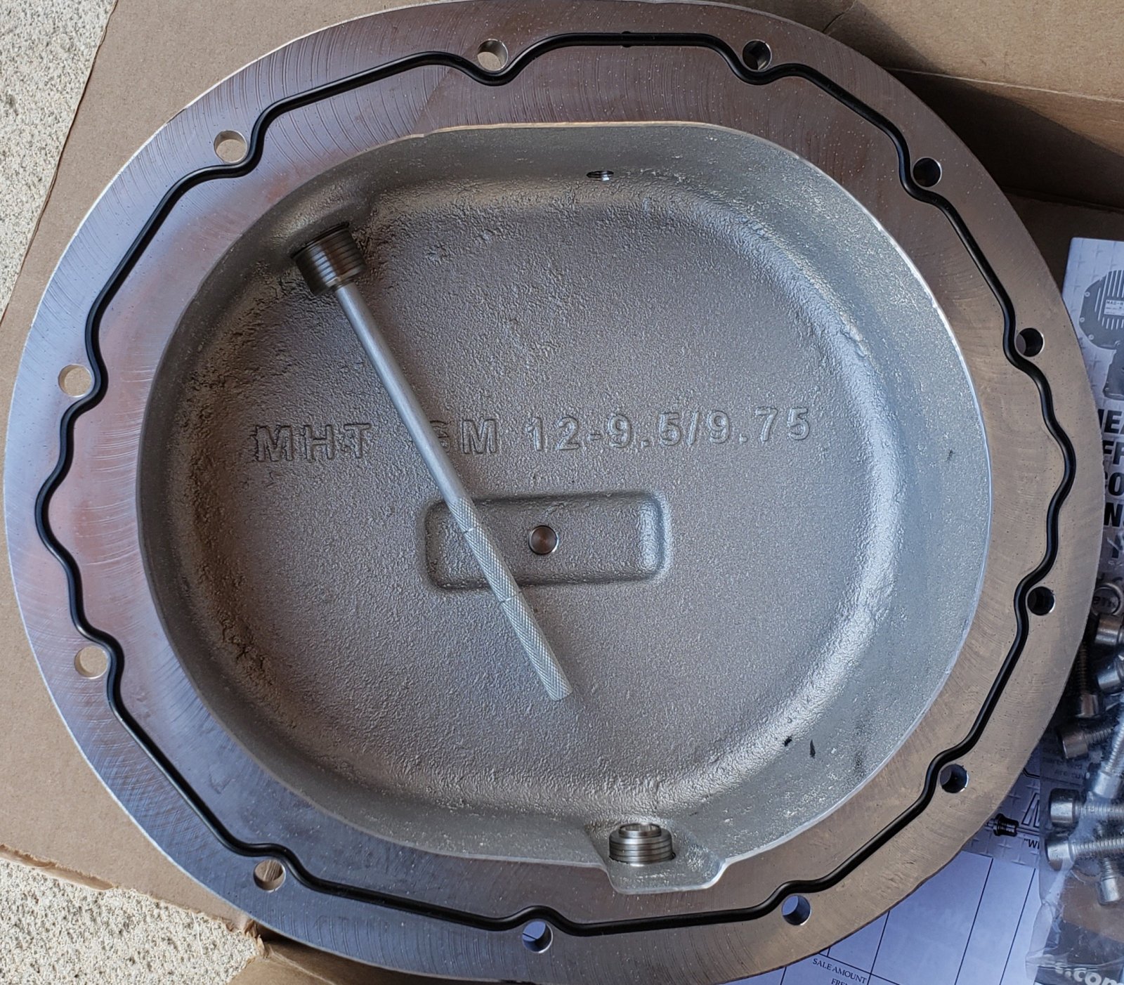

No I have not done my research on this. Here is the inside of the Mag Hytec GM 12-9.5", and you are right it has a flat back, compared with stock. I remember reading something somewhere about extending a vent tube up higher to prevent spill out or something? is that the same thing going on? I forget exactly what they were talking about, but it seemed strange. So what's going to happen with excessive aeration? thanks

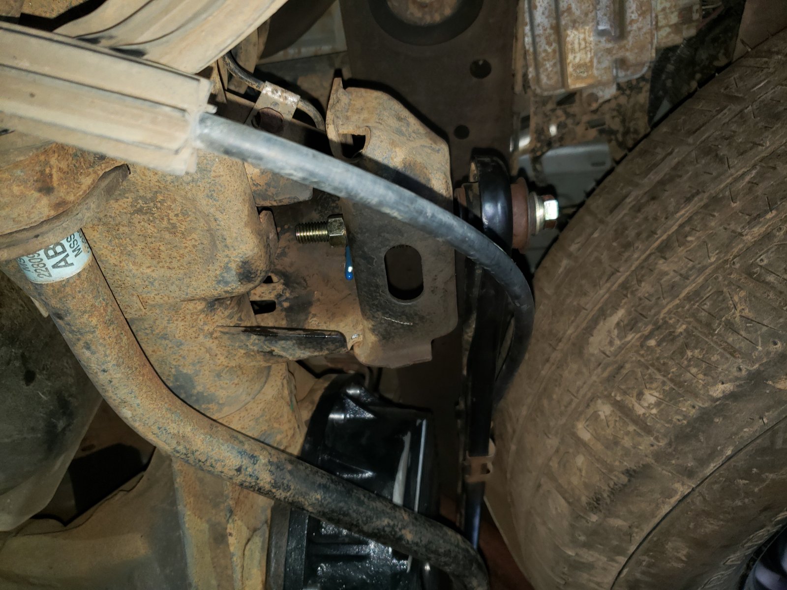

I am ashamed.. but I bolted the track bar to the outside of the axle slot with a longer 1/2" 6" grade 8 bolt and nut. (also 1/2" washers inside the bracket for support)

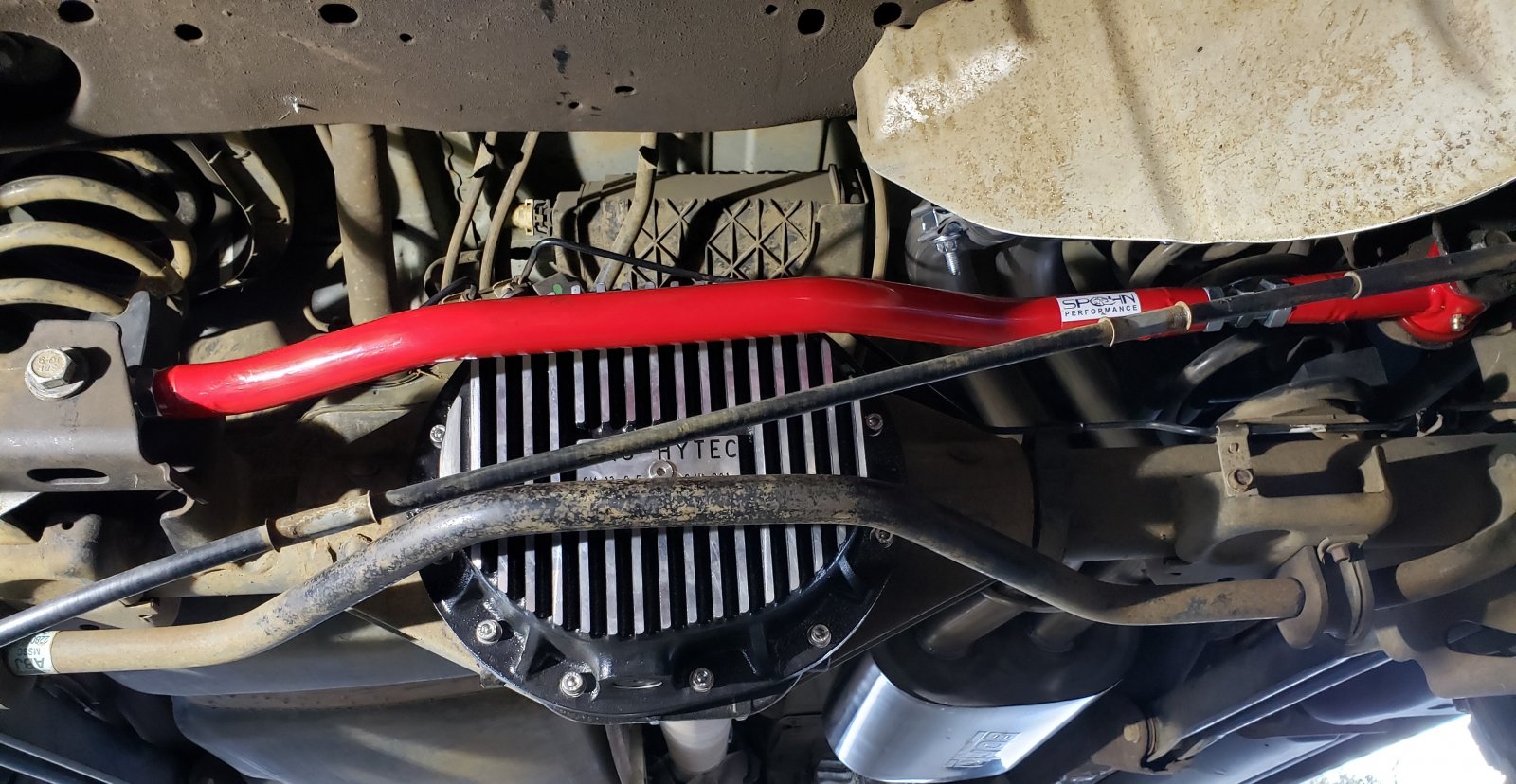

So a company Spohn https://www.spohn.net/ has a trackbar/panhard-bar that fits the 2017 Tahoe Premier 4x4 with Mag-Hytec 12 bolt 9.5-9.75" diff cover. It has a bend in it that goes around the larger diff cover, and also is clear of the sway bar.
In case anyone needs one of these, even though they are not listed on their website yet (they said they needed to update their website), you call them and order one from them on the phone. This particular one was $211 I believe. see picture. thanks all

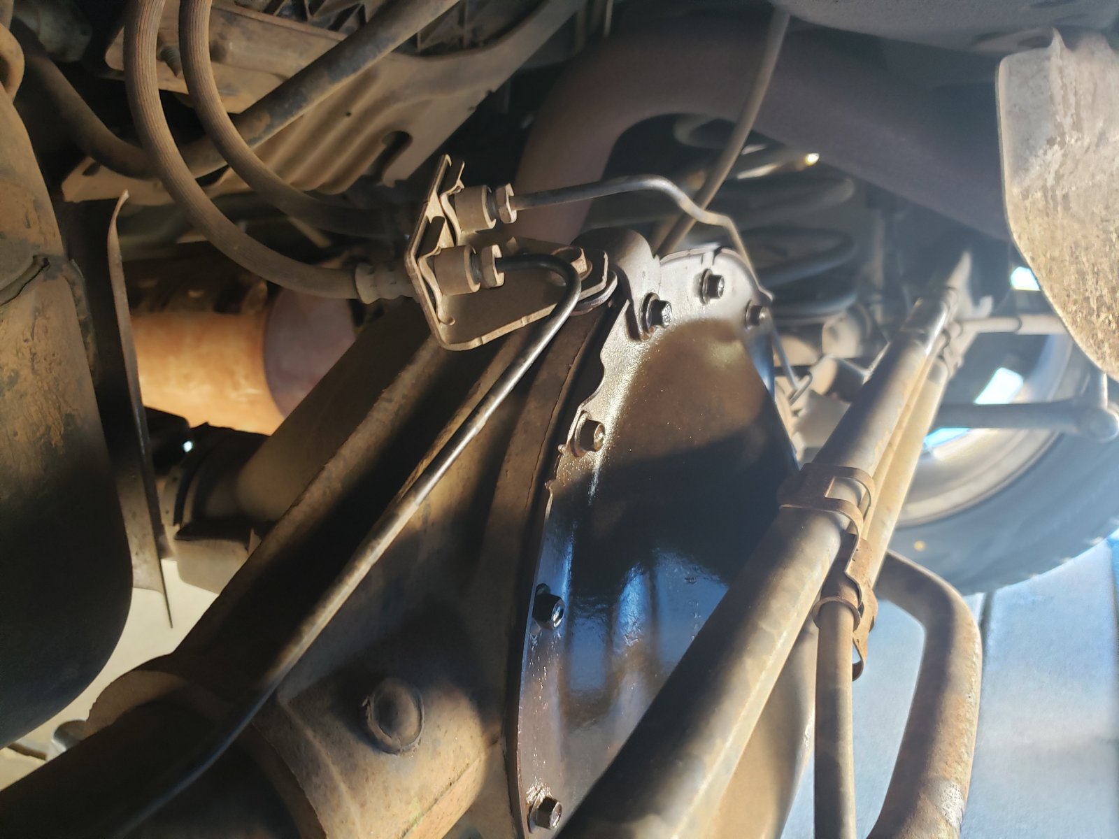

some more pics for anyone's future reference on the topic:
Picture of old panhard bar/trackbar bolted to the outside of bracket, in order to fit around large AM rear diff cover.
Picture of old panhard bar/trackbar on old OEM diff cover.
