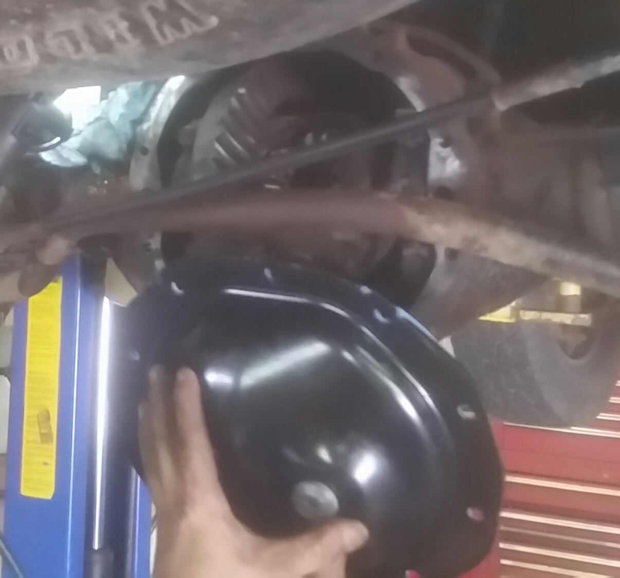

driven_mad
Jun 5, 2019
14
Well the bolts came out even tho they were rusted down to 12 mm but a brake line cracked due to the rust
