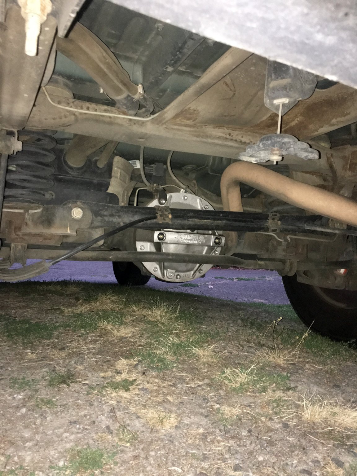

Is anybody using the GM 10-8.5 Mag-Hytec rear diff cover on their Tahoe? The only thing I'm concerned about is fitment really.. Does it fit with the factory rear sway bar in place? Doesn't look like there's too much clearance back there.

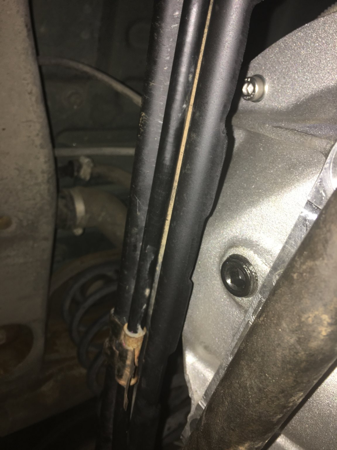

So I got under there this morning and was checking to see how much room there actually is. The Mag-Hytec cover is listed as being 3.25" tall. I cut a piece of PVC pipe to that exact length and tried to fit it between the stock cover and the bar going across (panhard bar I believe it's called). It's a no go.
I need to either find a cover that doesn't stick out as far or find a way to either modify that bar or find an aftermarket bar that provides more clearance. It would be cool to find one that is shaped more like a sway bar or strut tower brace with a slight curve towards the rear instead of being straight across. All it needs is maybe another 1/2" of clearance and it would be all good.
If you guys have any suggestions please let me know!

You're not going to get a lot of answers because most just use OEM or a replica of it, so I'll help the best I can. I have a 2002 denali and I went through this same process about 6 months ago.
You've already found out theres no way a mag-hytec would fit. After I realized the Mag was a no-go, I looked at G2 covers, called them and was told there was no way any of them would fit it fit.
Although a few months later (After I was already done with my diff cover) I found this on an avalanche forum:
Its a G2 Torque diff cover with a qa1 panhard bar and clearance
After that I looked towards the PML cover which was heavily documented that it would fit our rigs but I couldn't justify spending that much money for it and I didn't like the way it looks.
I finally ended up at the TA performance girdle. The cover provides extra fluid capacity, actually has a drain plug (what a concept right?), has two load bolts that reinforces the bearing caps, and its hands down a work of art IMO. My research led me to the third gen forum and it received a lot praise claiming it helped their rear end live longer. As a third gen owner knowing how weak the rear ends are, that review was all I needed.
I bought the low profile one (TA_1807A) and was told it fits no problem...Well it didn't. I had to grind one of the fins a little bit and notch the panhard bar a little bit. No major surgery but to weekend warrior who wants a bolt-on affair this may not be ideal. Maybe I was the one unlucky one whose didnt fit, maybe I was sent the og depth one, maybe they don't know their asses from...anyway, who knows. I am slightly concerned when I go low if it will clear a tubular panhard bar, but thats another day.

I'm guessing the qa1 panhard bar will give you more clearance to fit the ta, pml, g2, maybe even the mag-hytec. It appears to curve a little, but that's another thing to add to the list. I would give it a try but I'm gunna need an adjustable panhard down the road and I prefer Delrin bushings to poly anyways
