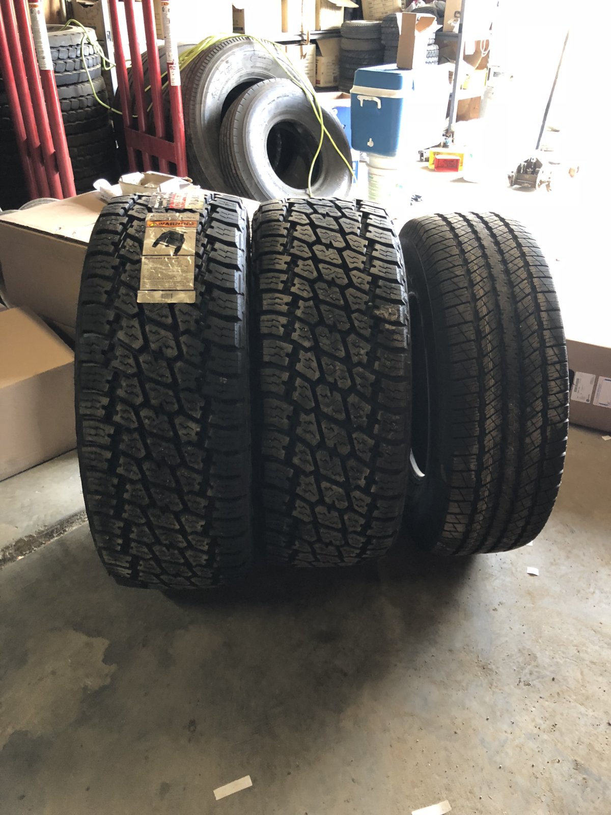

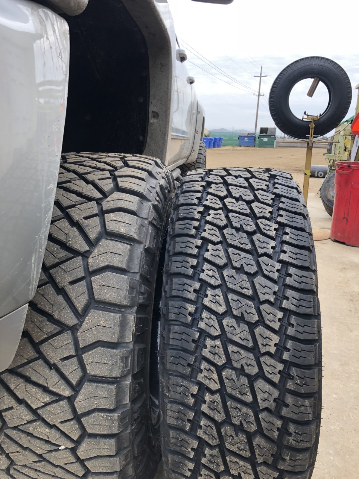

Yeah, I’ve always had my trucks nose high. Even my wife likes them like that now. Lol. Only running a 1” or 1.5” I can get but without moving the rear shock down. If I go with a 2” I’ll have to add the rest of the rear kit. I’ll have to make the call after swapping the 1” for the 1.5” in front. I was disappointed to find out my hypertech speedometer calibrater wouldn’t work with the adaptive cruise control. Quick call to then and they said there is a second option for it with an in line system. Ordered that, will report back.
cbraga
Dec 29, 2009
64
48

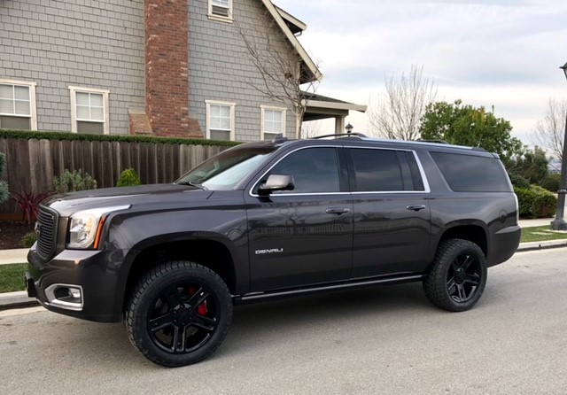

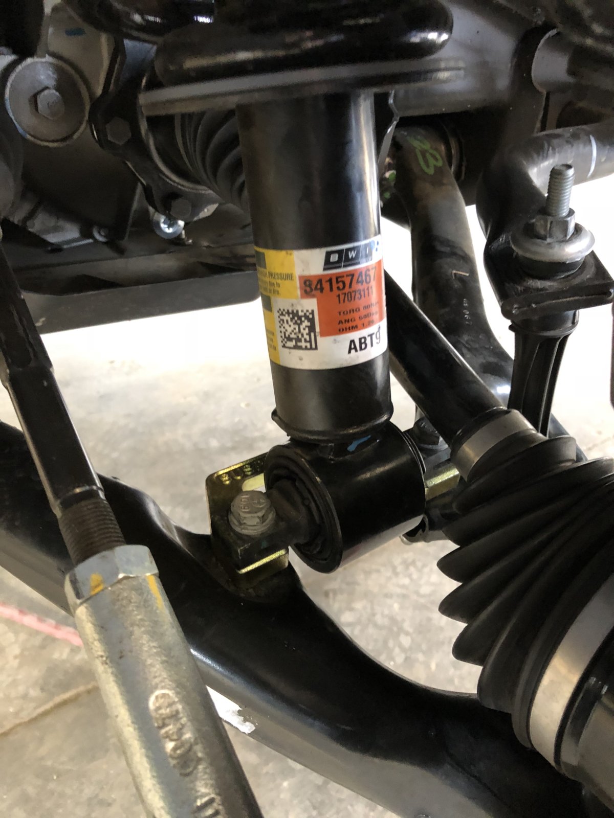

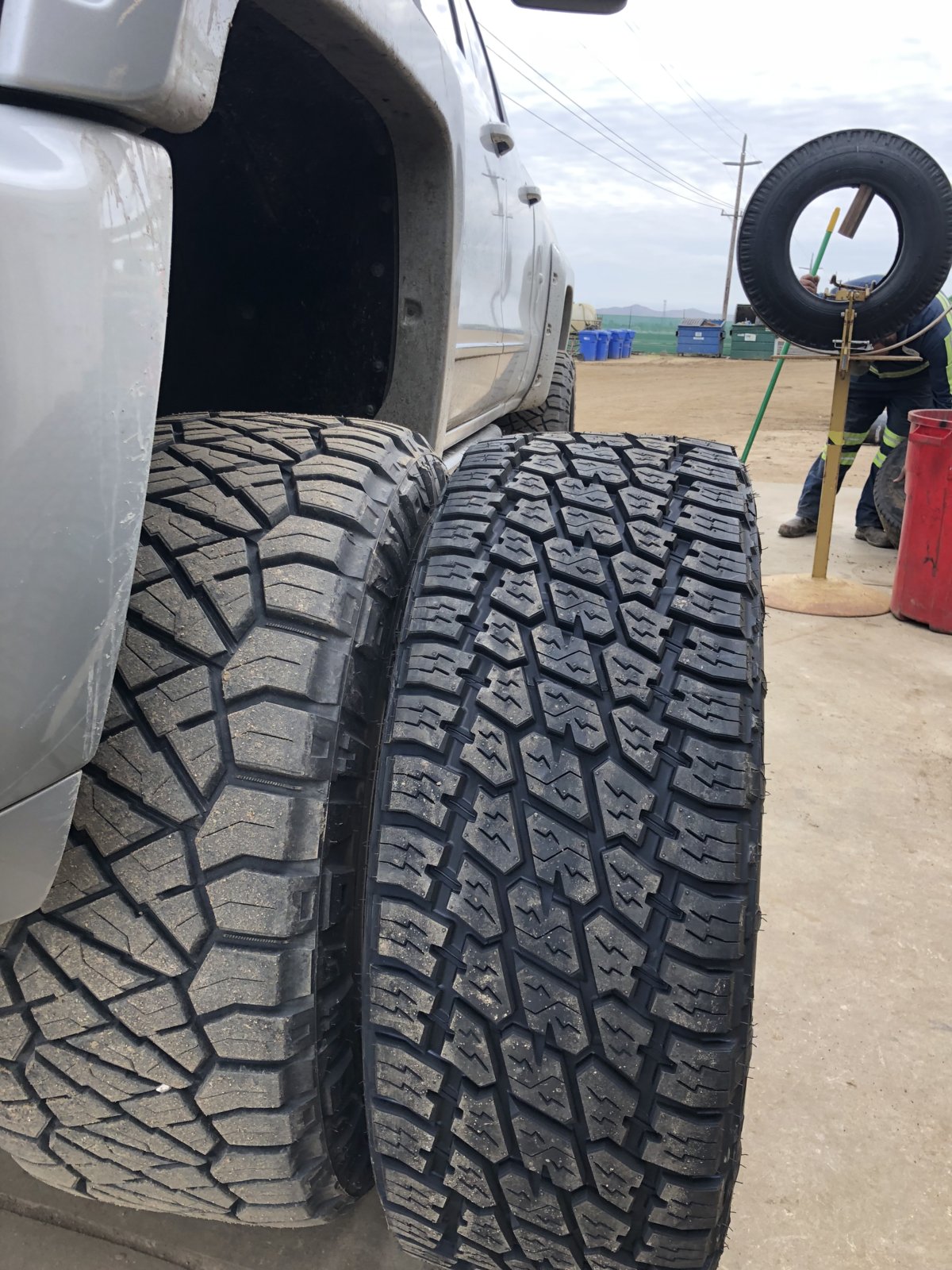

Surprised the Fabtech front spacer is so small. These were my tire choices. Stock, 285/50, and 285/55 r22. Nitto terra grapplers
You can see them against the 35” tires on my 2500

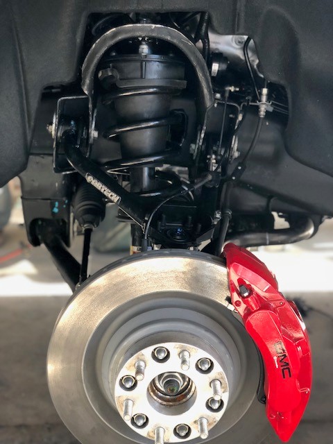

Cbraga, truck looks nasty!!!
Any pics of the front lower spacer you added and also what size wheel spacers did you go with? I am currently trying to figure out my wheel tire combo, the Fuel wheel/tires have been great except for the tires going out of round and wearing all weird(rotated every 3-5k) Thinking on painting my stock 22's and putting some 285/55's on them. Oh and you have any fender height measurements?
TIA
cbraga
Dec 29, 2009
64
48
TIA

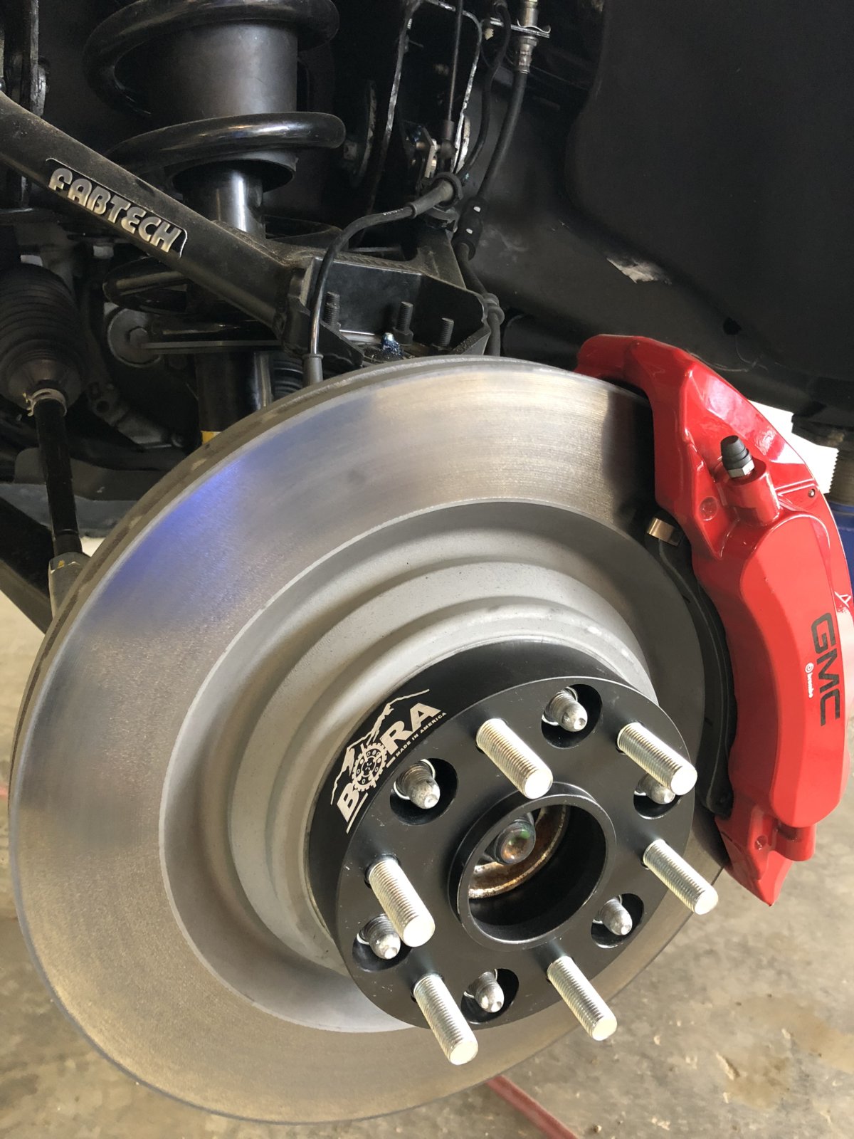

I used Bora 1.5” wheel spacers all the way around. The front is right st 40” with the 1” spacer added to Fabtech kit. The 285/50 measure out to 33.5” tall.

@cbraga Denali looks great!! Way to setup the front end a little higher and angles still look good. How does it ride now with the 285/55?
cbraga
Dec 29, 2009
64
48
Ride is great still! It did rub on the steps and the lower portion of the rear front fender. With the Amp steps and the 1.5" leveling added to the front seems fine now.

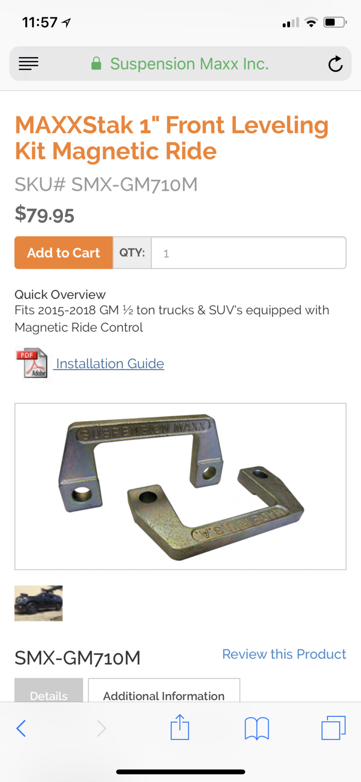

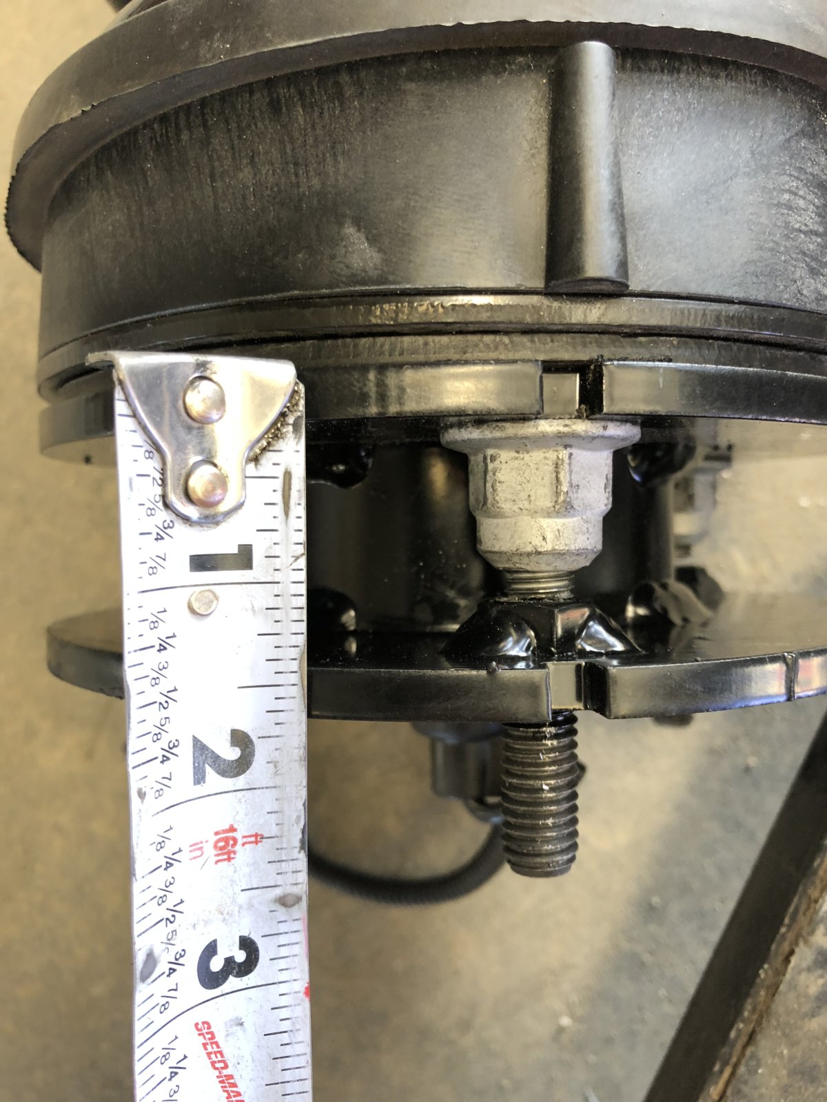

so you ending up going 1.5 suspenstion maxx lower strut spacer with the fabtech 4 inch lift ?
Adam10532
Adam10532
May 29, 2017
141
52

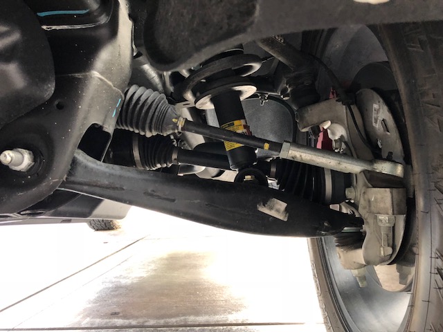

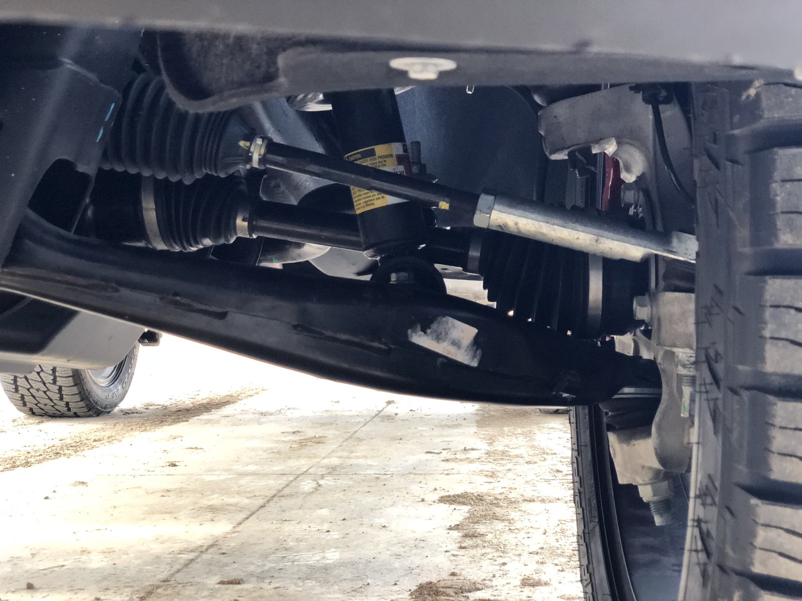

man i think will do the same the only reason i did not i thought cv angles would just be to much that's why I went with 1 inch, would you please post some more pictures of the cv angels and upper control arm .so no weird sounds or anything wrong so far with the ride quality? one last thing I assume your denali had a 323 gear ratio have you noticed major mpg and power off the line with those larger tires sorry I know it's a lot to ask but thanks to this forum I've done certain things to my Denali only because I've seen that can be done
cbraga
Dec 29, 2009
64
48
Okay, here are my CV angles. Drives fine around town, again its my wife's mall cruiser. Did not change gears, just added a Throttle Commander. Highly recommend it, simple and effective. Get your throttle response back!

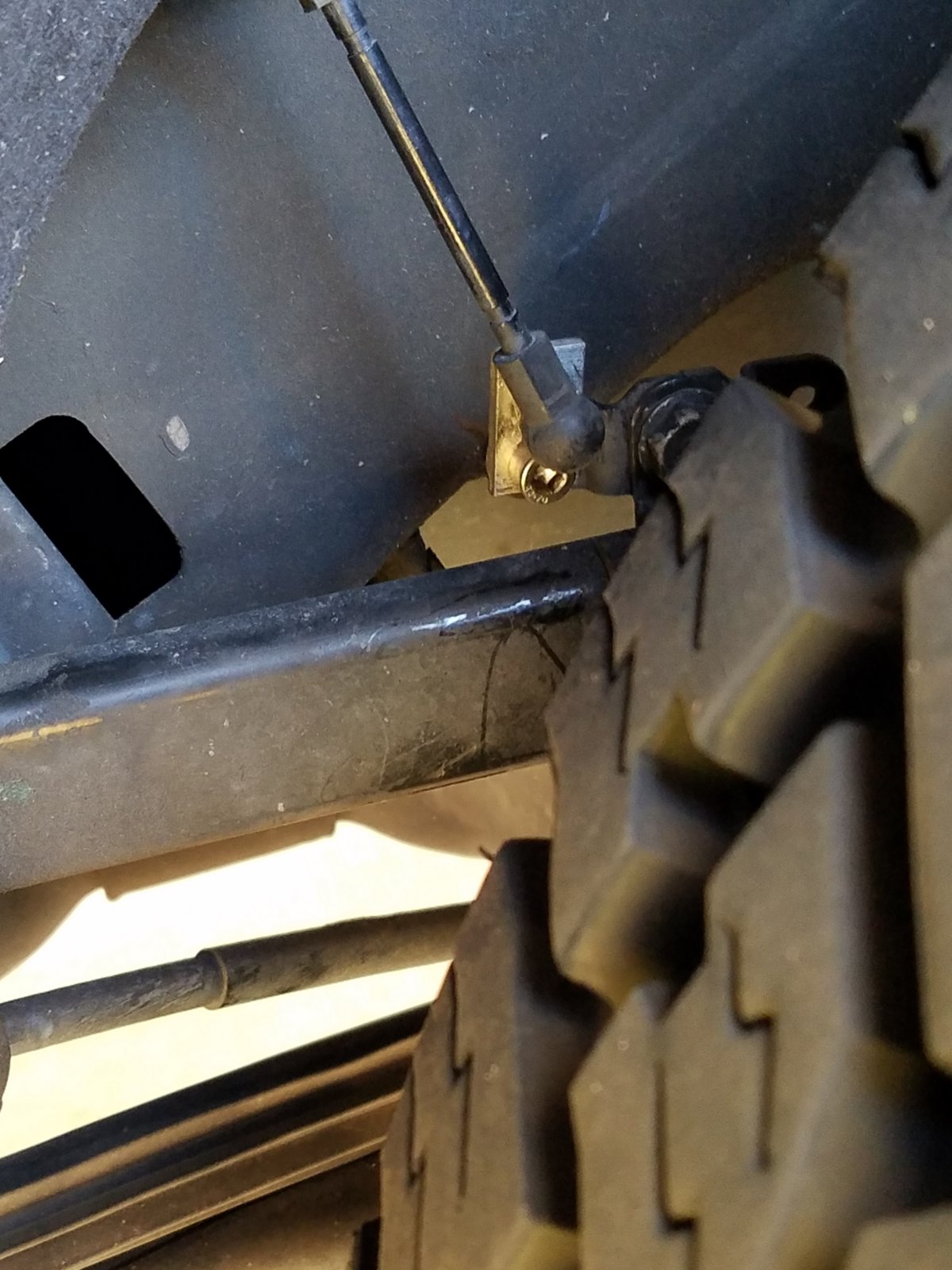

I figured I would post this here since it seems to be fairly current.
I ended up blowing an upper ball joint on my Denali this past Sunday, about 20miles into a 300 mile trip and 5hrs from home. Just a fyi, the upper ball joints in this kit are Fabtech specific and cannot be cross referenced by any parts supplier. I ended up having to overnight one from Fabtech so I could continue with my trip. So now I will carry a spare in the truck, oh only about 30k miles on the kit and really not beat on, a couple fire roads but mostly street driven.
What happens exactly did you hear a noise when that happened while turning how did you know they were done ?And I always thought that it back of my mind I'd have to buy a spare from Fabtech once this one gave out did they covered under warranty or did you tell him you had a bottom strut spacer had to buy a new one out of pocket

I was in a jam and just bought out of pocket, under $50 shipped so can't complain.
I heard and knocking going over washed out dirt roads and then my wife could feel it in the floorboard. It also started doing it on uneven paved roads. I was able to duplicate the sound by grabbing the top of the tire(12 o'clock position) and shaking it in and out, could hear it and could see it pop.

is this the front lower strut spacer id need to add to fabtech 4”? I want to achieve the 40” fender height you guys have measured with that combo.
Nokturnal
Jul 25, 2018
154
169
Thanks. I’m having the fabtech 4 kit installed Thursday.

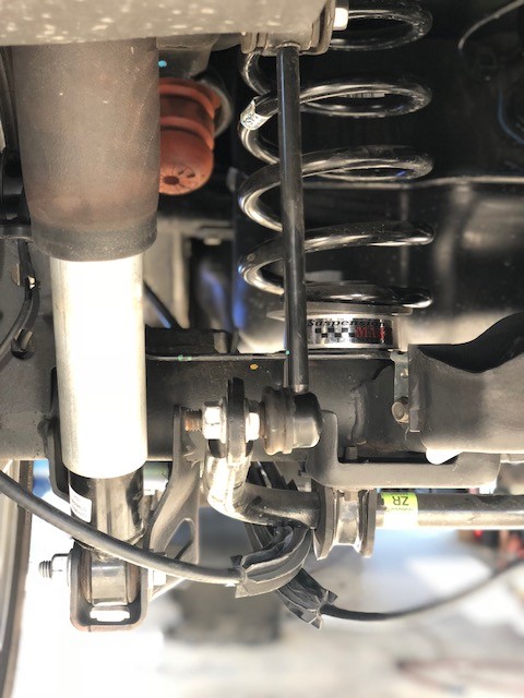

I called fabtech to order the kit with the 2’” spacers sent for the rear but they were Assholes about it and said R&D designed the kit with the 3” rear and that’s what they send. No swapping. I told them I’ve seen numerous installs and they’re all too high in the rear. They told me to do the install and call when I’m unhappy after looking and they’d talk about the 2” spacers. I ended up just buying the 2” separately so I’ll havw them on hand when the install is done. Had to talk them down from $80 a spacer to $25. What a pain in the ass.
My question is: what fender heights do you guys have with the 3” installed in the rear? If it’s 40.5-41.50 I think I’ll be okay with that with the front being around 40”. It doesn’t have to be completely level, I just don’t want the rear 1.25+” higher in the rear
Nokturnal
Jul 25, 2018
154
169
My rear measures 39” right now with the 1.5” Rear...is it safe to assume with the 3” from fabtech it’ll be 40.5”?
