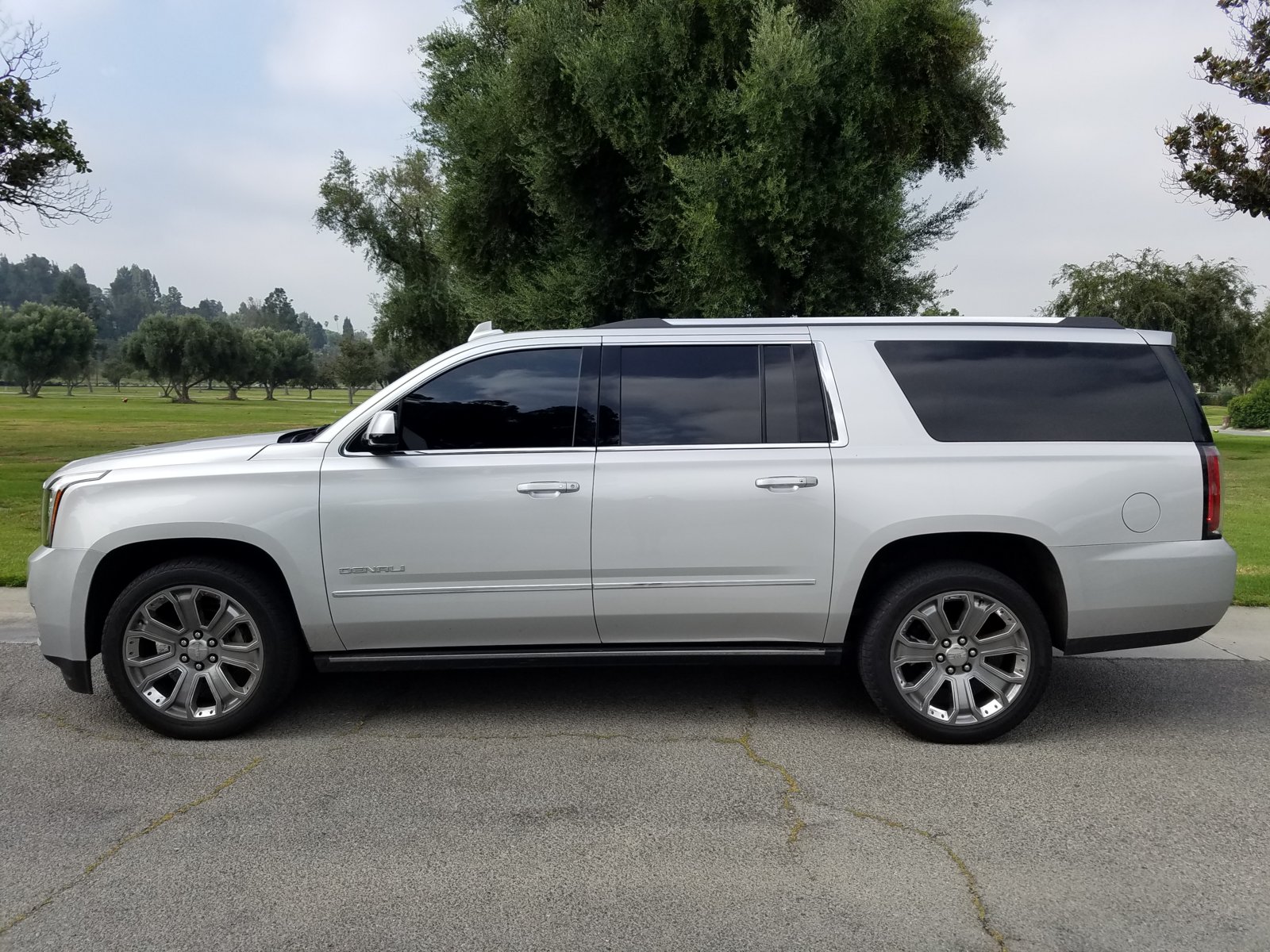

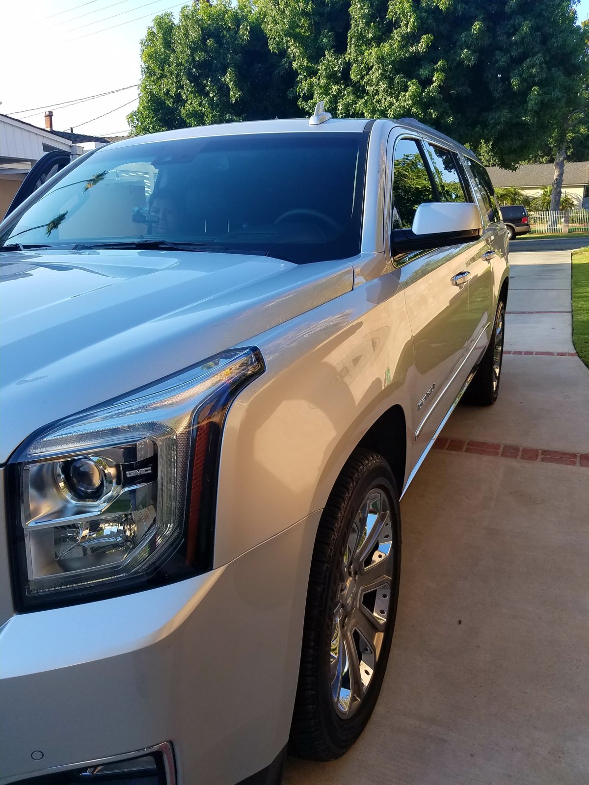

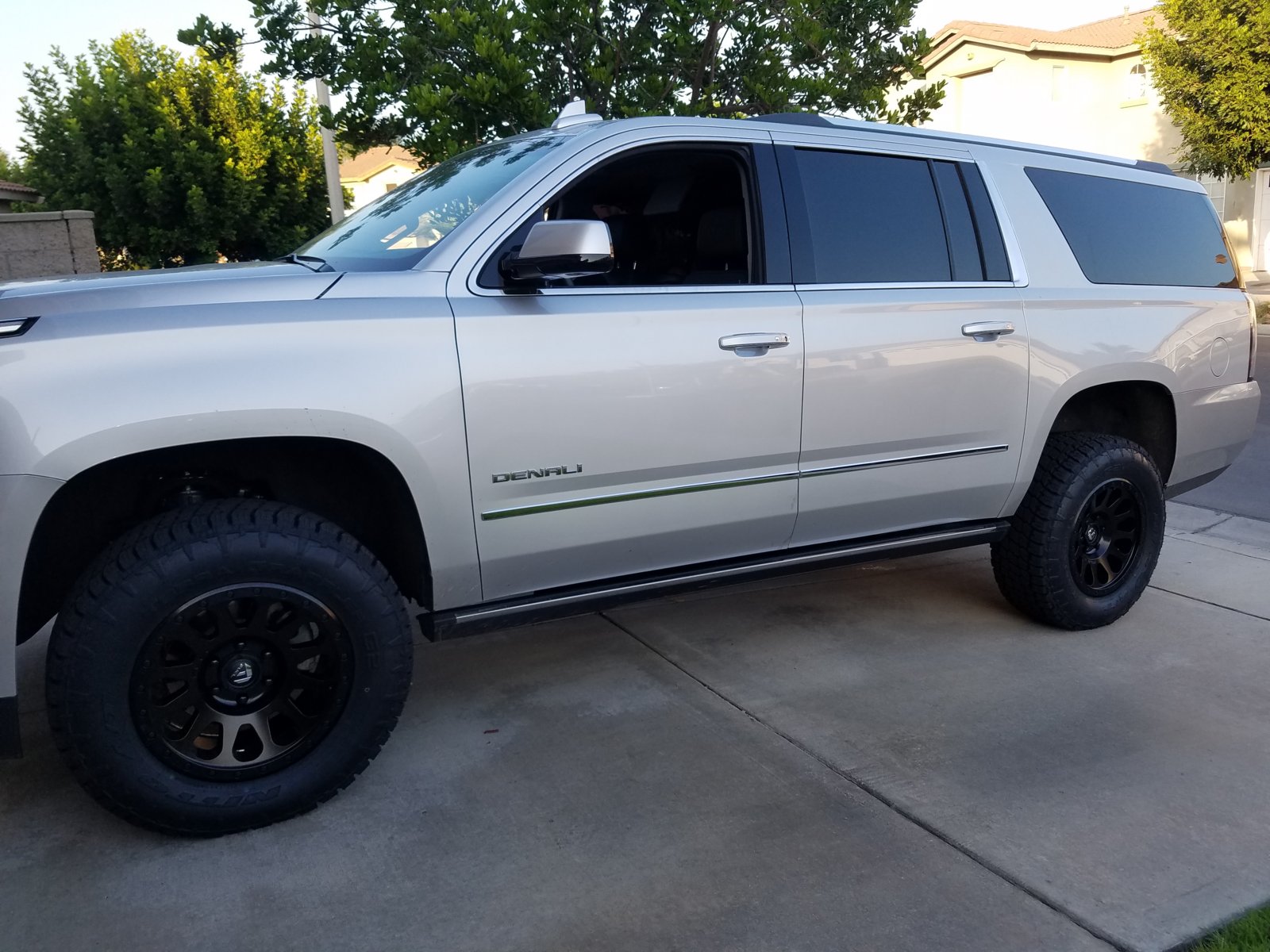

I just recently purchased a lift kit from Fabtech it's the 4 inch budget lift kit cost $740 I'm going to run 285 65 18 "32.5" tall and 11.22 wide on a 18 x 9 fuel Vector wheel all black with a Nitto Grappler G2 Tires pictures are coming soon .tomorrow having the kit installed from 4 Wheel Parts in Covina and So Cal . Everything out the door is going to cost about $3,678.95 here are the before picture

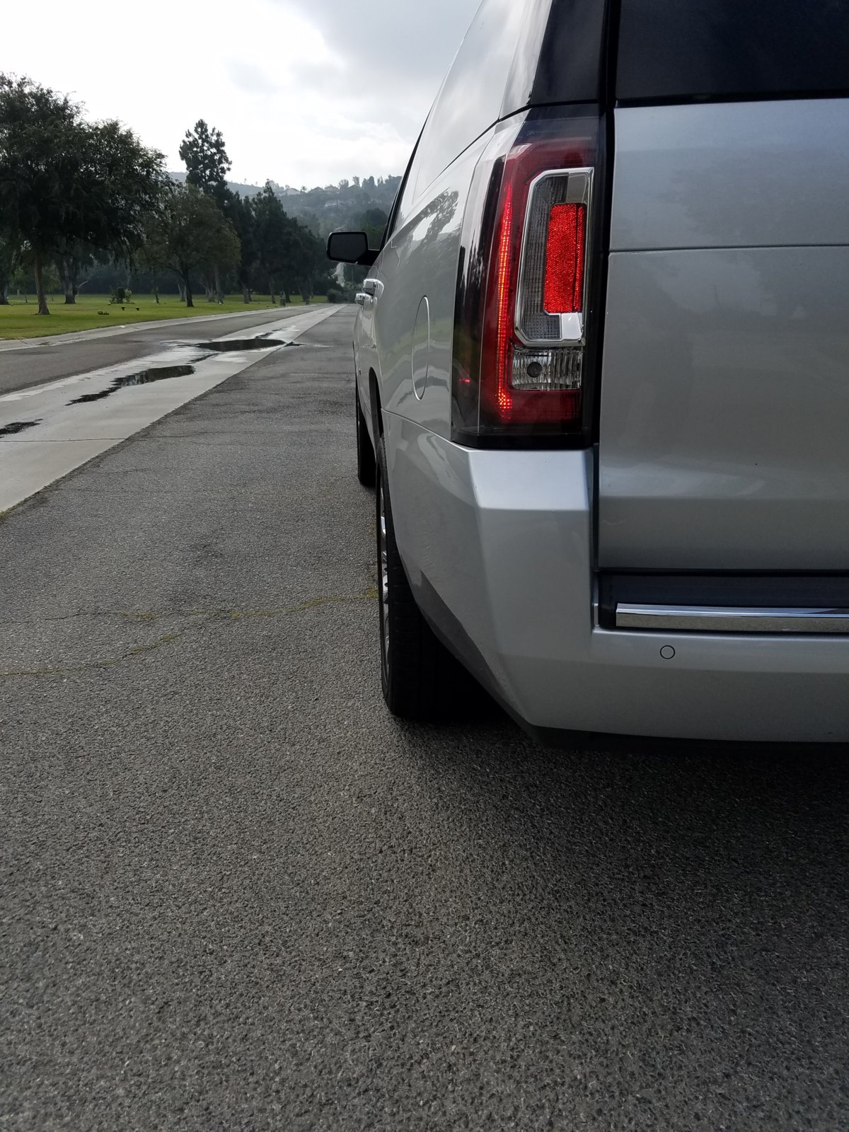

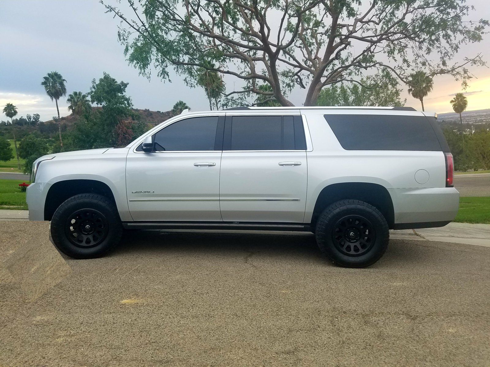

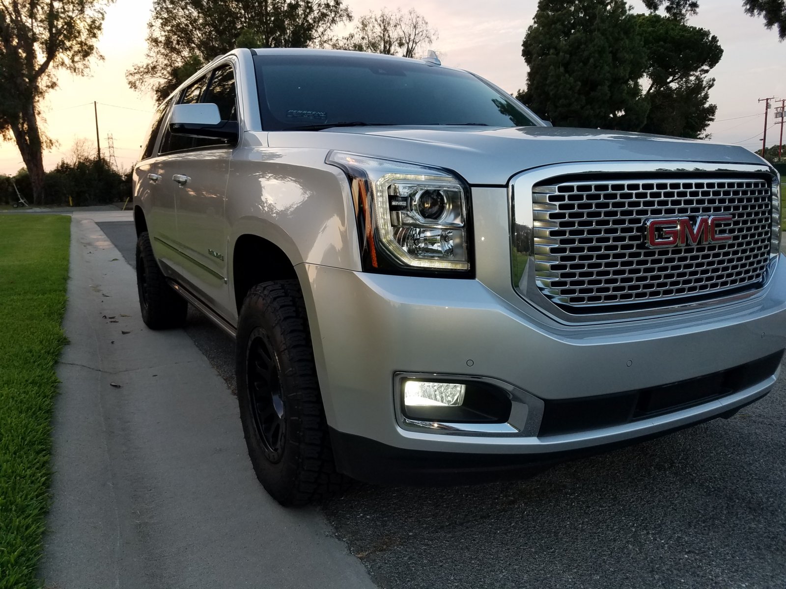

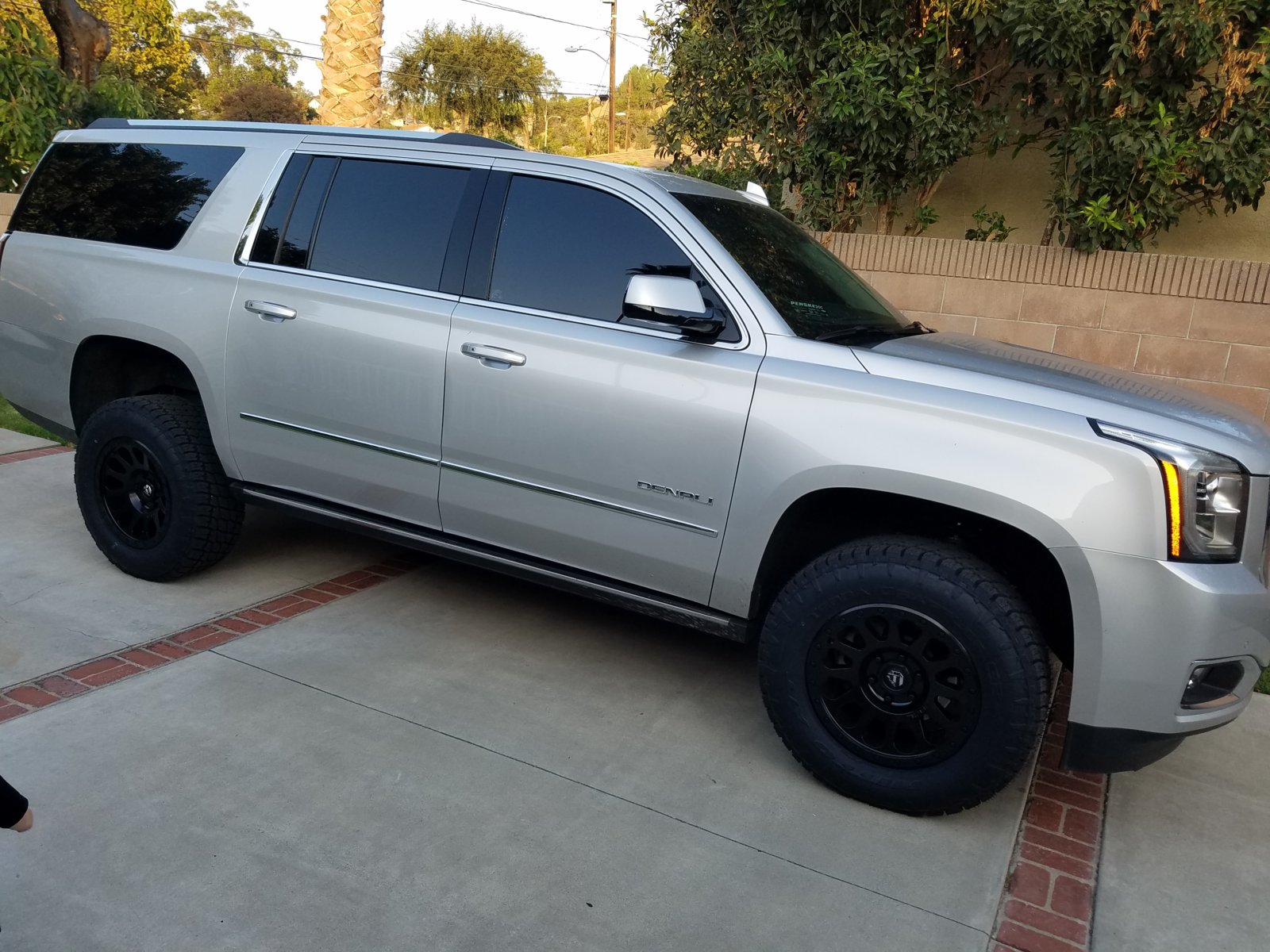

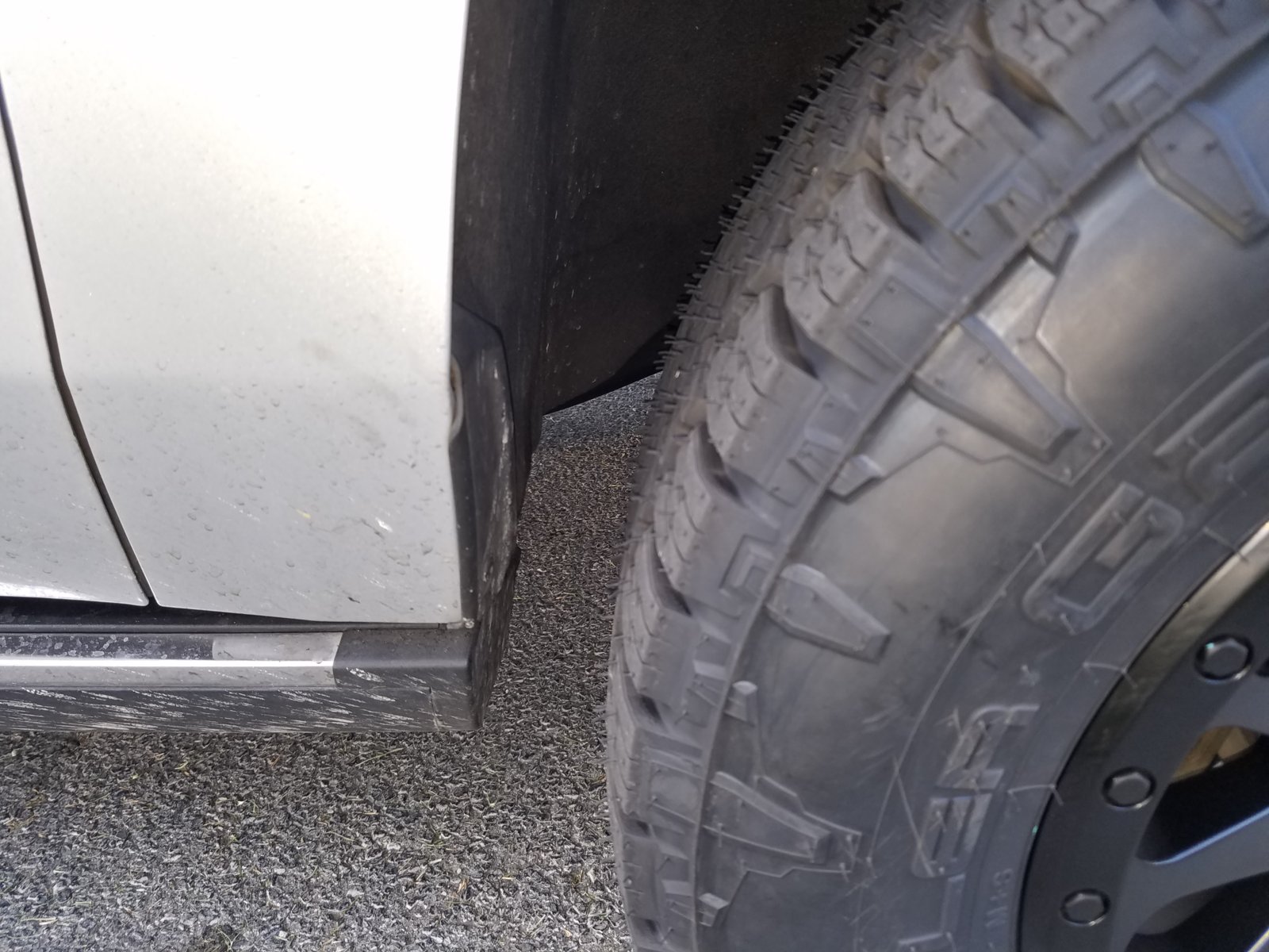

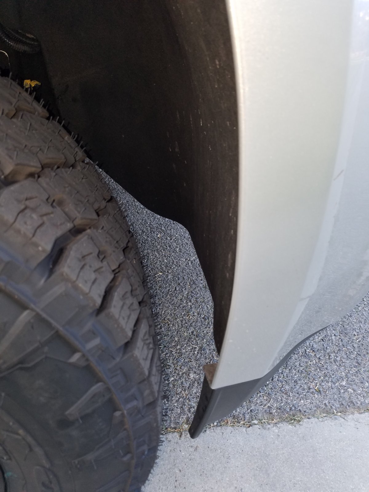

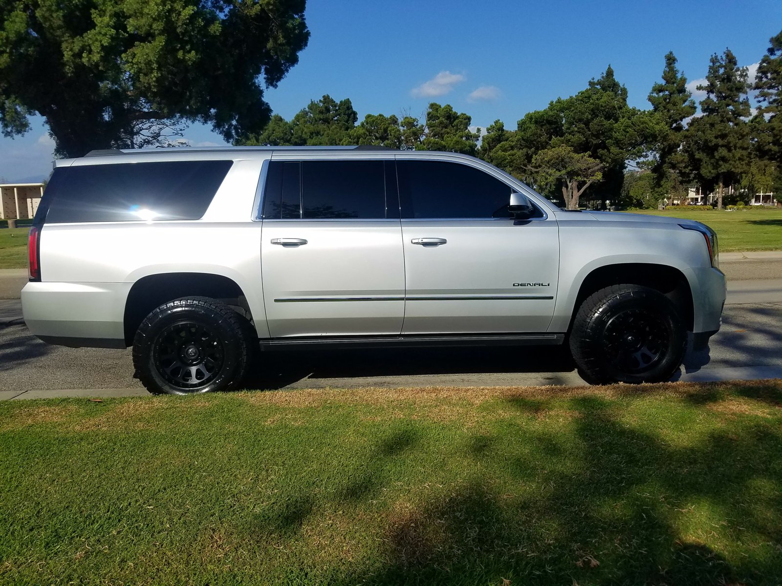

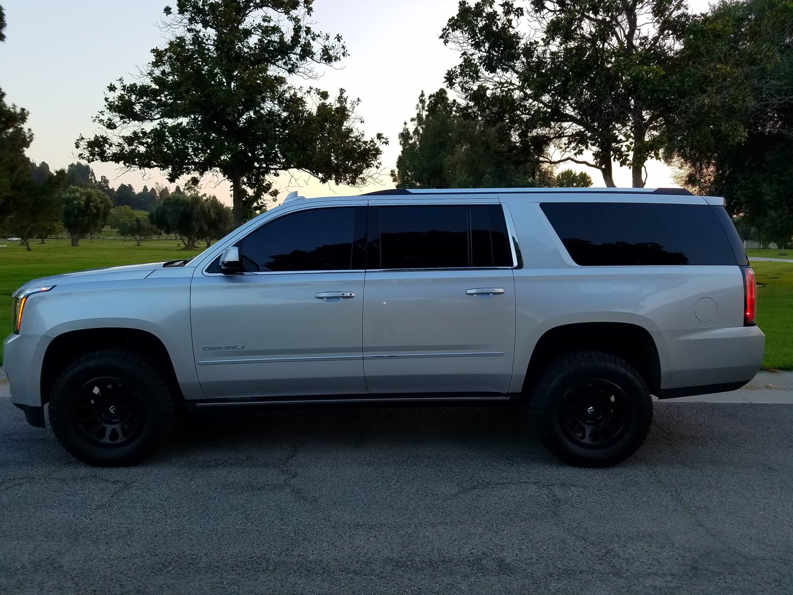

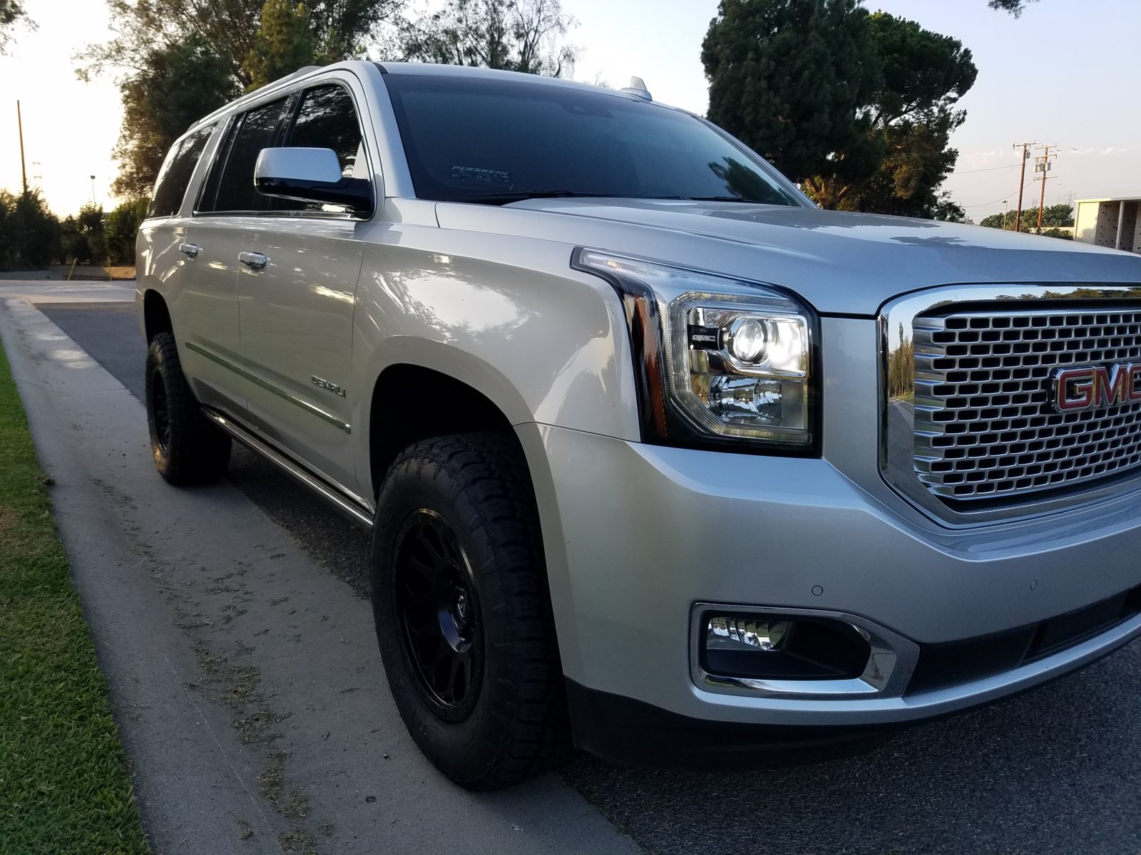

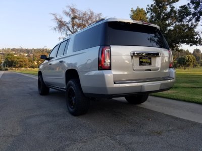

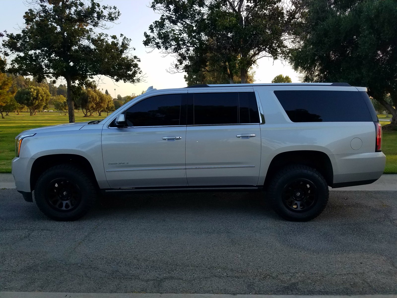

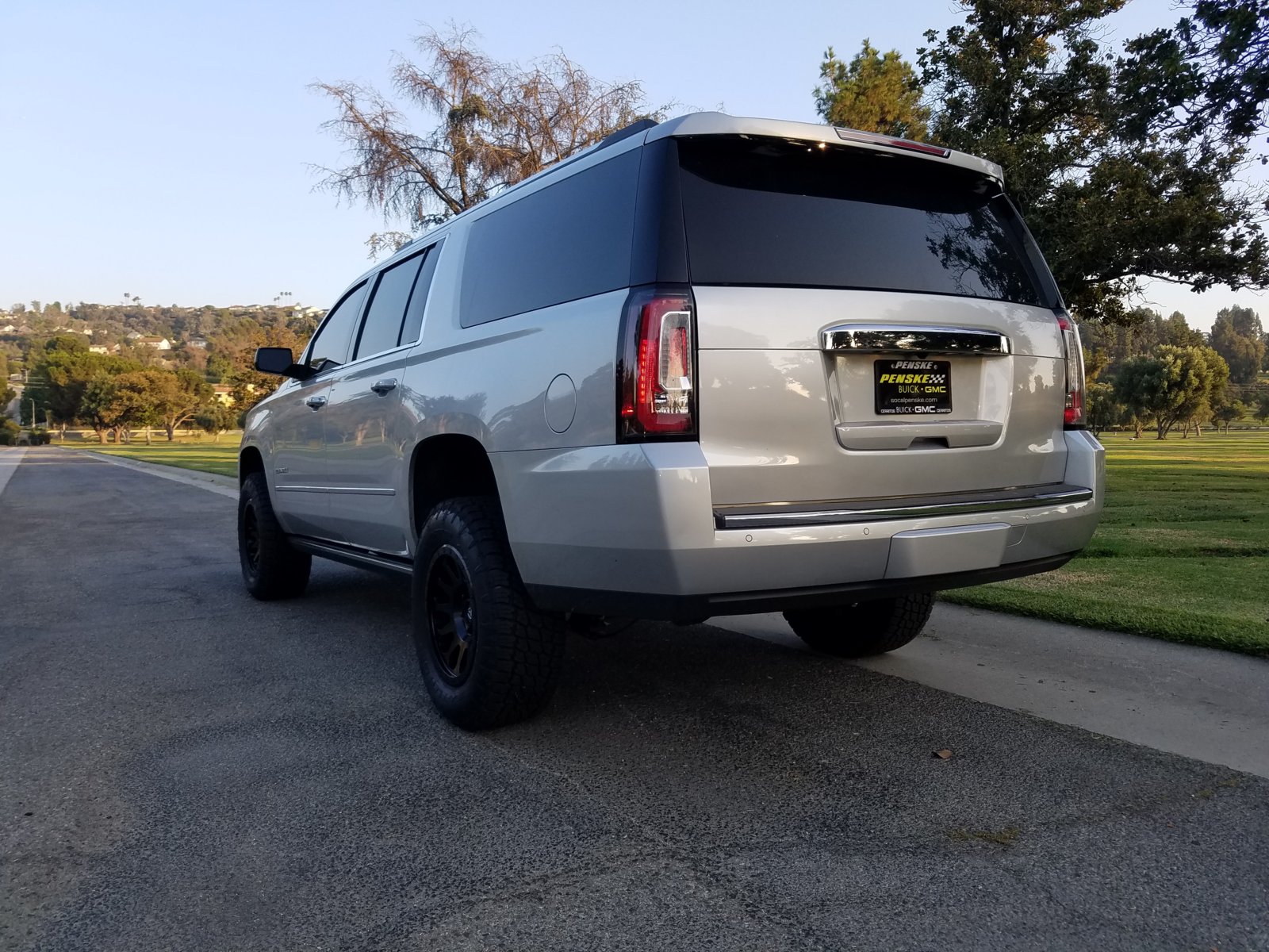

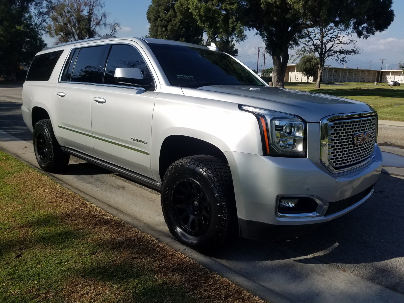

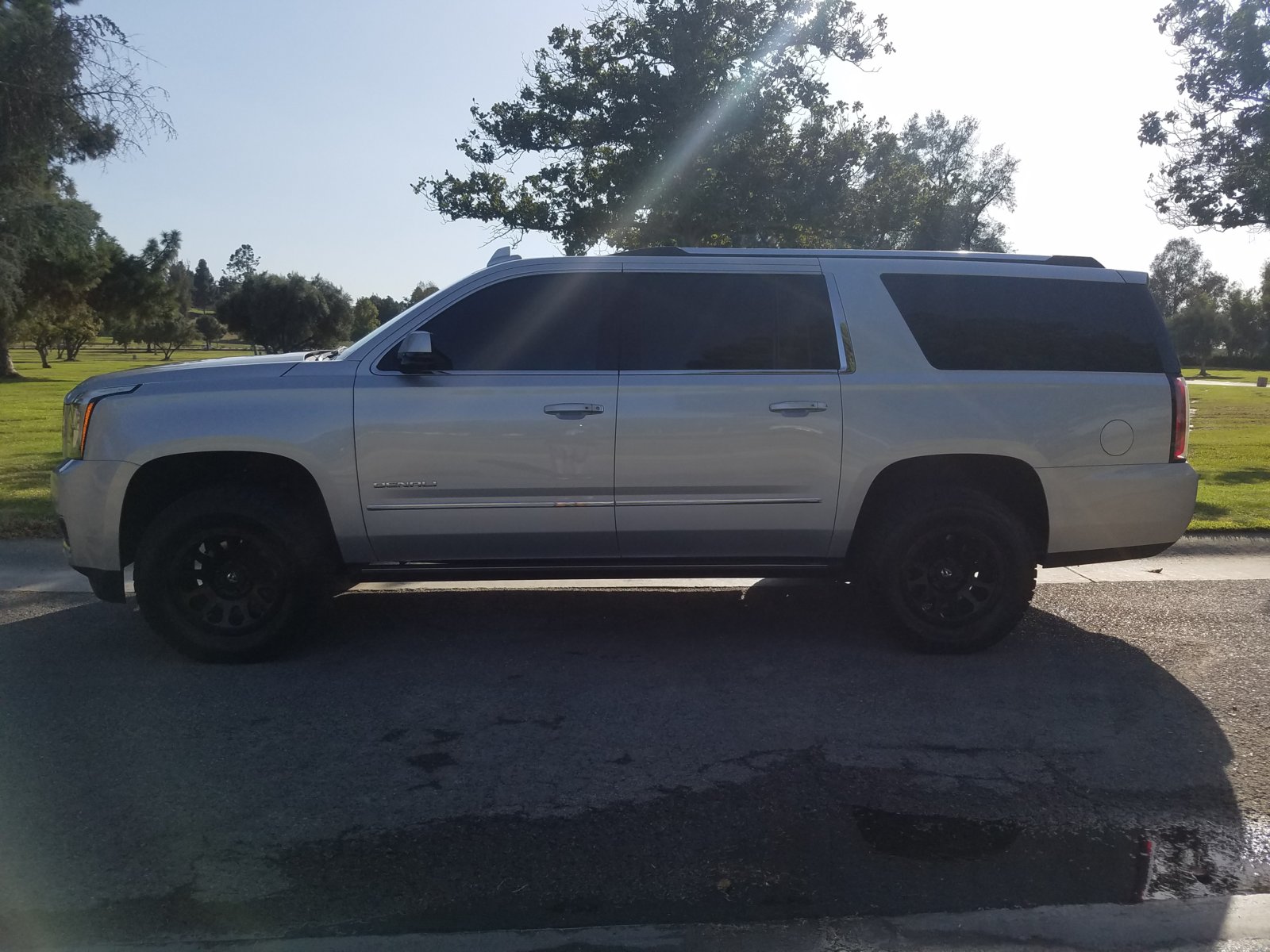

Not real happy idk why the rear end is so damn high it's suppose to be leveled but the ride is fantastic smooth a little noise with tires but nothing outrageous. The tires are nitto g2 285 65 18 absolutely no trimming or rubbing even the 4 wheel parts shop was amazed there was no rubbing. the wheel is a fuel vector 18 x9 5bs 1mm offset

I have no idea why the rear is so high going to call fabtech on Monday see what they think ..... it should be level

update since this original post I have went to a 2inch spacers in the rear not the 3 inch that came with the lift because as you can see from the above photos it was to damn high I currently have 2.25 higher "2inch spacer " in the rear i cant stand it I called fabtech and they are sending me a 1inch shorter spacer for the rear so I will have a end product of just about over 1 inch rake that will be nearly leveled. by the way to anybody looking for a 4inch lift keeping looking I have a true 3 inch lift all said and done fabtech even told me that do not even have a true 4 inch lift for my 2016 yukon xl denali 4wd it's a 3inch and there 6inch lift is really a 7.5 inch lift can you believe that so I was never going to get a true 4 inch lift i ended up with a fancy leaving kit. i will post pictures once my yukon has a.smaller spacer in the rear.
