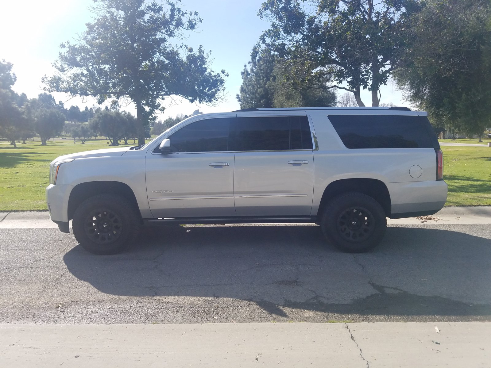

Or you could just go with a 2.5 inch supermax strut spacer for the front and a supermaxx rear spacer for the rear for a slight lift much cheaper than what I did but not as tall.

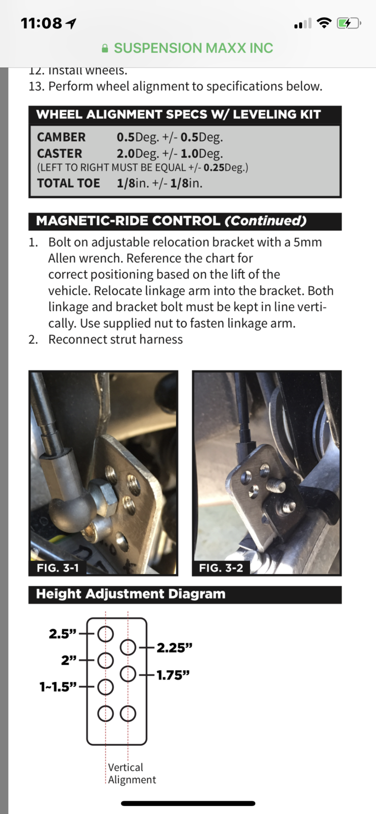

call supermaxx and ask for john to sell you the relocation bracket because normally you have to buy the whole kit just to get the bracket but John might be able just to sell you the bracket at a lower price buy itself

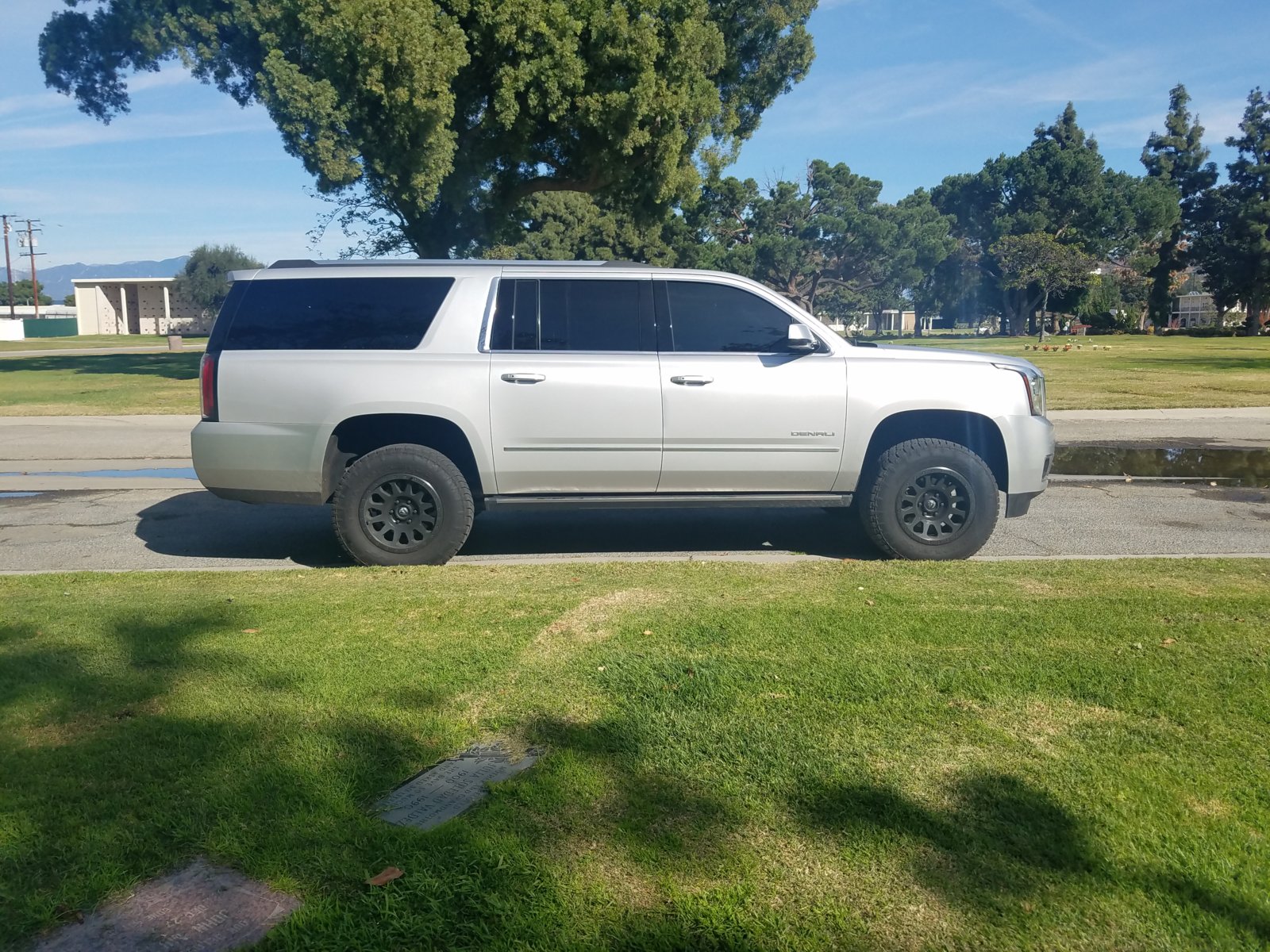

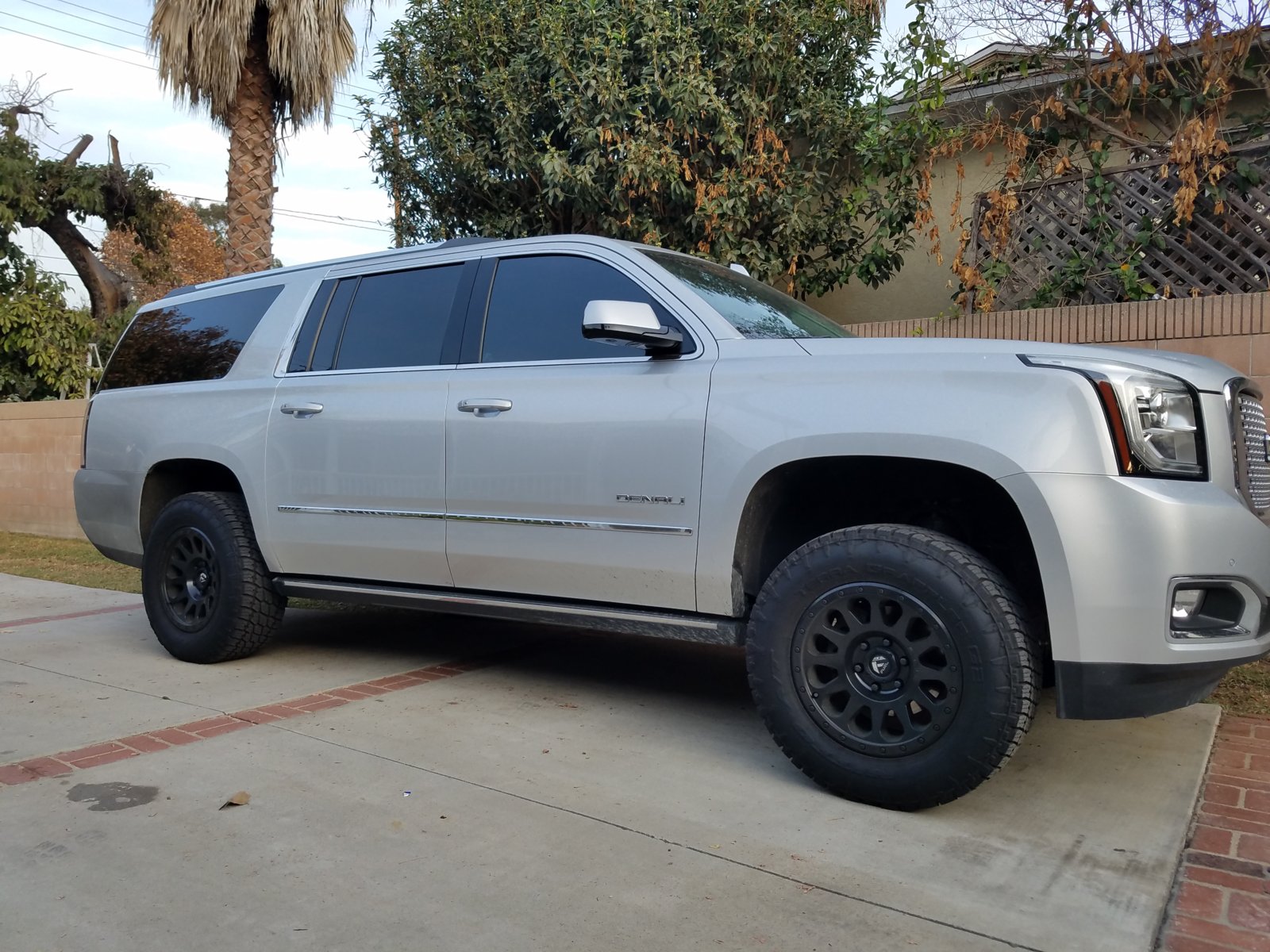

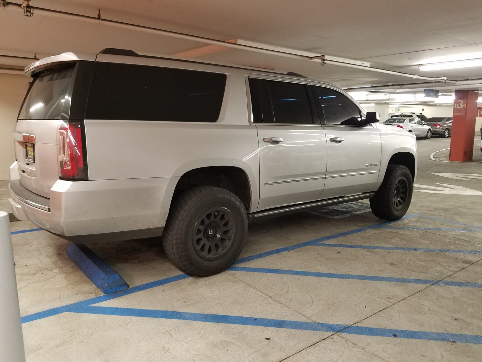

Man sorry it took forever! Here are the pics of my UCA
Thanks for the reply I'm kind of surprised you don't have a extension for Magnetic Ride sensor but hey it works
Joshb0718
Sep 18, 2016
51
21
Yeah idk all the details exactly on it but it rides level on the dash off road screen and doesn’t throw any codes, ride is still smooth!
cbraga
Dec 29, 2009
64
48

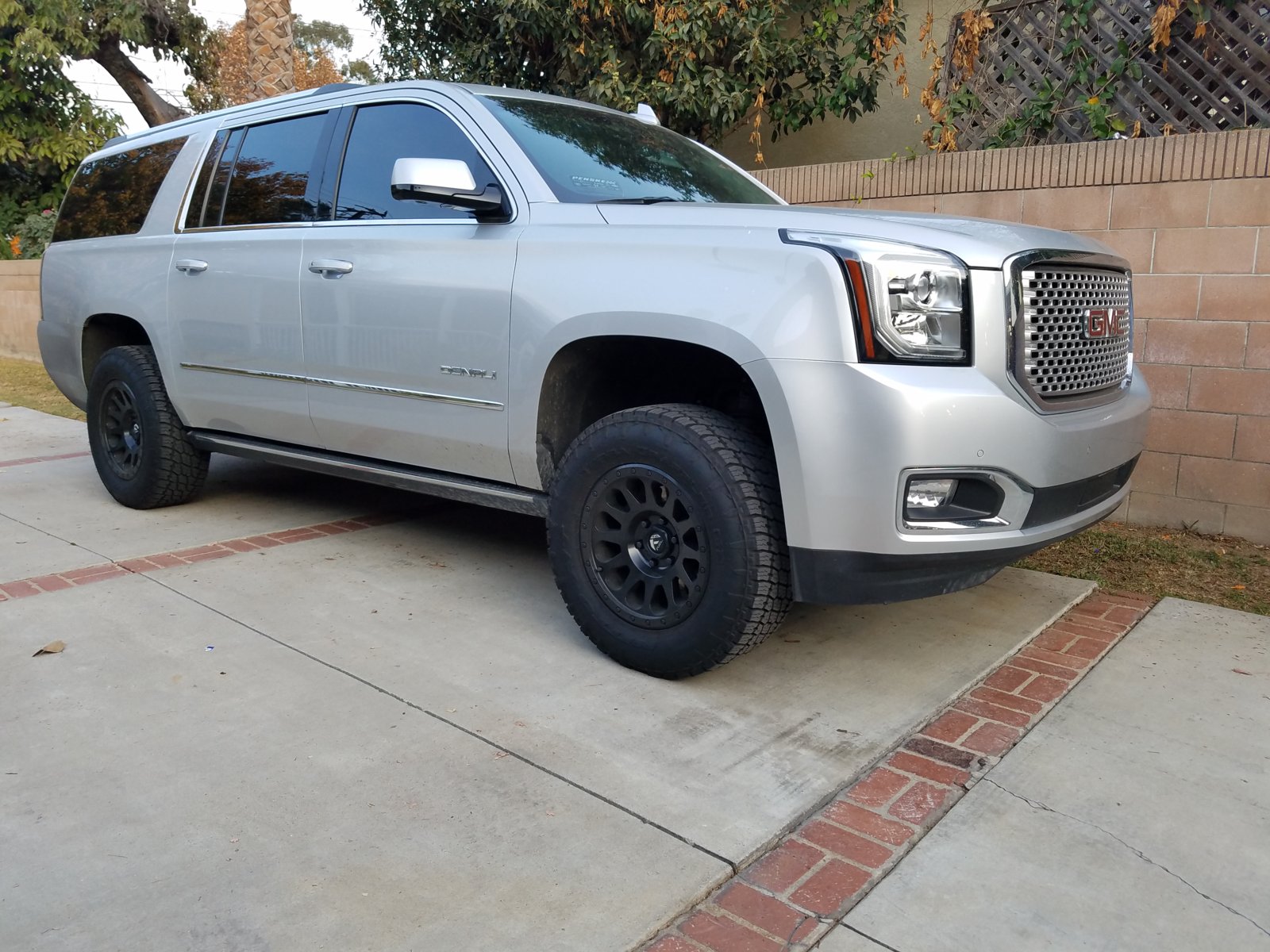

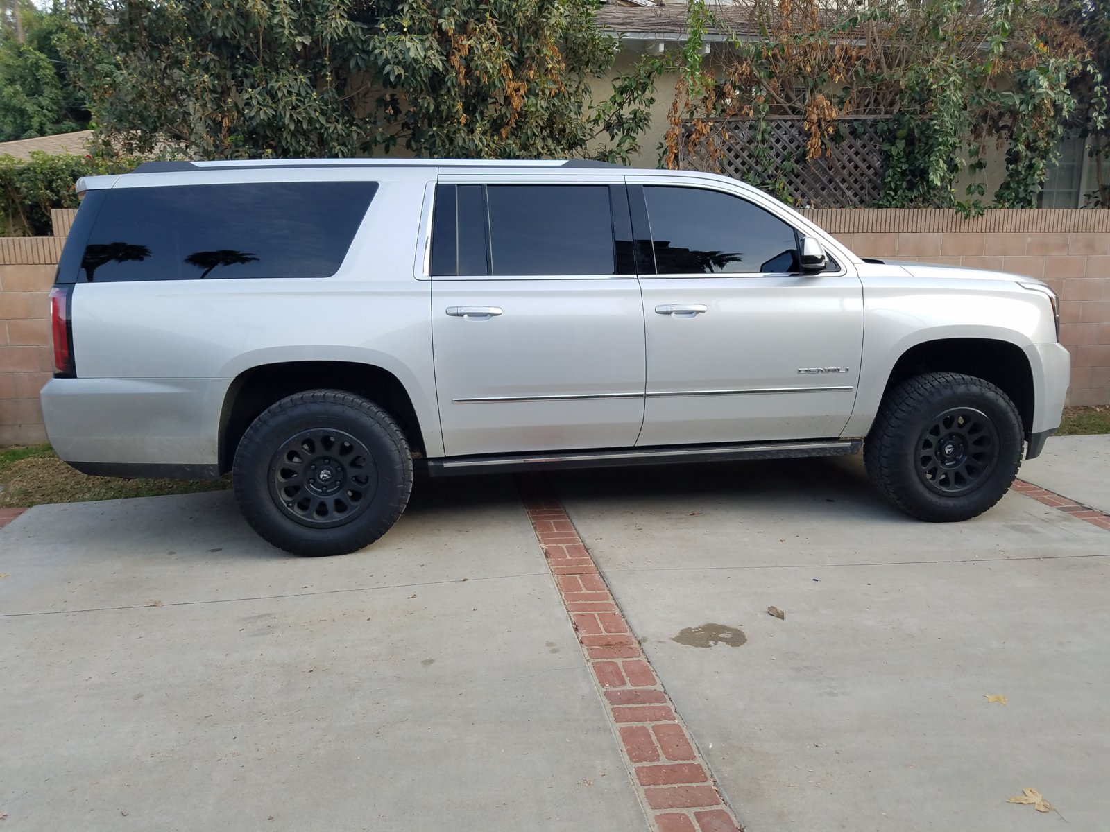

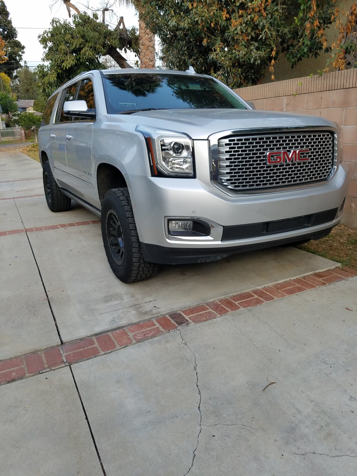

update since this original post I have went to a 2inch spacers in the rear not the 3 inch that came with the lift because as you can see from the above photos it was to damn high I currently have 2.25 higher "2inch spacer " in the rear i cant stand it I called fabtech and they are sending me a 1inch shorter spacer for the rear so I will have a end product of just about over 1 inch rake that will be nearly leveled. by the way to anybody looking for a 4inch lift keeping looking I have a true 3 inch lift all said and done fabtech even told me that do not even have a true 4 inch lift for my 2016 yukon xl denali 4wd it's a 3inch and there 6inch lift is really a 7.5 inch lift can you believe that so I was never going to get a true 4 inch lift i ended up with a fancy leaving kit. i will post pictures once my yukon has a.smaller spacer in the rear.

I will be using a Fabtech 2-inch spacer with supermax suspension relocation bracket for the autoride I will have it installed this Saturday and post pictures up shortly after

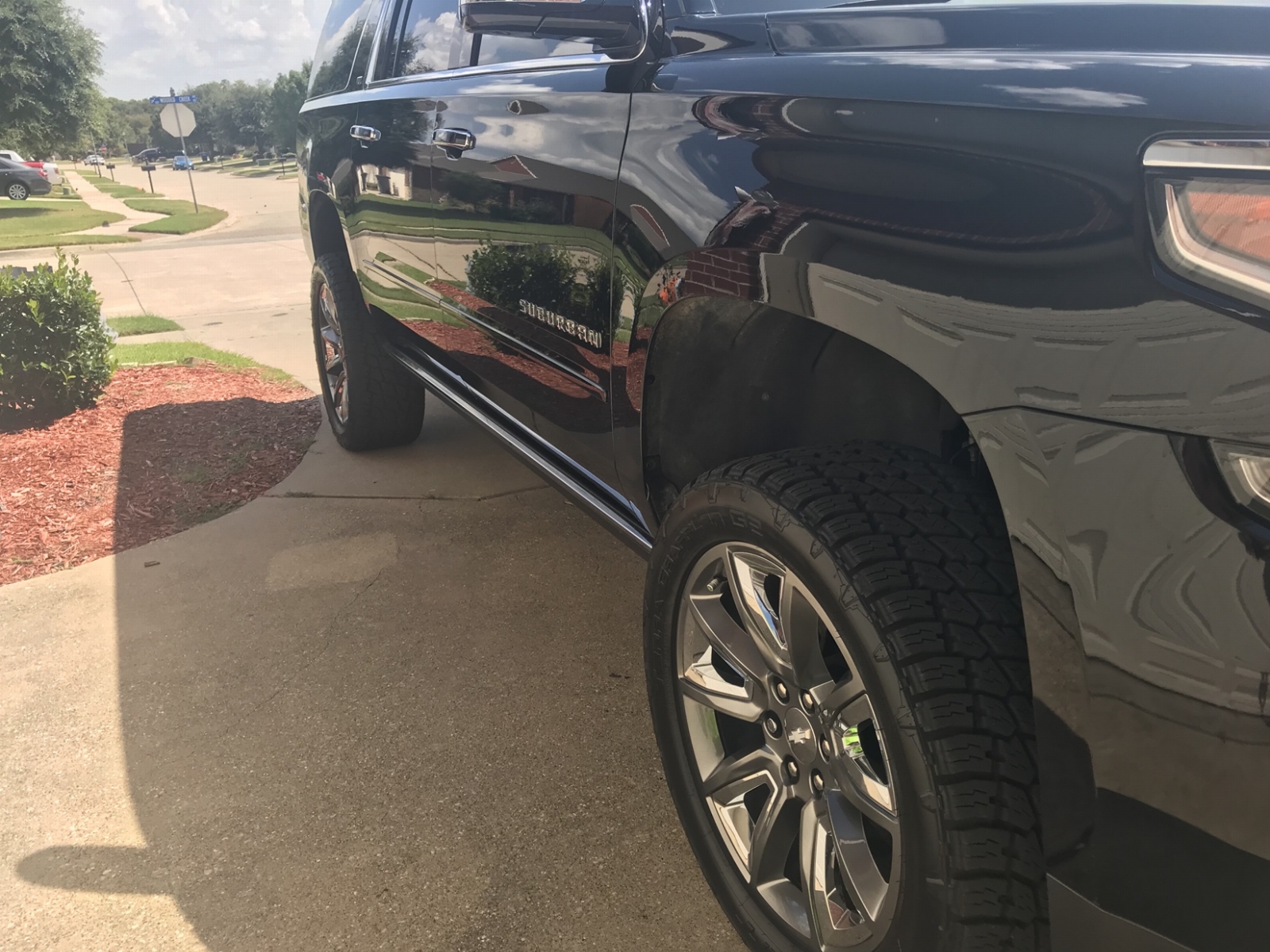

Just got mine done yesterday. Fabtech 4" kit, with a 1" spacer in the front under the strut, 1" suspensionmaxx rear spacer. 285/50R22 Nitto grapplers on OEM 22's. Rubbed on the steps, ordered amps to fix that. Also rubbed on the rear of the front fender when turning sharp, took the grinder and hammer out for that. Think I'm going to swap for the 1.5" front spacer. Its my wife's mall wagon so not concerned on the angles. I have a 1.5" suspensionmaxx fro the rear also.
