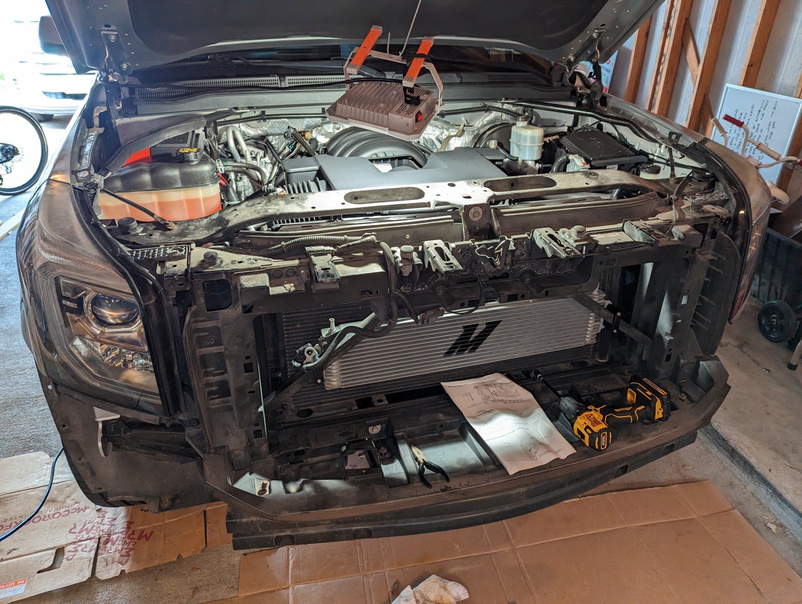

Hi all,
I just purchased a used 2016 Yukon with 40k miles and HD tow package to be able to pull an 7500 GVWR RV trailer.
Due to all the "transmission failure" complaints here, I am worried about the transmission reliability on long trips and if it would be a good idea to upgrade the torque converter, or any specific components for heavy duty tow applications to avoid a catastrophic failure that would require a whole transmission swap.
I've weighed in to ensure it's well below the GVWR of the tow vehicle axles etc. It has no issues towing and performs very well.
I've also installed a Mishimoto transmission oil cooler and performed the Thermal Bypass Valve SB below and the transmission oil never goes above 190F even towing long distances or in stop and go traffic.
Here are some Performance Upgrades that look promising, but I don't know what I'm looking at. If anyone can advise on exactly what parts are known to fail and the best cost benefit or best preventative measure would be, if any at all, please advise.
Upgrades performed thus far:
1. Cooler valve Thermal Bypass Valve service bulletin
Service Bulletin INFORMATION
w/ part number 86774933
2. Mishimoto Transmission Oil Cooler:
MMTC-K2-14
3. Range Technologies AFM disabler
Thanks in advance!

Thanks for the response and warm welcome! I did see your post and could not sleep for a few nights....and didn't want to jack your thread, so I thought I'd start another thread on preventative measures. @NickTransmissions had some very valuable information in there about what you should expect in your rebuild. I've seen some other references to upgraded hydraulic pump, and deeper trans oil pan, so in light of that I'm wondering what should be done in advance for the 6L80.
The trailer actually weighs only 5100lbs empty and I try not to load it up, I believe the max weight rating is the 7500. I've done the CAT scale weight and done the online tow calculator to ensure the axles and combined vehicle weight aren't over their Gross weight rating.
What is the target trans oil temperature range? I couldn't find anything on bobistheoilguy about this.The aftermarket cooler holds about a quart of fluid, I've attached a picture for size reference. Should I install a deeper trans oil pan? Would that help lower the temperature due to higher fluid volume?
