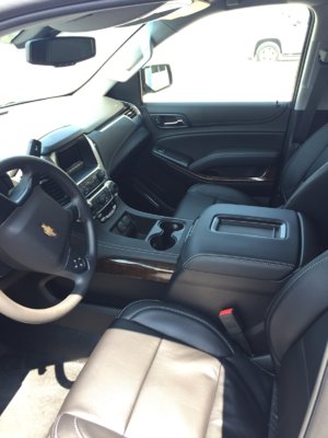

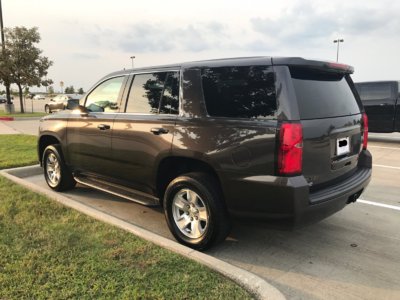

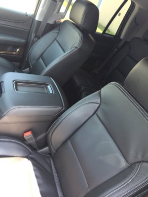

I have some questions hopefully someone can help me out with. Last year I purchased a 2016 Chevy Tahoe Police Package brand new. They come with a pursuit suspension package and its a pretty rough ride. You feel every bump because the suspension is real tight and it sits lower to the ground. Im curious how hard it would be to change out the suspension to just a regular stock ride suspension. Also what parts would need to be swapped out and around how much would it cost. Ill attach a few photos of the Tahoe, I've since swapped out the 17 inch wheels to some stock 20 inch chevy wheels. Thanks for any help.
