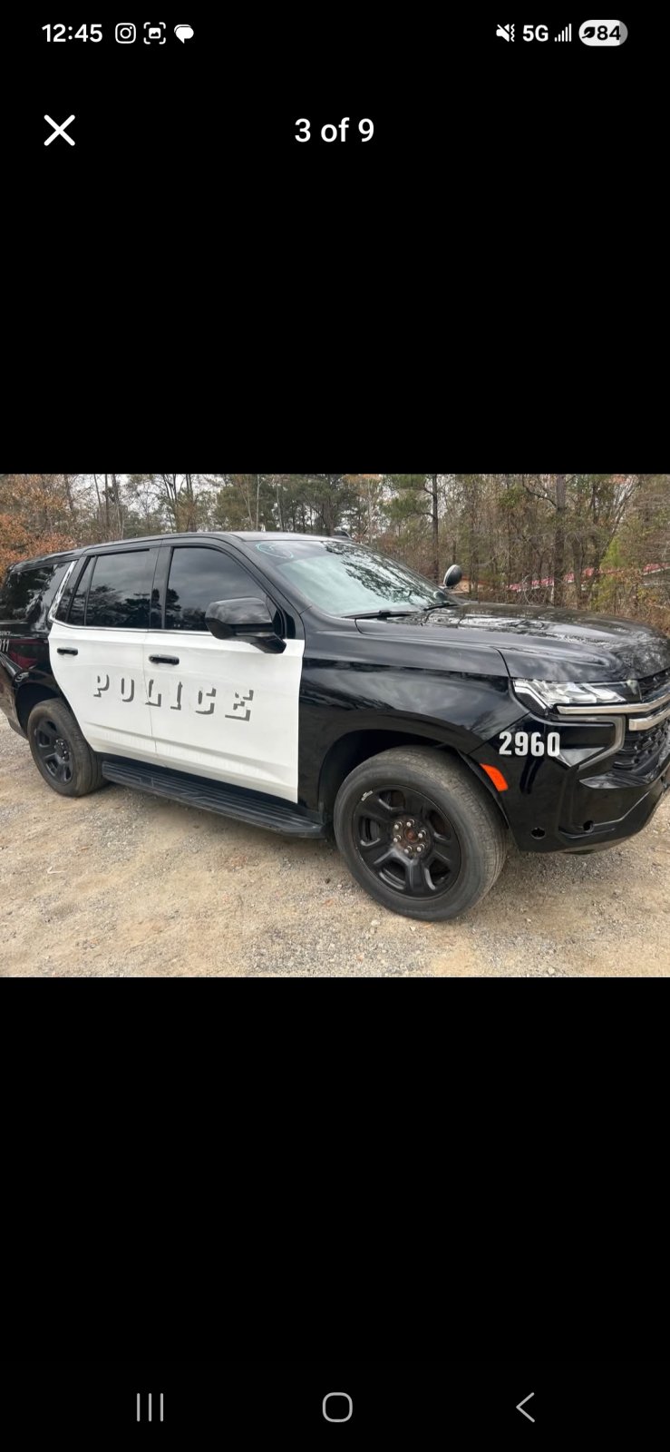

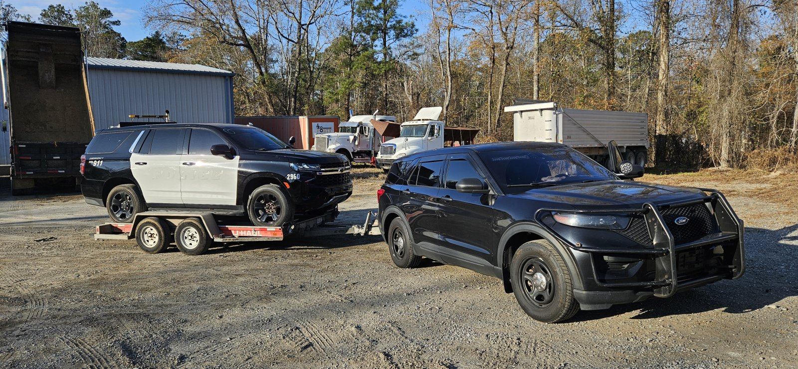

Hey guys and gals,
I have a 2022 Chevy Tahoe Police I picked up recently. Looking for any advice or recommendations on things I should do and look out for with it. I've had silverados before and am aware of the transmission and AFM problems these vehicles are notorious for. Anything I can do now to keep the longevity of this? It has 45k miles on it. Is the DFM disabler from Range Tech. worth it?
I also seen someone tried replacing the 8 inch touch screen with a 10 inch. Im assuming you probably need to upgrade the APIM to utilize the 10 inch and reprogram to your vin to avoid the theft system from activating.
Im also assuming there's no remote start with these? Kind of shocking cause I have a 2021 explorer police interceptor that has just about every basic new model vehicle feature.
Kind of surprised with the lack of features chevy has with these base model vehicles.

Welcome to the Forum from NH.
Take the truck to a local trusted auto repair shop and have it COMPLETELY inspected. Fix anything that appears in the inspection. PPV's are generally well maintained, so you may not find anything significant.
Change ALL fluids - coolant, brake, front and rear differentials, transmission. Then, you have a baseline that you know is valid, fluids-wise.
Disable the DFM with any quality available device.
Once the above essential items are complete, then you can start to think about discretionary/comfort/cool features/mods to add to the truck.

Those are highly desirable. Daytime Running Lights disabled. Engine Stop-Start disabled. I'm jealous.
